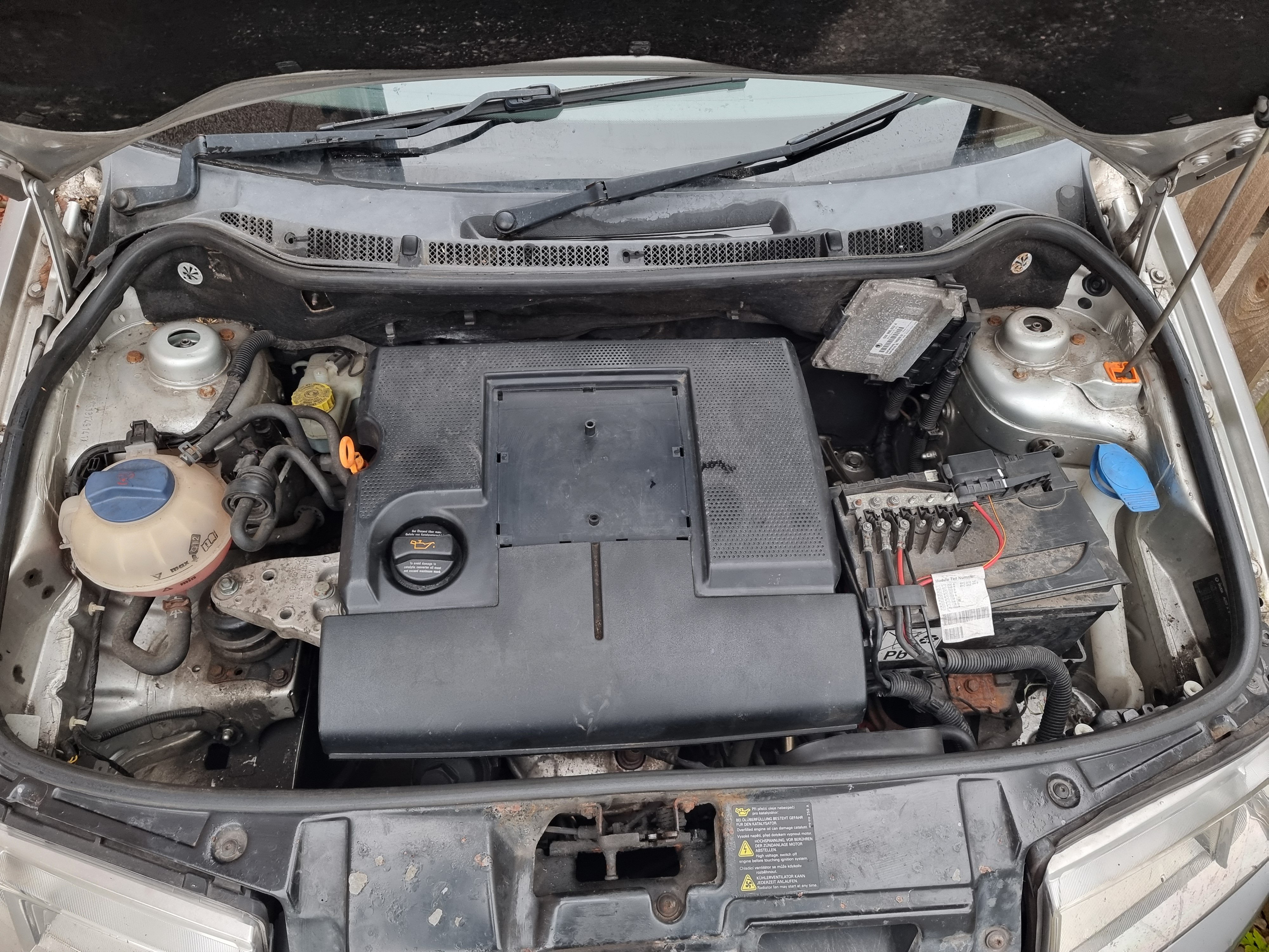

So I have a fault code - P0171.
I've been told it's a maf/map sensor.
Where the hell Is it? 😂
Thanks In advance. 20240625_203543.thumb.jpg.bbc791fd586f85f6fbf297e569d5c9b8.jpg

Very unlikely  to be the sensor itself, more likely an air leak. Check brake servo vac hose as a first suspect. Often crack at the junctions of the hard plastic sections. Look and feel for such damage.
MAP sensor is on end of intake manifold near dipstick tube.
Some interesting absences from your battery-top fuseholder. 🤨

The protective cover for the terminals on the fuse board - you really do not want to drop any metal object across those.

Brake servo is the round black thing on the back wall of the engine bay, behind the brake fluid reservoir.
The only hose coming from that to the engine is the brake servo vacuum hose.
I was referring to a couple of strip fuses as being mysteriously absent from the fusebox.
ABS pump fuse and one for radiator fans, I think.

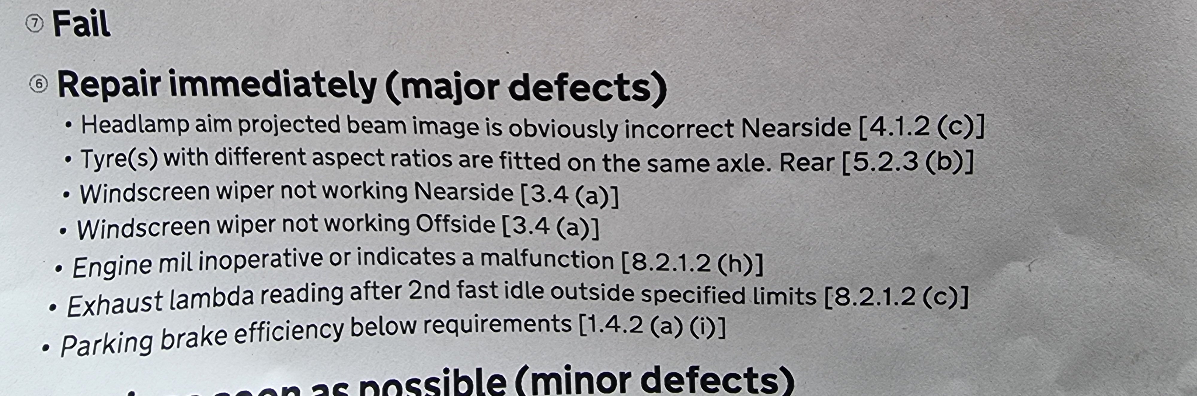

Just mot'd it and this is what it failed on20240625_172716.thumb.jpg.55417d8cd5bed76f8cf949188b2fe196.jpg

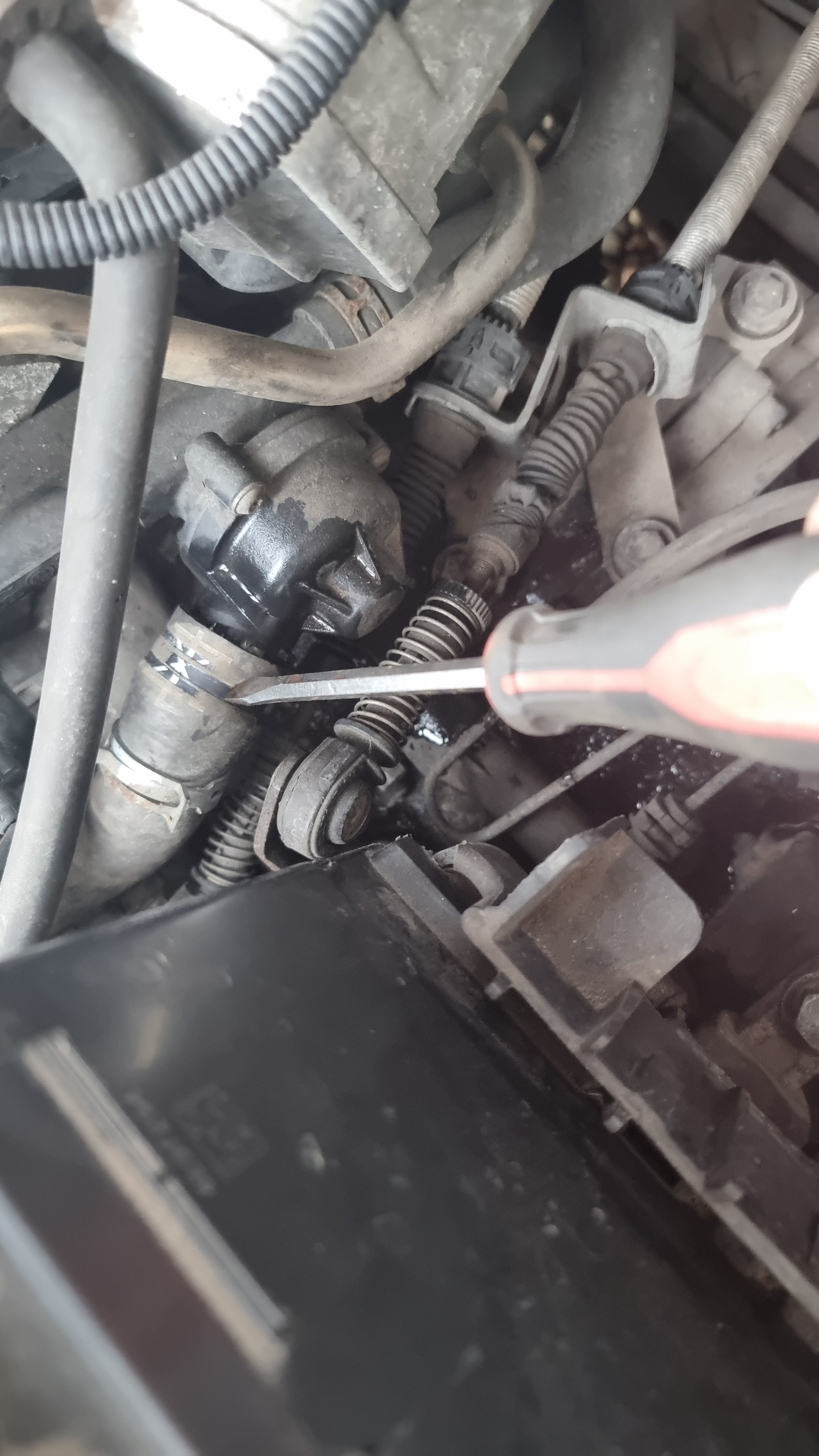

Is this this brake servo hose? If so, why is it full of coolant? I want to take it off to make sure it has no splits... that being said, if it hasn't leaked coolant, surely there's no splits?
Brake servo uses vacuum not coolant!

No splits in brake servo hose ( yes I found it behind the brake fluid reservoir lol). However I don't think the hose sits very well in the brake servo. I don't know how easy it should be to pull the hose out of the brake servo but it pulls out very easily.

It should be quite difficult to remove from servo, unless you deplete the vacuum by pumping brake pedal a few times first. Suggests the one-way valve may have failed, possibly?

One way valve is part of the servo vacuum hose, near the engine end of it.
With engine cover off, it should be easy to see the entire hose end to end.
