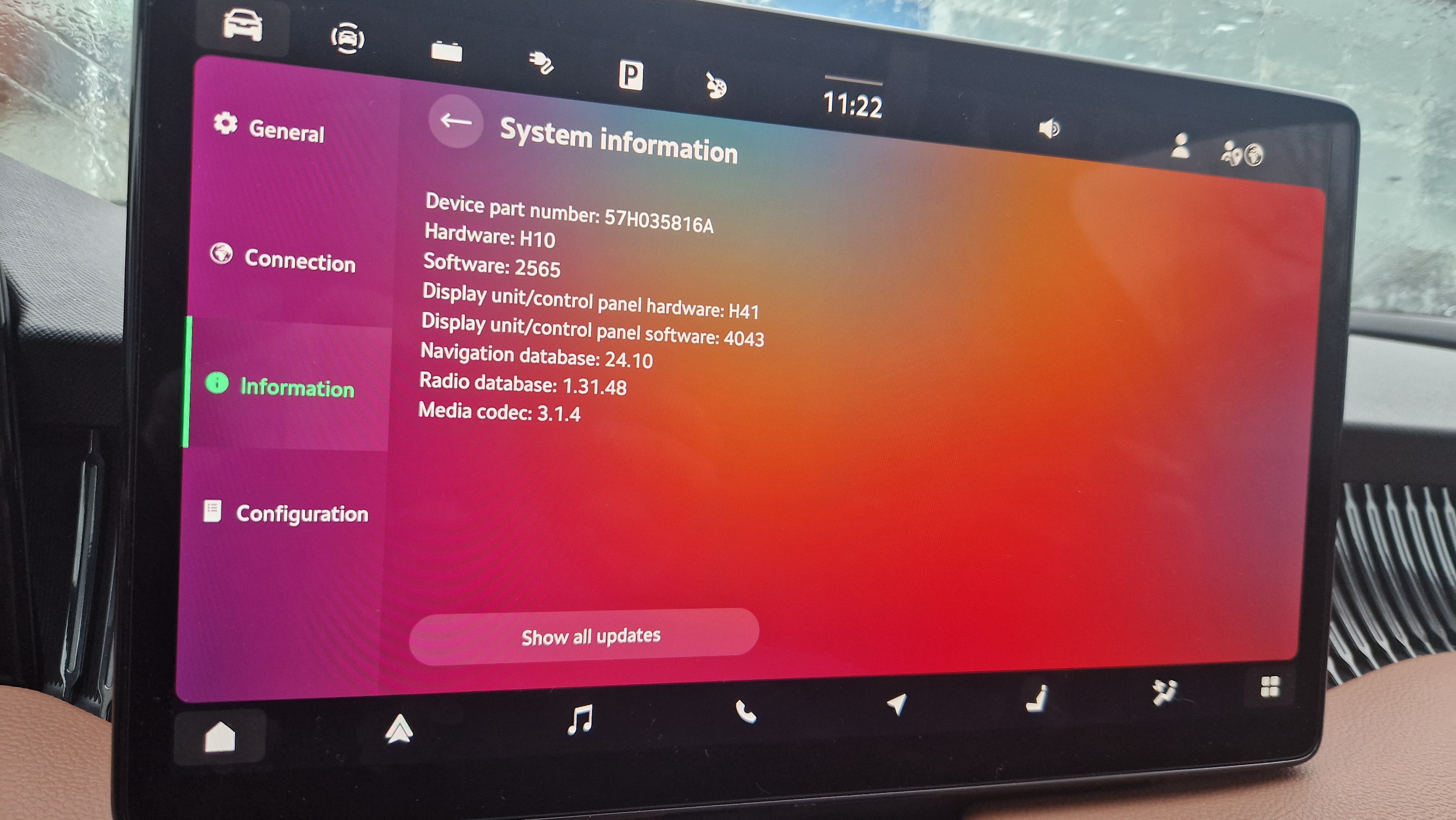

My car was on 2565 when I received it from the dealership new, 2 weeks ago, which would confirm the dealership had done the update before handing it over to me. But that also would show that the software update is not the fix for the 'assist system' errors, as my car displayed these errors despite being on the latest software.
Can anyone confirm a pre/post update version for the software they are on?

Dealership now ready. I asked them whether the software version I am on, which is 2565, is the latest December 2 update, that should fix the 'assist systems' errors.
The dealership was not able to tell me for sure whether 2565 is the latest version of the software.

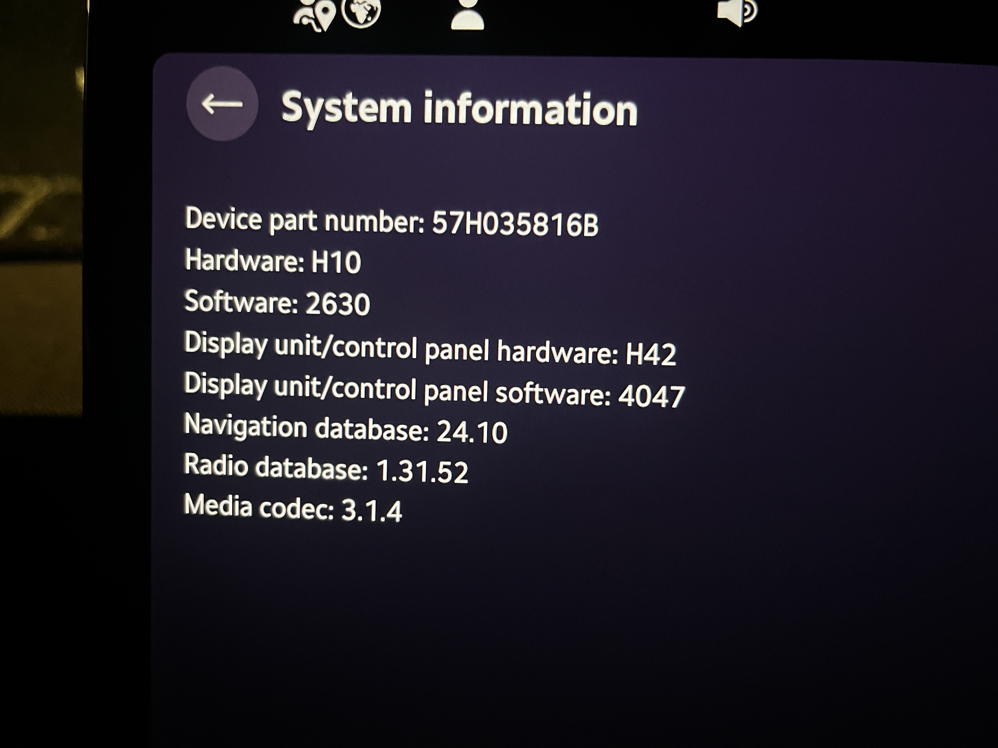

Collected today, here are the system detailsimage.thumb.jpeg.5f468cbcc362b989b64ecfaba04348b1.jpeg
Edited by Old_Dave
words in wrong place
Thanks! So latest software looks to be 2630.
Another collection today with the same data except the Navigation database. So far all is working.
