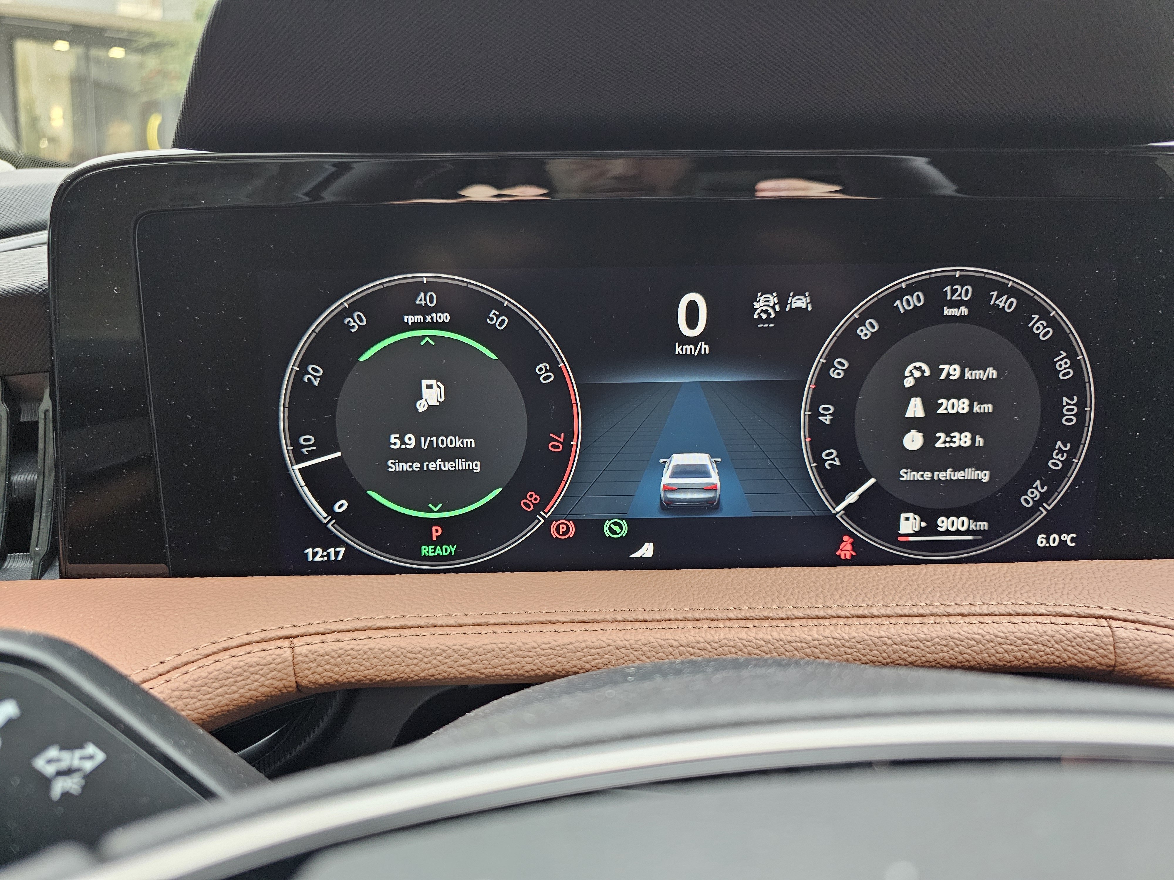

6 minutes ago, DanHague said:
Hmm, strange indeed. Sorry, don't know what is causing that.
I think you cannot change it there, you have to get to the view where in the middle of the virtual cockpit these consumption data is displayed, use the right scroll wheel there and select the one you want and then go back to your preferred view
Thank you!!! I had checked every option but did not think that view was scrollable. That is some weird interface choice from Skoda. Also no mention of it in the manual. Anyway, thank you again, it was driving me crazy :)

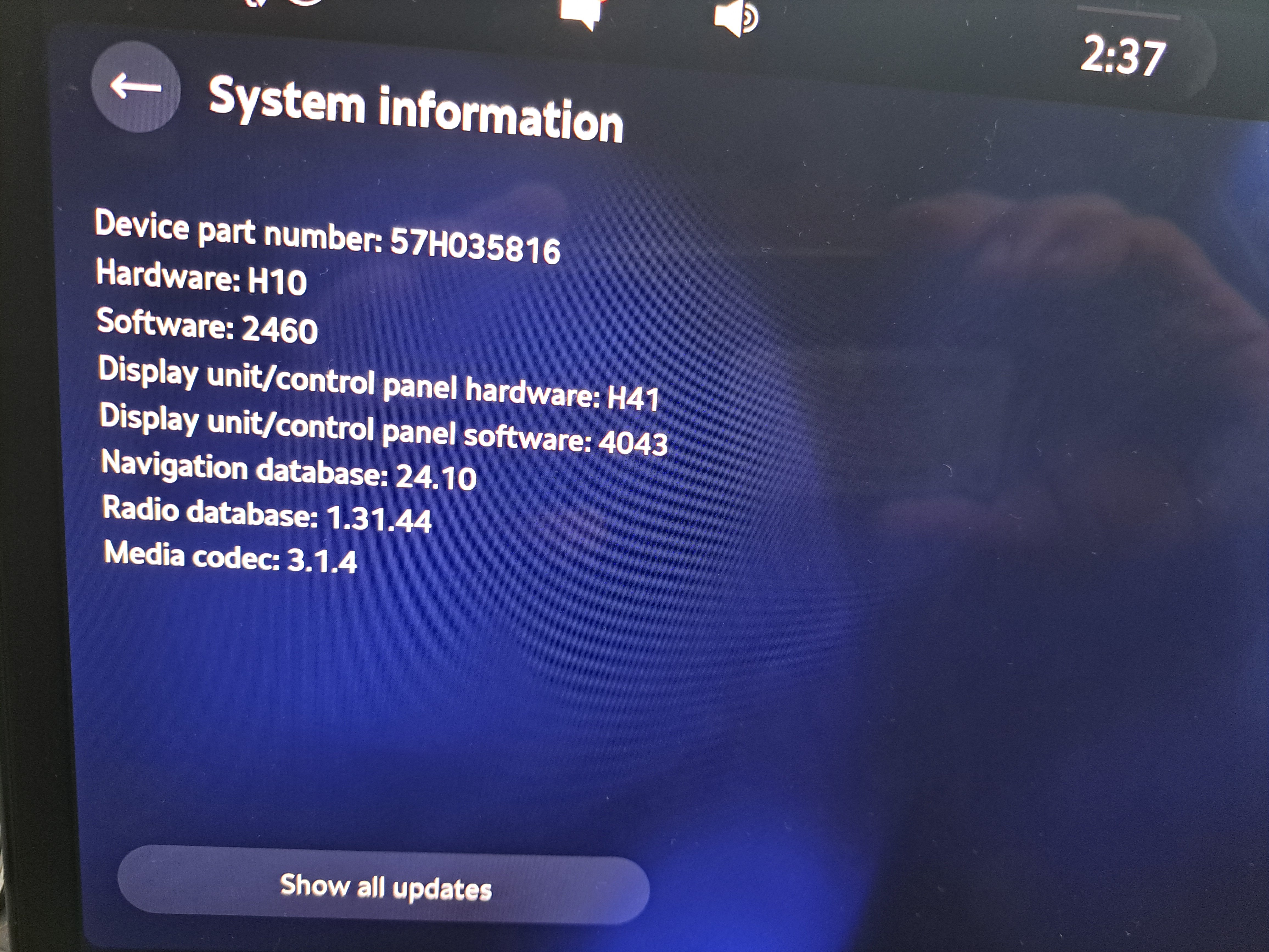

Last month, I received a message from the dealer asking me to go to the service center for a software update. I plan to go this month, but I have a question and would like to get more details.
I noticed that those who have already gone to the dealer for the update did not get the infotainment system updated. Specifically, they still have version 2460.
What bothers me the most is that when I use CarPlay and adjust the climate controls or driving modes, the screen goes black. This issue has been resolved starting with version 2565.
My car was manufactured at the end of August, and I’ve driven 9,000 km so far. I’m very satisfied with the car and haven’t had any problems until now. However, a few times, the dashboard assistant lights turned on but quickly went off. In recent days, the Kessy system has been working intermittently. Specifically, the doors lock when I touch the handles, but they don’t unlock. This might be because the car was quite dirty.
So, is there anyone with a car manufactured before August who has version 2460 and went to the service center for an update? Did they get upgraded to a newer version?
Edited by Rigor
Below is my system Information,  I picked my car up in July and had multiple problems.  Since update car seems to be OK. Only 2 weeks so a lot can still go wrong
Yes, that’s exactly what I was saying: the infotainment software remained the same, and they didn’t update it. I don’t understand why…
Cars manufactured from September onwards come with version 2565 or newer, and, as shown in the attached picture, the black screen issue has been resolved.
