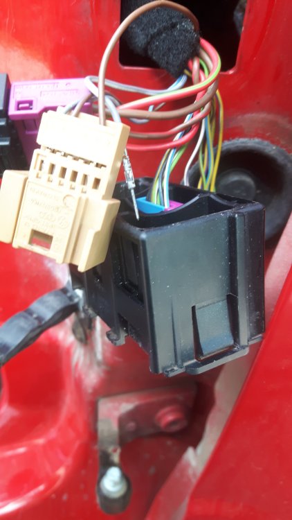

  19. Item 100 here, I think (on the right side anyway) LLLParts Other side on this page: LLLParts, same conn. The three pin/wire sizes appear to be helpfully listed in the 'note' column.
  20. I even took pics, apparently. Different arrangement on the mk1 Fabia though, four separate male connectors within the overall black 'carrier', which - unlike yours - appears to itself have to be inserted from the outside. So on the Fabia it looks like the (4 individual) loom connectors get posted out through the hole, clipped into the back of the carrier and then that clipped into the hole from outside inwards.

  23. I would say they supplied the wrong door loom then. There are many options. I have done this. The best way to order the correct door loom is to use the number on the white label on your current door loom, that is the VW Part Number. To get to that you remove the elbow rest (screws), click off the door card, remove the plastic door liner (I just pulled mine back as much as I needed to access), drill the rivets off the speaker to remove that. Then it is pretty obvious and as said the part number will be on your current loom. I remember I was driving round for a couple of weeks with all that removed, using a pair of mole grips on the cable to open the door, while I waited for the replacement loom to turn up. You need 4 large pop-rivets when replacing the speaker.

    I think the answer is that the front door modules are data-connected to/by the convenience CANbus; but the rear door window modules are only connected by single wire LIN bus to their respective/same-side front door modules. So although the rear may have all its wiring intact, if its same-side companion front door module isn't operational, it won't get command info from anywhere central.
  27. 1 point
    Yes you're right. But what I couldn't/ haven't figured out is why the broken front door common earth stopped the rear N/S rear door functions working. I would have thought the doors would have had their own negative feed. Which is why I was looking for wiring diagrams when I 1st got into this. The two large + - feed wires go to the door control modules which both the front doors have. So they must also control the rear doors. I don't know if the rear doors also have control modules as I've not had the door cards YET! As I mentioned in your thread I know at least one of the rear doors has wires with cracked insulation. The Haynes online manual I bought has very little wiring information other than the locations of all the earthing points.

    Finally all the door functions for the nearside doors are now restored 😊 I've replaced a section of around 200mm of each of the cables even though not all of them were damaged I figured it was likely it might not be long before they did as the insulation was stiff and hard. After soldering the 29 amp earth and positive cables I decided not to use anymore heat shrink solder sleeve connectors at the plug end as they stiffen up the cables by increasing the insulation thickness which I didn't think was a good idea in the door hinge area where the cables are constantly flexing. So I soldered the remaining 14amp, 11amp and 7amp wires and used thinner heat shrink.
  41. 1 point
    I've still got the same issue with both N/S doors not working. Though have now found the earth cable to the N/S front door has broken. Can also see the positive cable insulation is cracked. I can understand why none of the door functions aren't working but why would that affect all the rear door functions? I've not checked the wiring for that door yet. It would be good to have sight of detailec wiring diagrams.

    That's about 240mm of each of the 13 cables replaced in the drivers door loom. The 2 N/S doors still have none of the functions working. So now on to the next door!

    Before I started I checked for error codes and found 4 one for each door. The 2 intermittent ones cleared and the 2 for the passenger doors remained.
  46. 1 point
    Thanks Gav, yes I've seen some of those posts already. Though maybe I haven't got the hang of the search function? As it never seems very easy to find hings I'm looking for? I can't believe only having one broken wire in the drivers door loom that I've lost all the functions on the N/S doors? So maybe there are more damaged wires? As DEL8OY has previously mentioned he's found broken wires where the insulation is still intact IIRC. I've now noticed that the insulation is quite brittle on most of the front door loom wires and found a crack in the insulation on one wire in the loom to the front N/S passenger door. The rear door wires are probably not far behind though guess that they are likely to last longer as I rarely have passengers so the wires aren't being made to flex as often. I'll buy several meters of the correct wire gauge and these type of connectors from this supplier who is local to me though aren't open till Monday otherwise I'd have gone today. https://www.vehiclewiringproducts.co.uk/c-60-terminals/c-205-heat-shrink-pre-insulated-terminals/p-510-red-heat-shrink-solder-butt-connector , https://www.vehiclewiringproducts.co.uk/c-60-terminals/c-205-heat-shrink-pre-insulated-terminals/p-511-blue-heat-shrink-solder-butt-connector I'll replace all the wires in the front door looms for new more flexible wire. I've seen the kits on Ebay but at around £30 a door is more than I want to pay and I've currently got the time as I'm between jobs. I appreciate for a garage to source a repair kit as it's probably the quickest cheapest option for the customer.
