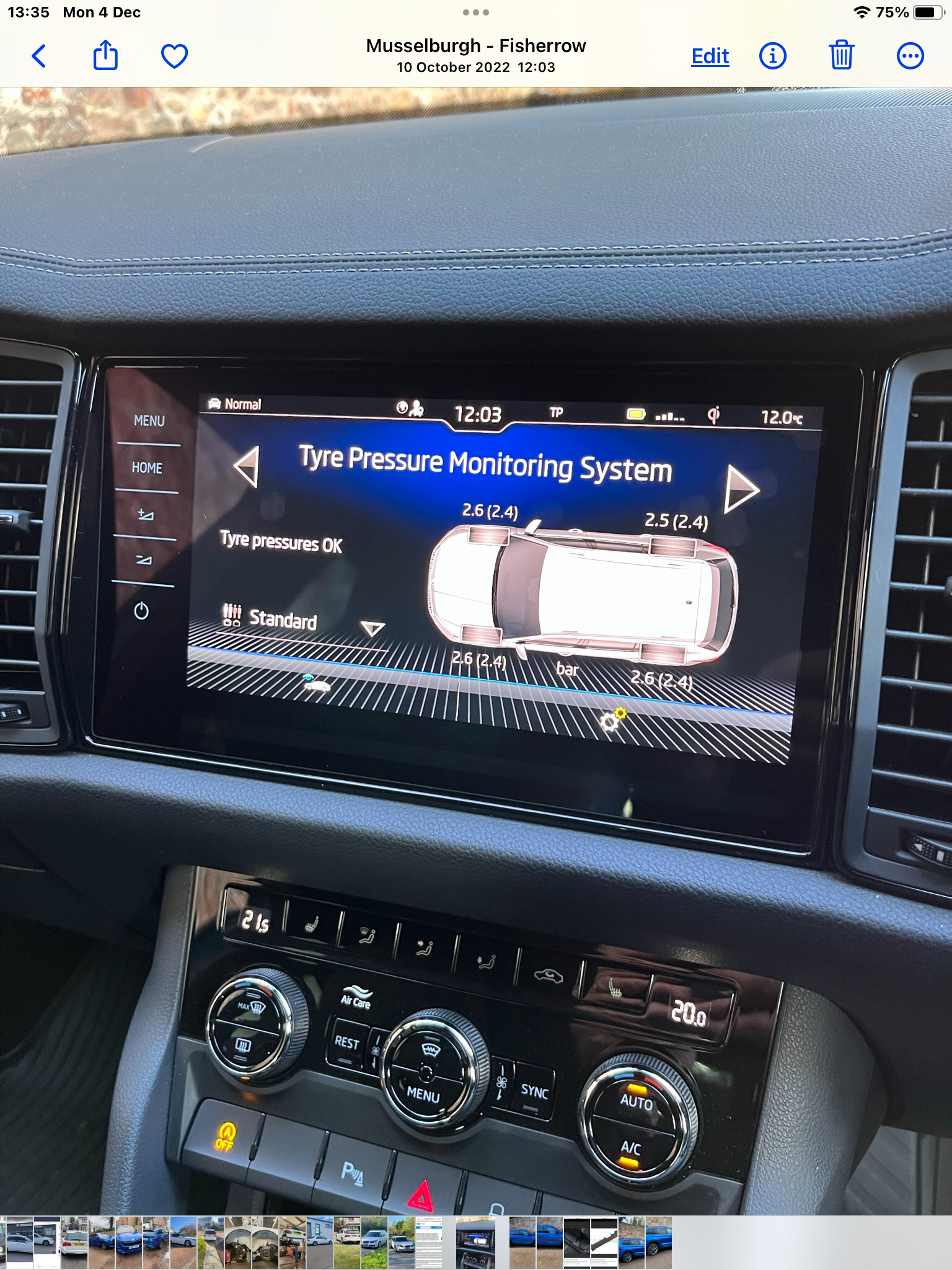

As above, sounds like you have the direct TPMS as in photo below. It is normal for tyre pressures to go down when the temperature drops, but if as you say the rears are loosing pressure every fortnight the tyres/ wheels need checked for leakage.- Rear fog lights only?
