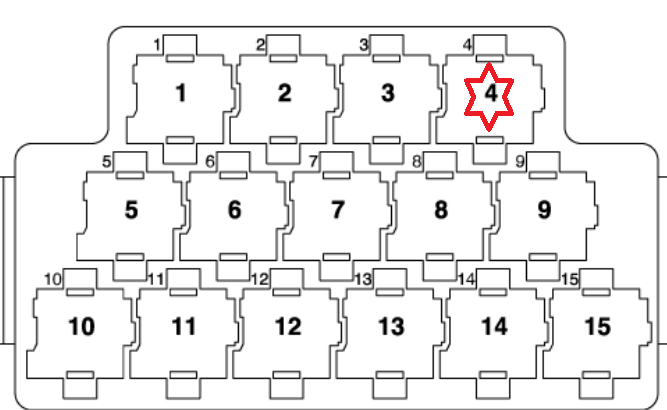

Drivers Offside Window Connector
With this being a mk2 Fabia, broken wire(s) in the front door wiring bellows would seem like the most likely explanation for the symptoms you're seeing, I think. Grey/white wire broken would be my guess.
Most connector housings will have their part number somewhere on them, albeit often in tiny characters.
