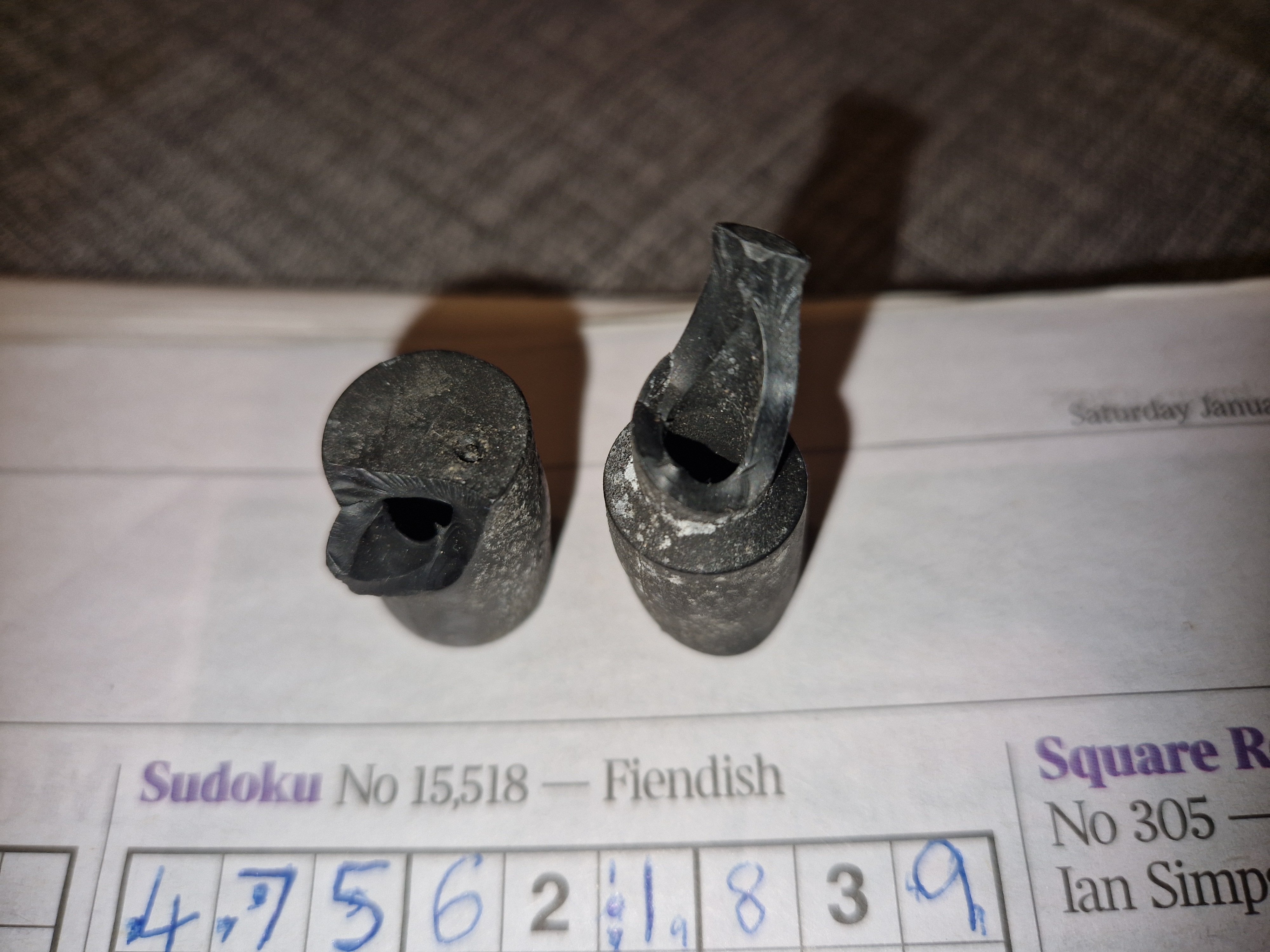

  5. You bought the wrong alternator, unfortunately. Who told you it was correct? Please don't say ECPs look-up by reg number... Please confirm explicitly that your car does not have start/stop. If so, the 03F 903 023E original alternator does not have a LIN connection. It has the blue exciter wire and the other DFM wire. I'll take my old 03F 903 023E to work with me this morning and see how readily the brushpack can be replaced. Found one for about half the price you mentioned, I think. See this page for independent verification that Valeo TG11C086 is a conventional alt, with L and DFM connections, not LIN, because you don't seem to trust what I am saying very much: A3508S | Alternators Just researching brushpacks now. Edit: if you click on the blue font TG211C086 part number on that page, it takes you to a page with all the parts including Valeo and their aftermarket replacement regs. Top website. A few options here, presumably the aftermarket replacement: Valeo Are3010 for sale | eBay This one had every right to be struggling, major wear to sliprings and brush protrusion near zero. Inner brush appeared to be just still making contact. Not sure if you've tried, but the back cover prises off relatively easily, I just warmed up the plastic around the two M5 stud a bit first. Then there are two M5 screws (8mm head) and one double stud with 7mm hex middle to remove regulator/brushpack.
