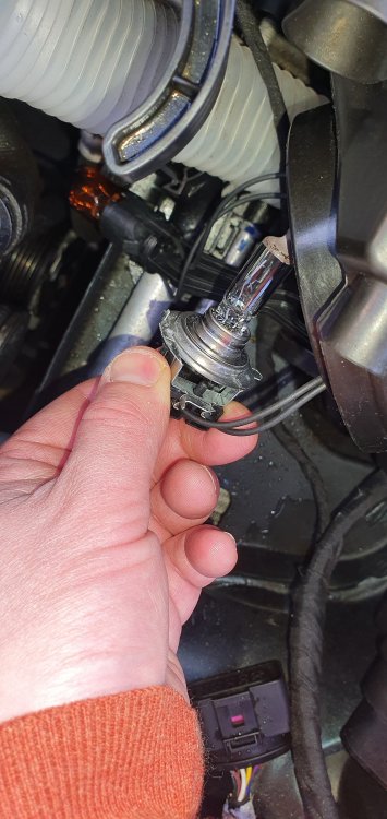

  15. In summary, if you are mad enough to want to replace the bulb in your projector headlights, then I think this is what needs to be done: 1) Removal of the battery (Left hand side) 2) Removal of lower skirt 3) Removal of front bumper and grill 4) Removal of inner wheel arch liners (both sides) All this to replace 4 bulbs.... There are videos and links on this forum on how to do that.

  17. Some images that I took to assist. 1) wires at top, sticky out notch to the right. This is the way we found to reinsert the bulb and holder.
