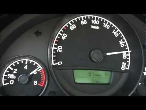

And i am going to be honist im dissapointed you are not going to use the std citygo clocks, first its going to be 5x100 now this.... it makes me sad.
It was considered, but there is just too much info unfortunately.
Have you seen the standard Citigo clocks?
Other than a big speedo it's rather limited. The rev counter is rather tiny too.
Having had a City-go (greenline?) version for 5 days as a courtesy car I defo agree...........
Defo need more engine info when running a tuned turbo engine.............
.......most important is the "wallet emptying dial".................
.....fuel gauge................... :rofl:
Love the fact that the picture you put was doing 175kph! haha
and just out of interest whats its going to be like to do general maintenance like changing the clutch for instance? bet that sort of work will be a pain! but still worth it!
that would be more stealth, i understand you need more info like boost temps of oil and coolant and all that info as it is a beast, i would have done a little design work to find a way to hide some nessessary gauges in the cabin keeping the stock speedo...... imagine that tiny rev counter whipping round like a windscreen wiper on full LOL! :giggle:
Good choice of dash, loads of screens and info to scroll through, can be as simple or complex as you want it,very versatile. nice piece of kit.
