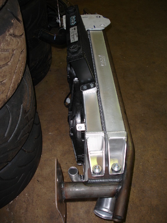

Side view of the cooler assembly.

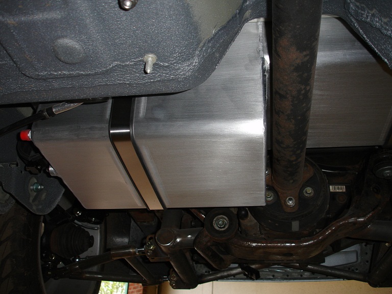

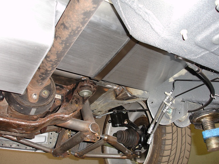

Fuel tank and rear end...
Wow :)
Not much clearance between the prop shaft and tank, is it just the angle the pictures have been taken?
A bit. It'll be fine. :)
They need to be custom drive shafts aswell?
