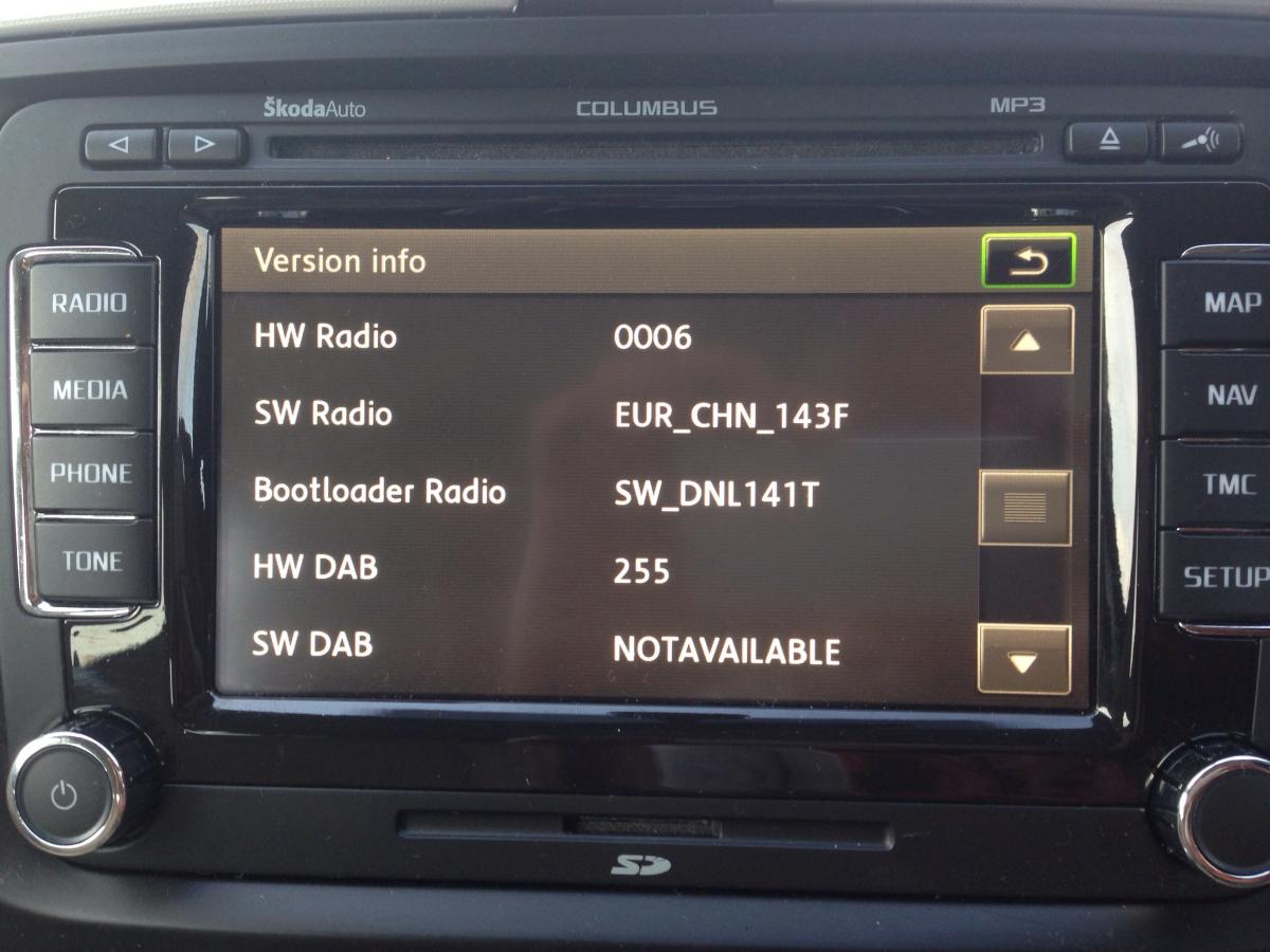

Something I've noticed in the hidden menu is the fact it mentions dab hw version. I'm assuming its just a querk and the unit doesn't actually have dab etc...

3T0...A does not have DAB built in.
That's what I thought I was just curious about why it would say something like that in the hidden menu.

Same reason it tells you about electric seats in the car user handbook?

Anyway this is what I meant. Is everyone's like this?
Cheers
Dave.

Dave: I don't have that in my secret menu on my older unit on 4020.
