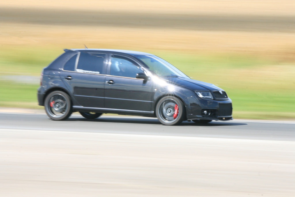

Monday!    Brands hatch Track Day!!
What a top day!!  many thanks to Bossfox for organising it...  Massive thanks to Jake hill for the 20 mins of scaring the **** outta me.. and it being my first ever track day..  in the pi55ing rain everyone was in high spirits.

my fav pic of the day..
