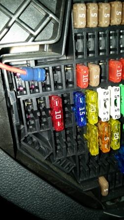

I have installed mine this afternoon. Quite easy. Used a piggy back fuse holder off eBay. Took to fuse 47 as shown somewhere else on here. Earth wire to a bolt at the side where you remove the side trim. The hardwire box is sticky backed to lower left of fuse board.

Interesting about, which way round to fit the piggy back holder. Better check mine, as it also occurred to me that I could be taking power straight to the wire and not going through the fuse. Or am I wrong.
