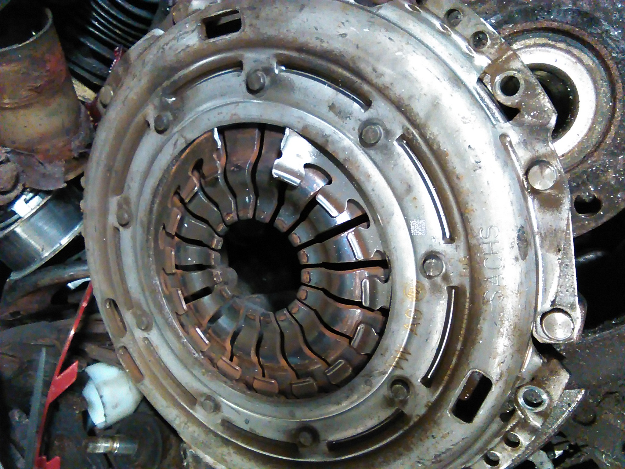

Just one small correction, there's no possibility at all it's the loose piece that does the damage.  The clutch/gearbox clearance is tight, and the protruding spring (about 6x harder than the gearbox) machines its way through the box like a lathe tool, hence the noise.
My oh my, I've been a very lucky boy, thanks mainly due to this thread.
As it happens I've experienced the exact same failure as the OP, albeit a little later in the cars life than most others.
From an occasional reluctance the change gear, to an audible noise emanating from the engine bay, all in the space of around a week.
If I have a one piece of advice it is to get out of your car every so often with the engine running and listen for unusual noises.
Doing this has just saved me well over £3,000.
Had the garage not squeezed me in this afternoon it could easily have been a different story, the mechanic reckoned I had only a few hundred miles left before needing a new box.
Here is my pressure plate, notice the huge piece missing, it was this missing piece that was flying around the gearbox trying to eat its way out. Luckily it was recovered intact with no other damage to the gearbox. They fitted a new LUK clutch and DMF for £600 inc. VAT...
For what it's worth my local Skoda dealer quoted £1,500 for the exact same work  :D, goodwill or not it wasn't worth the risk.
The car is now even better than it was, super smooth and now the weak Sachs clutch is where it belongs (on the scrapheap) I can now sleep easy!

As mentioned before two major problems to look out for the 2.0 diesel CR clutch
1) The above self destructing clutch cover plate
2) Slave cylinder/release bearing (which I think is included in a LUK clutch kit)
I've not mentioned the DMF as I've seen many exceed 200k miles
