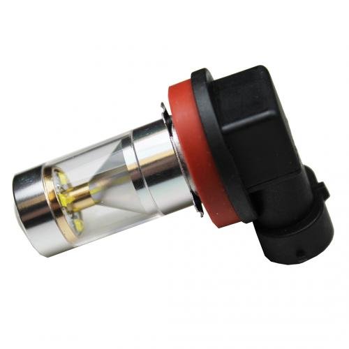

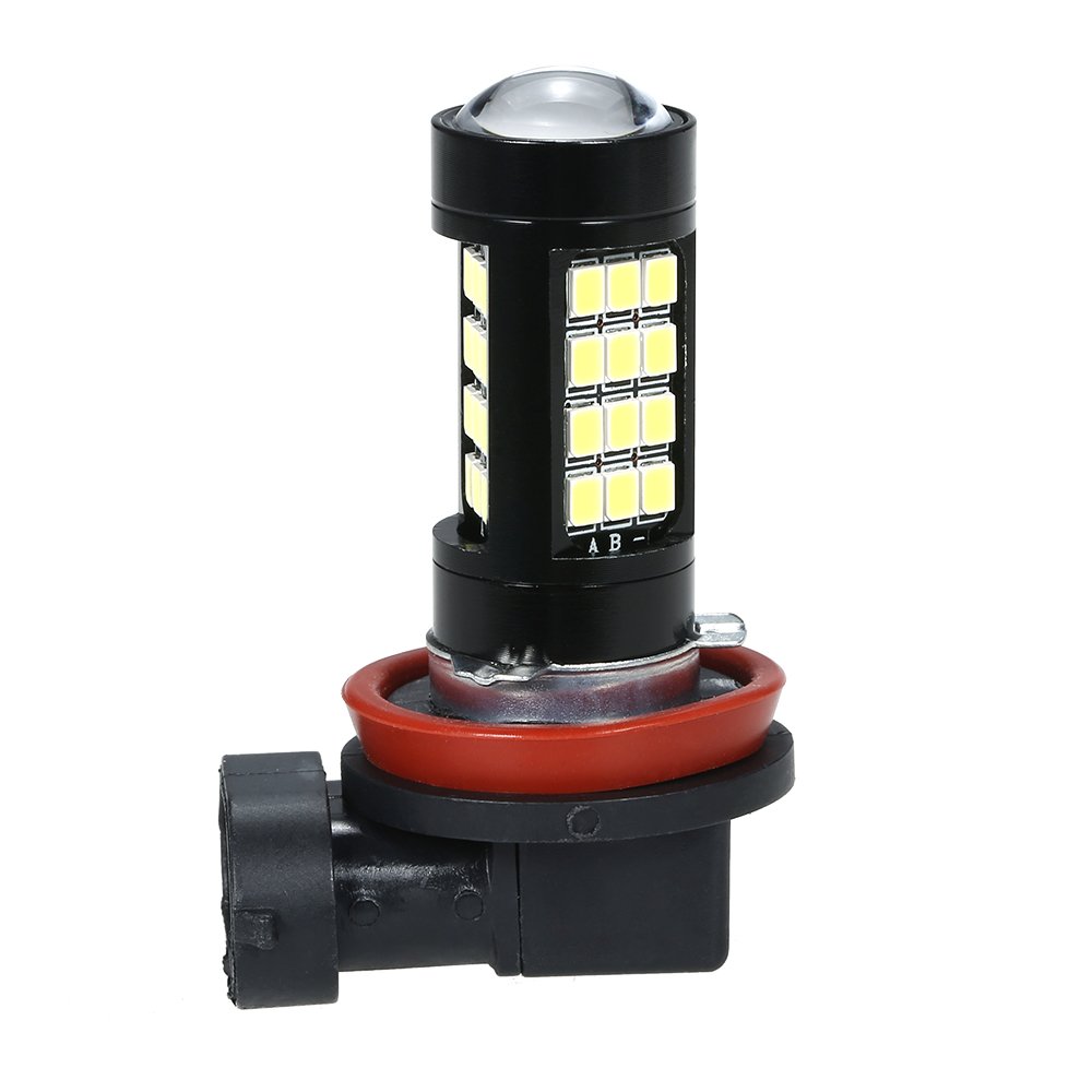

Anyone else have canbus issues when foglight bulbs were replaced? I purchased a set of 'canbus error free' bulbs from aliexpress but I'm getting errors. Contacted the seller and they sent a replacement but I'm still getting errors. Don't know if it's just the seller selling the wrong bulbs, can't be much else I suppose...?
@Apexor Please post a link to the bulbs in Aliexpress to see what type they are.
Mine work perfectly and i have no issues with errors for them. If you want i will post a link to mine - which are 4300 Kelvins - exactly the same color temp like the xenons (as the others 6000K - are more blueish compared to the xenons)
Try these...
https://www.autobulbsdirect.co.uk/h8-twenty20-cree-led-12v-canbus-foglight-bulb.html
@Apexor Now i see thy you have errors  - these are only 4 Watts.
The ones that i ordered are : Led bulbs - Claimed to be 52 Watts (both) - so 26 Watts each bulb.
I do not know if there are real values - but they work great - the light beam is very strong - much stronger than the original ones - and the light is 1:1 as a color - with the xenons.
That's great info. Thanks to you both for the links!

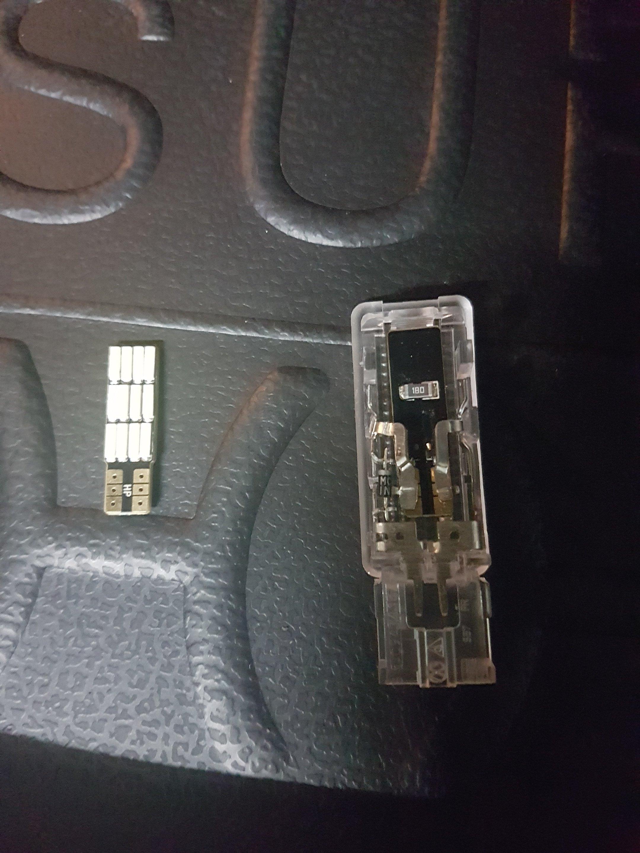

Hi guys - i have some thoughts in my head regarding the footwell lights. The original ones are LED - inside the "light box" - there is a small printed circuit board with a tiny SMD led - soldered. The led is somehow small and the light output is not so great. I tried with the replacement that we all use in the trunk (the ones from SuperSkoda and Aliexpress but the plastic cover is somehow bigger - and i need to make cuts on the front surroundings - which is not a problem. The rear are put in the metal bottom part of the front seats - facing the rear floor mats. This i cannot (honestly i can but i do not want) cut - as it is a metal surrounding.
Any way - the PCB with the LED - has two small metal pins - which are used to make contact with the light connection. Has someone seen or found a way to upgrade a little bit this PCB ? Changing with a regular led bulb maybe ? The problem is that the new led bulb sockets - have to be used to connect to the original power supply. Later i will post a photo of the PCB itself.
Thanks in advance for the ideas and suggestions.

I replace the bulbs with these led ones inside the original housing
This housing is using halogen bulb - and changing with LED is easy - but the cars that are with LED footwell lights - use instead of halogen bulb - a PCB with a small LED assembled. It has 2 metal pins - soldered to the board.
