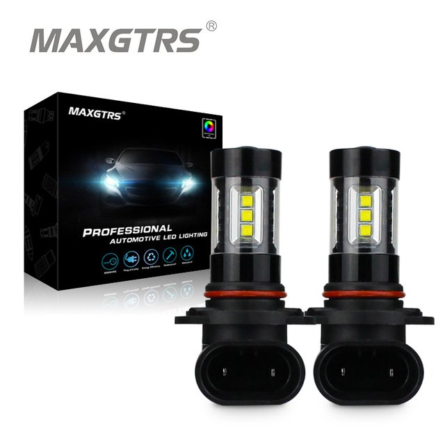

This is the correct link for the fog lights I have I put the reverse lights instead on my first comment:
http://s.aliexpress.com/2Enae67F

579273206_2x-H8-H11-9005-9006-HB4-H16-30W-50W-80W-CREE-Chips-LED-Car-Fog-Light.jpg_640x6401.jpg.b5993730d4e861d11def6a24551d57f9.jpg
beam from these will be so much different than from stock halogens,
LEDs must be as small as possible.
also we don't need LEDs on the top of bulb, only side emission
check how is designed "benchmark", Philips

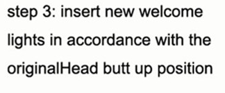

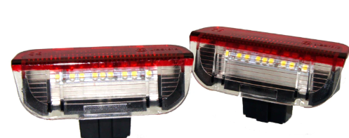

In a contrary post, bought a set of these from AliExpress
https://www.aliexpress.com/item/18-1210-SMD-LED-Courtesy-Lamp-LEDs-Side-Door-Light-DC-12V-White-for-VW-Golf/32703753282.html
Absolutely terrible.   The light from them is pink, not red and not massively different from the stock incandescent in terms of luminance
They also have a single PCB at 45 degree angle so the LEDs only partially illuminate the red plastic area and dont give a diffused look.  Three out of four rattled and the pcb is held only by the two plug pins  extending from the socket to the board and wedged into the plastic housing.  Worth considering before purchase the LED layout - some I've seen have two pcbs which are probably better for light distribution rather than a single inclined one
I didn't follow the install instructions...

@nodigital those look like the ones I bought initially and they were terrible… miles away from OEM and horrible light bleed at the edges etc.
I got these instead and they are pretty much identical to the originals… maybe a little brighter (with the same bulb fitted):
https://www.ebay.co.uk/itm/Warning-Red-OEM-Door-Lamp-Light-for-VW-Passat-CC-B7-Jetta-Golf-Touareg-Skoda-/201631655919
