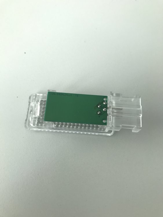

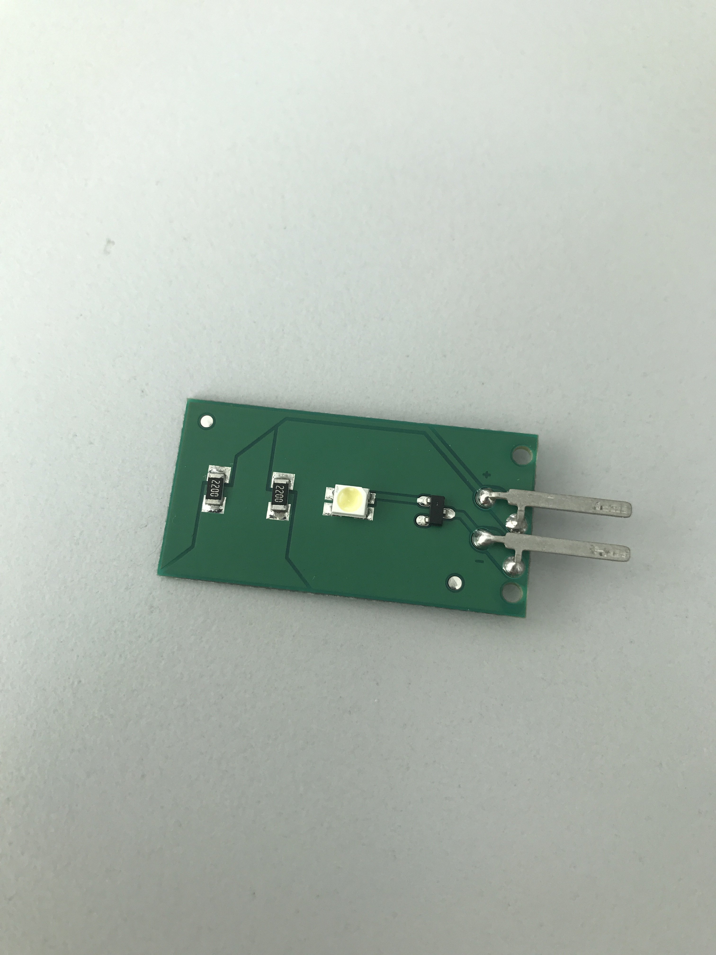

This housing is using halogen bulb - and changing with LED is easy - but the cars that are with LED footwell lights - use instead of halogen bulb - a PCB with a small LED assembled. It has 2 metal pins - soldered to the board.
Yes , sorry. The picture is from my trunk light. I didnt change footwell as they were already LED. You set them highest level and still not bright for you?

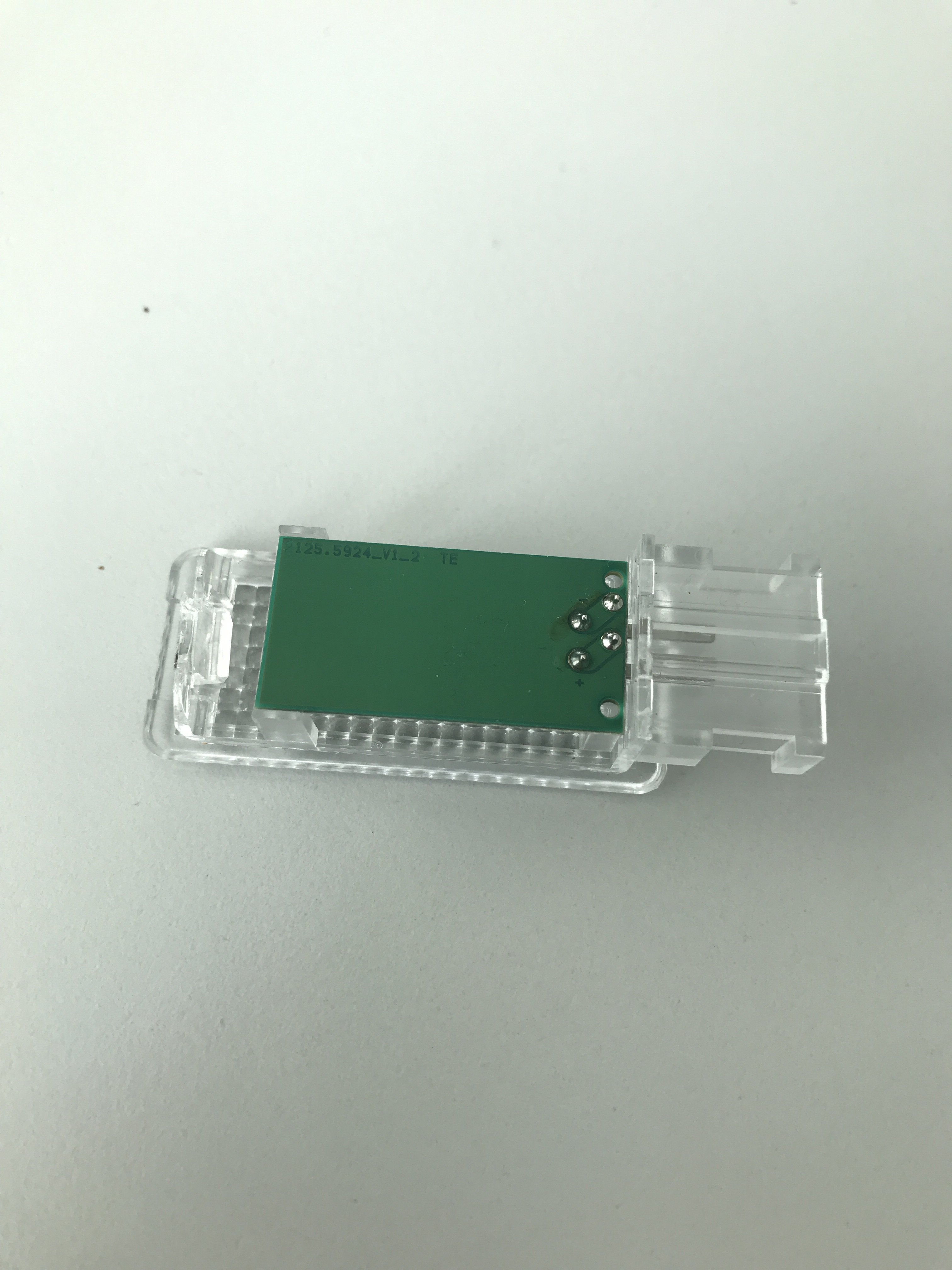

In fact - the light coming from the halogen footwell is much stronger than the LED footwell. I have seen Superb 3V with halogen ones - the light is stronger - and not only that - it is somehow more diffused - while with the LED - the light is only strong just under the housing. On left and Right - it is very weak. I want in general to have the same light but on a more large area. Something like the boot led light - a plate wish several LEDs - but i will decrease the light - not to have a stronger light - but to have the same light spread on a larger area.
These are the housing and the PCB with the small LED.
Anyway - the small LED itself give less light than the standard halogen bulb - and this is the reason that i want to upgrade a little bit the light output.
And due to the different connection - the female power plug that powers the footwell is different.

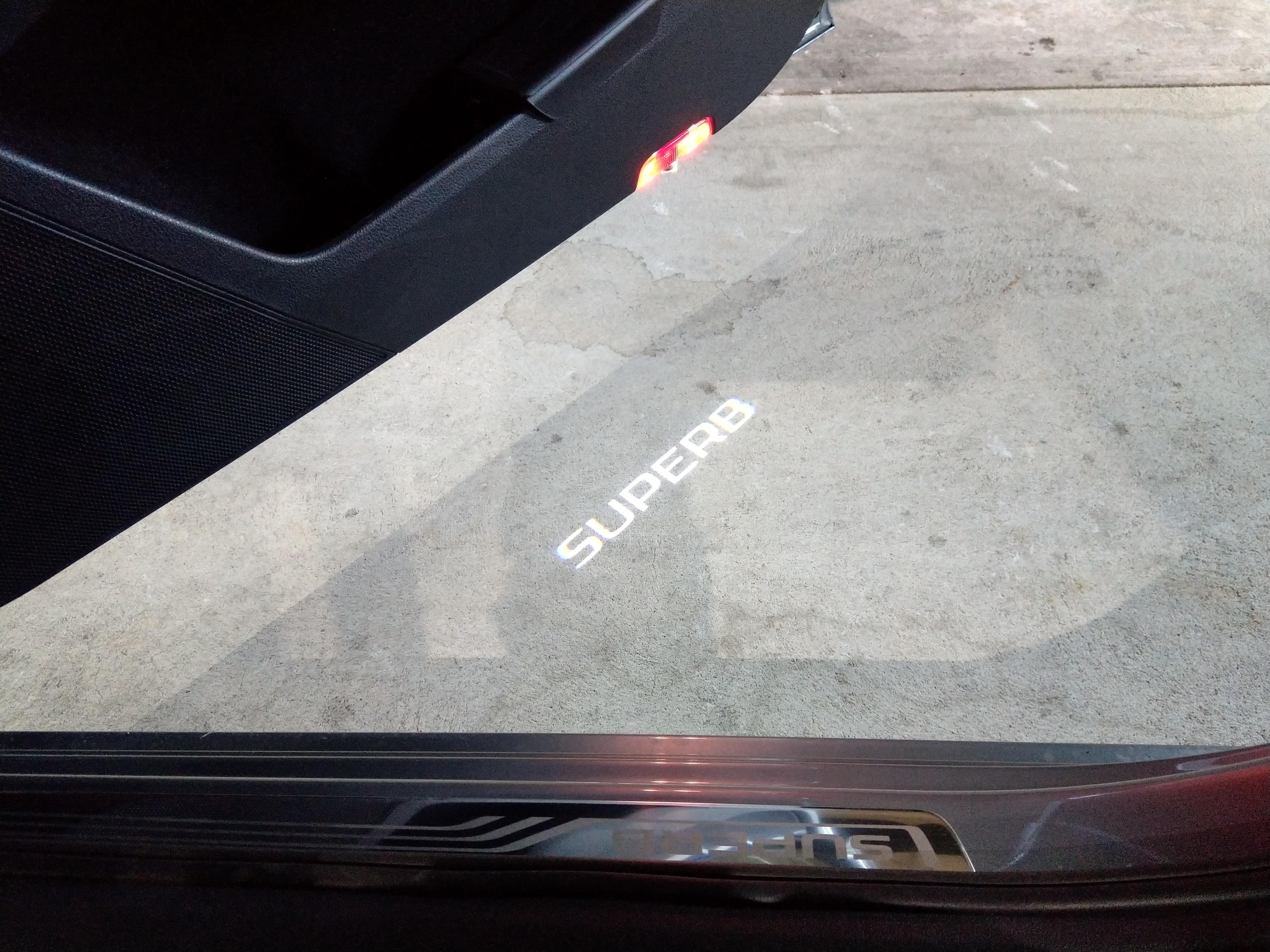

The lights at the bottom of the doors are a red (top) and white (bottom) and I was thinking of purchasing these:
www.superskoda.com/Skoda/SUPERB-III/Superb-III-MEGA-POWER-LED-door-safety-lights-WHITE-WHITE-KI-R
My question is, do they have to have the red as I rather like how clean the all white looks?
Many thanks
doesn't it depend on the motor authority rules and regulations in ur own country??
if its not required in ur country, for ur car door to have red lights/reflectors on the inside door - then u should no issues fitting the ones from SuperSkoda.
check the rule book.
i replaced mine with the Ghost lights from SuperSkoda - still has the red reflector bit.
Well said. I've tried searching for that already but I couldn't find anything however I'm not 100% sure I was searching the right thing.
I'm in the UK and can't see anything via the Highway Code or MoT check list... Hmmmm...
Many thanks
I’ve fitted the ghost “superb” ones at the front and white/white at the rear for extra light when getting the kids out in the dark. They look so much better than the original filament lamps. It looked odd before having cool while led interior lighting and yellow looking puddle lights when you open the doors.
I did try the led white/red but found them to be more pink than red.
I cant see it breaking any rules going for white/white as many cars don’t have them at all, especially in the back. Surely some light is better than no lights if the door is open and a car is coming towards it!

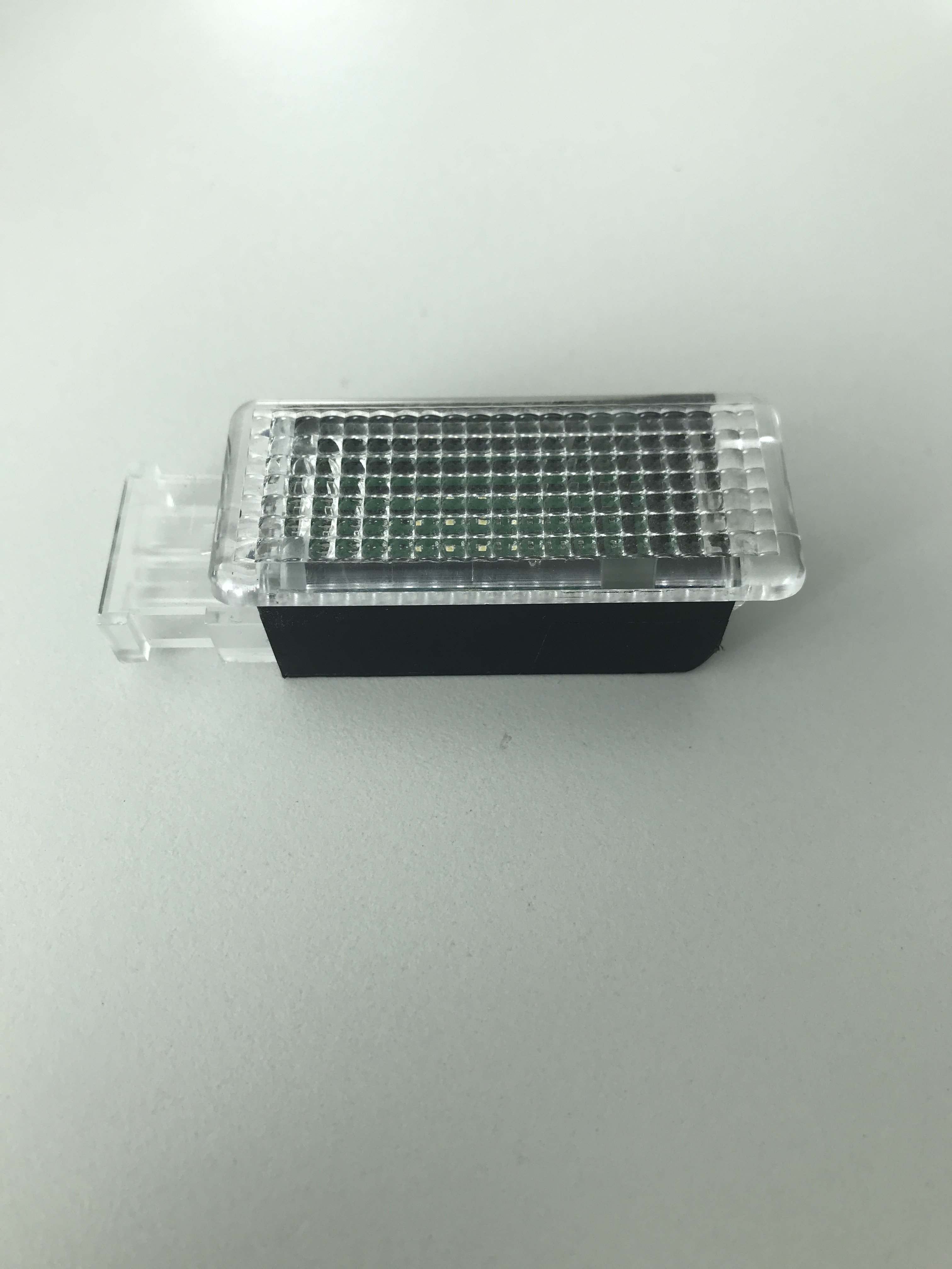

I fancy upgrading the door lights (white / white) the boot light upgrade and something I never noticed until joining here the glovebox light (supposed to be a pain to do though).
Cheers
I’ve done them all. The boot lights are a massive upgrade! So much more light! The glove box is a bit of a pain but not too bad. I used one of the boot lights and carefully cut away some of the plastic with a stanly knife to make the hole bigger in the glovebox. The wiring was a bit of a pain too as the plug didn’t fit. I managed to modify some fly leads that came with some other lights to fit. If I remember correctly I think some red spade crimps should work if you use the really narrow ones.

I think the reason for the puddle lights shining a red light horizontally and a white light downwards is the UK vehicle construction and use regulations prohibit white lights shining to the rear.
In a worst case safety scenario opening a side door without looking/realising that a vehicle is passing from the rear I would definitely want the driver to see a red light and not a white one.
That makes complete sense and answers the question. Many thanks

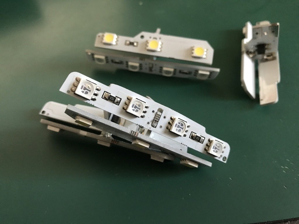

To get away from the red light looking pink (which will happen due to the white LED being much brighter) I fitted a set of these which use 4 red LEDs and 3 white LEDs:
35430929680_5f1576a9e8_o.thumb.jpg.4b48cfb13a436f404ef5e7787b4da7a7.jpg34979152984_5c0fb5c3cc_o.thumb.jpg.829cf4c4097fac98e81950eaafe79334.jpg
I was going to go for the red and white options on Super Skoda, they look spot on - I think. Lol
They still look pink IMO, that coupled to the fact they are €80 + postage (minus any discount... 20% at the moment) was a step too far for me, so I thought it was worth the gamble of trying the ones above at just £4 delivered to do all 4 doors :o
(even today at just under £9 delivered they are a bargain)
