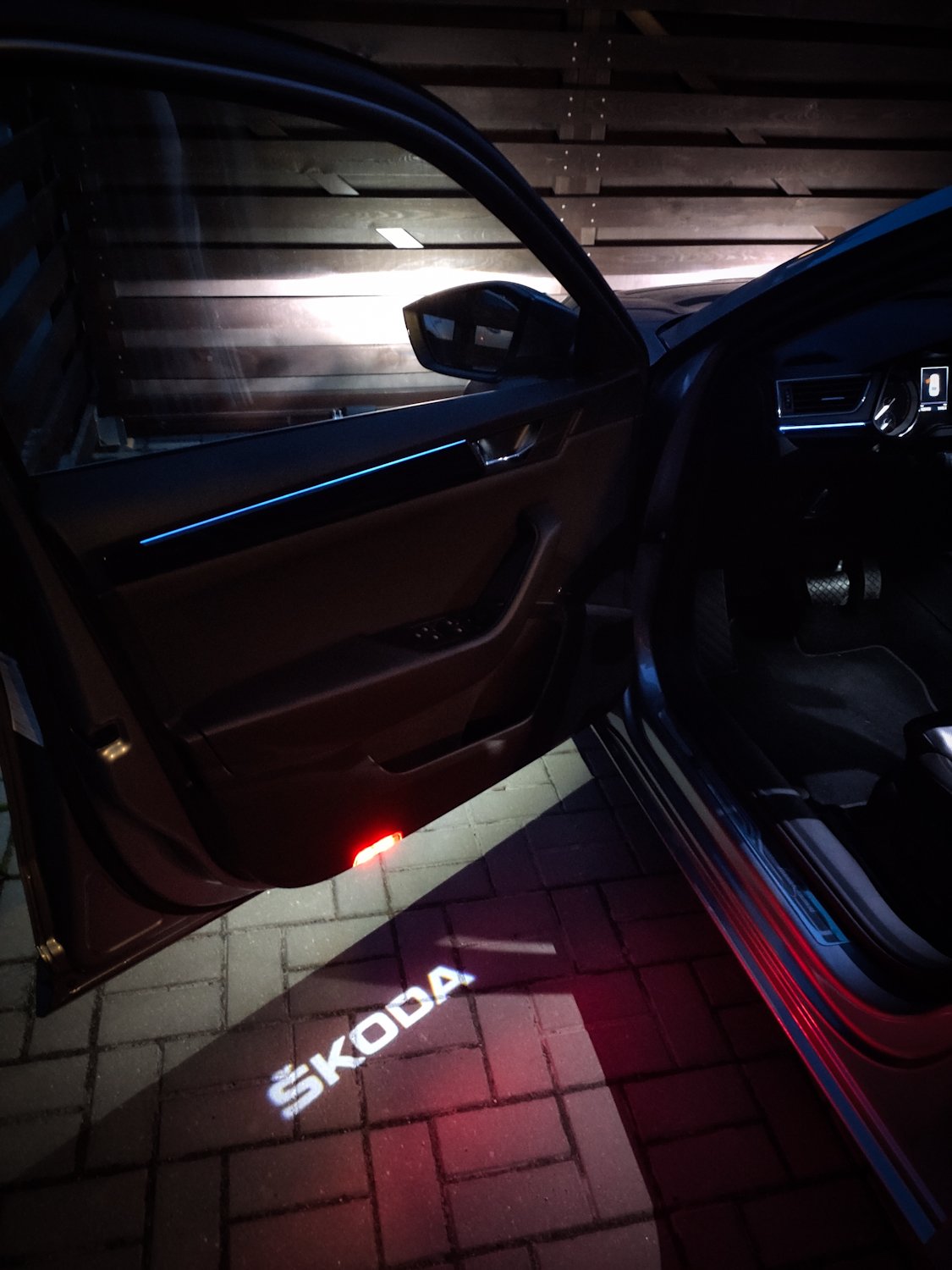

16 hours ago, Buocius said:
•door shadow light (really high quality):
https://a.aliexpress.com/_BVdhL5
Quite happy with all of them!
can't agree, bright example when marketing is more important than functionality 😞
On 30/01/2020 at 21:23, MartiniB said:
Sadly, but it's developed opposite way - for best performance in showroom not for usage in real life 😞
All the light of bulb is dimmed to make brighter letters, while that device firstly has to illuminate the ground
and shadowed must be logo
personally me can't accept that huge performance drop:
front - https://www.briskoda.net/forums/topic/393511-what-bulbs-are-fitted-to-the-s3-upgraded-bulb-recommendations/page/8/?tab=comments#comment-4851340
rear - https://www.briskoda.net/forums/topic/393511-what-bulbs-are-fitted-to-the-s3-upgraded-bulb-recommendations/page/12/?tab=comments#comment-4994279
For a trunk, i see no need to pay twice, since there are simple t10's in a brackets...
For a shadow line, I have absolutely no necessity to have bright lights under the doors, overall the projected lettering looks more then nice.

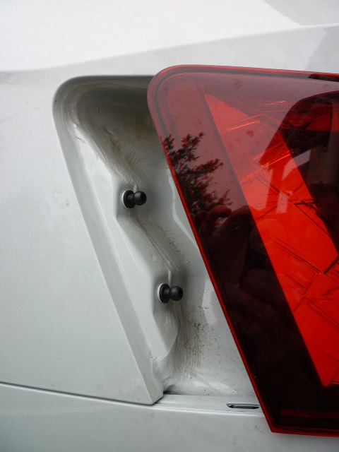

Hi All.
Can't belive I need to ask this but I have trawled the interweb, this thread & the site as a whole for videos or explanations but cannot find any additional info about how to remove the rear light cluster from a a 2016 Combi -for replacement bulbs. I've done everything shown in the handbook but my rear light clusters simply do not want to come out after removal of screws etc. Book says that after removing torx screws the tail lamp unit should simply pull out to the rear. Not happening for me. I don't want to force them to much for risk of breaking something or damaging paint by jemmying in the wrong place. No doubt many members who have upgraded their rear lights have done this so any tips / advice on how to pry out the tail lamp assembly would be very much appreciated.
Thanks in advance....
@Colin170CR Just pull harder... ;) Indeed, these 2 clips firmly maintain the tail lamp assembly. Just pull backward horizontally .
But I give it to you, it's not easy to get a good grip to pull...

Thanks BAP33.
I do hope you had that photo on file & did not go out & mock it up especially for me.
Your right, there is no place to get a good grip to pull on it. Not helped by the fact that I have a badly sprained right thumb at the moment so I can't really get any grip on anything with my right hand.
I may even have to fashion some sort of tourniquet around the screw brackets to help me pull on it evenly & harder with my left hand.
Fingers  crossed!🤞

Rubber gloves will give you slightly more grip if a sliding motion backwards might work?

No worry, I had taken some pictures to write a tutorial for a french Skoda forum, when I switched to LED for reverse and blinkers lights... ;)

Thanks. I'm doing exactly the same. Bulbs arrive tomorrow so I will resume my efforts then.

Thanks Bap33 & NJRJ. The wife's rubber marigolds & bit of brute force & ignorance got the job done. It was still bit of a faff with only one fully functioning hand though. New Phillips LED amber rear indicators (pricy) & reversing lights now fitted. I'm now looking at perhaps LED's for the front fogs / turning lamps - not worried about the lack of performance in fog as we don't get much if it. The whiter light is more useful at night for cornering. I'm also looking for replacement LED bulbs for the tailgate (combi) to avoid the high cost of the Superskoda items - which I was going to buy but I had trouble with their non-secure website at check out. They also do not seem to take Visa cards so I bailed out.
@Colin170CR Great! Happy for you!
