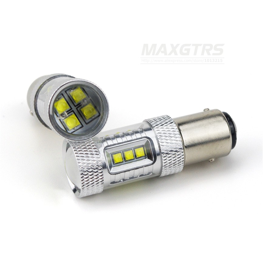

On 24/03/2016 at 19:19, Gizmo said:
Reversing Lights
1156/BA15S/382
STD:
80W CREE LED’s:
http://www.ebay.co.uk/itm/2x80w-1156-BA15S-382-BRIGHTEST-OSRAM-CREE-LED-WHITE-CANBUS-REVERSE-BRAKE-DRL-/152013310456?hash=item2364b309f8:g:Ww4AAOSwDk5T94q8
Fitted:
To give you an idea how bright these are this is them fitted to the Yeti (on the S3 you lose some of the brightness due to the silver caps that cover the bulbs)
Myself and a few other members have used these in various cars (Citygo, Fabia MKI, Superb MKI, Yeti etc and nobody has a bad word to say about them!)

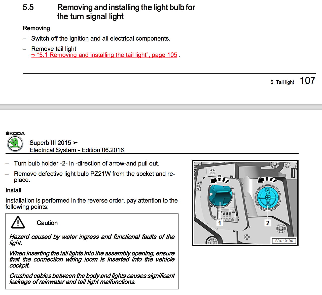

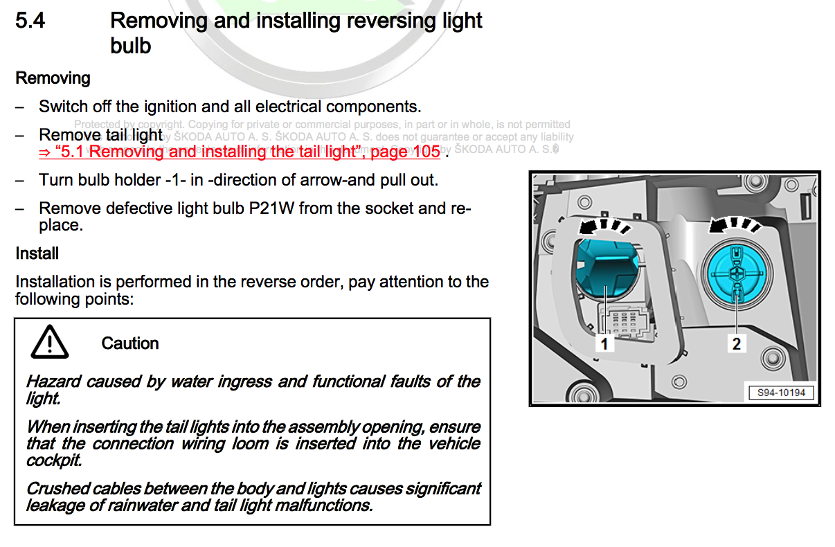

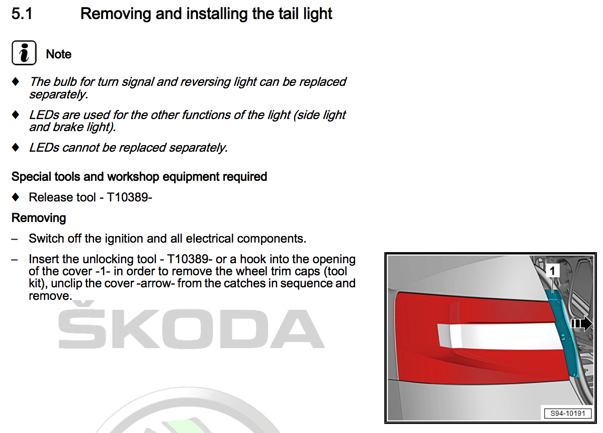

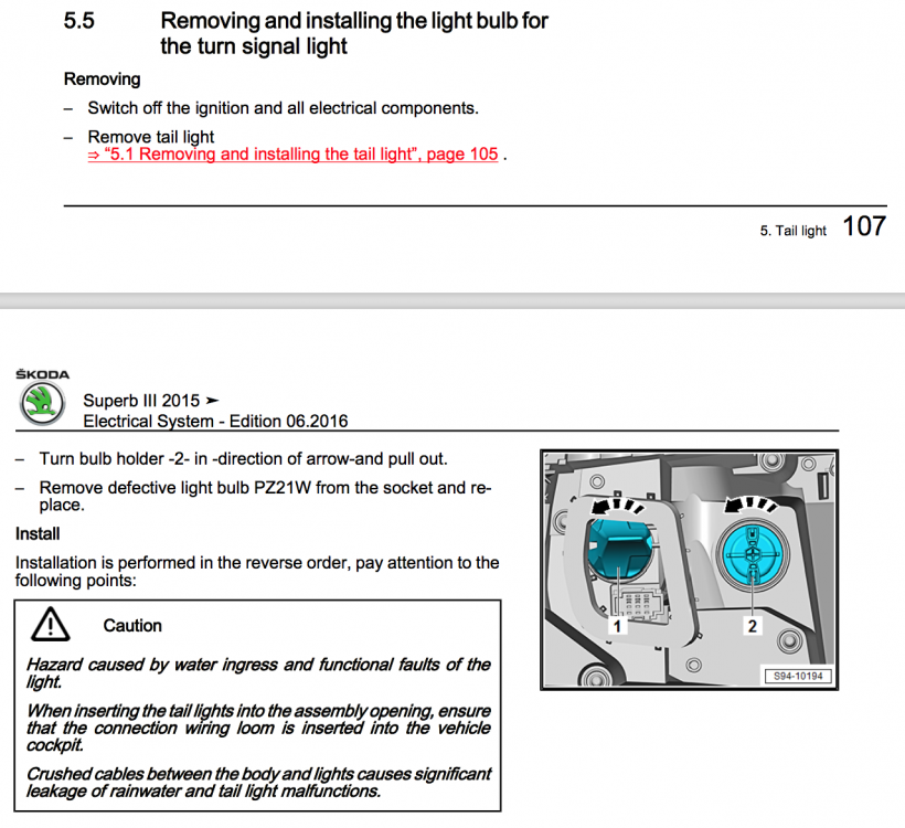

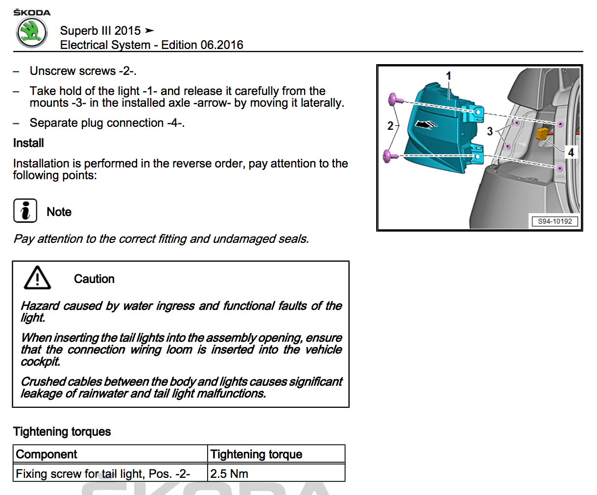

Is someone able to provide a copy of the part of the workshop manual online that details how to remove the rear lights/replace the rear bulbs?
Edited by fencer
Don't have a link to the manual but I followed a youtube video (linked below). The plastic covers are very tricky to get back on so take your time.
Does anyone have a link to where the plastic water deflectors over the rear light fixings can be purchased? I damaged one of mine and it's not sitting back on properly.
Fencer, follow the instructions in the manual it is an easy job and takes only a few minutes. You can download the manual.
Edited by Brackenwood
Clarity
Yep, thanks. Manual downloaded and relevant parts copied below if anyone is yet to change their rear bulbs:
161242969_ScreenShot2019-01-04at3_28_32pm.thumb.png.67fa64e9ca802148596a1dec19b0aa57.png1245977889_ScreenShot2019-01-04at3_29_06pm.thumb.png.3272152e38cbd67b6c799dced3ff55d9.png378173033_ScreenShot2019-01-04at3_29_27pm.thumb.png.0602680c3fbdd323f6e54c4669621658.png1908877865_ScreenShot2019-01-04at3_29_41pm.thumb.png.23b151a9ee80dc93f21651a19a471f90.png

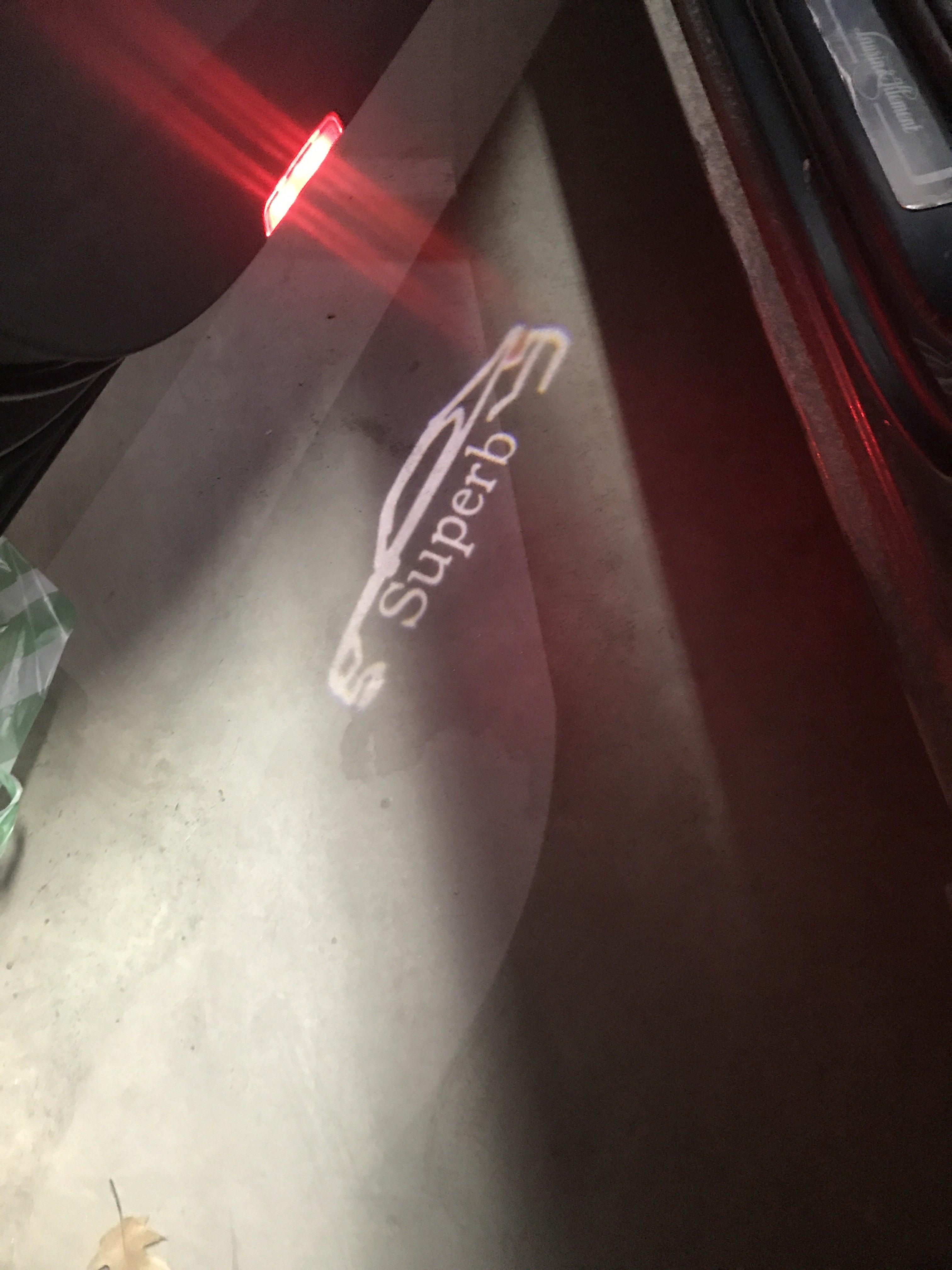

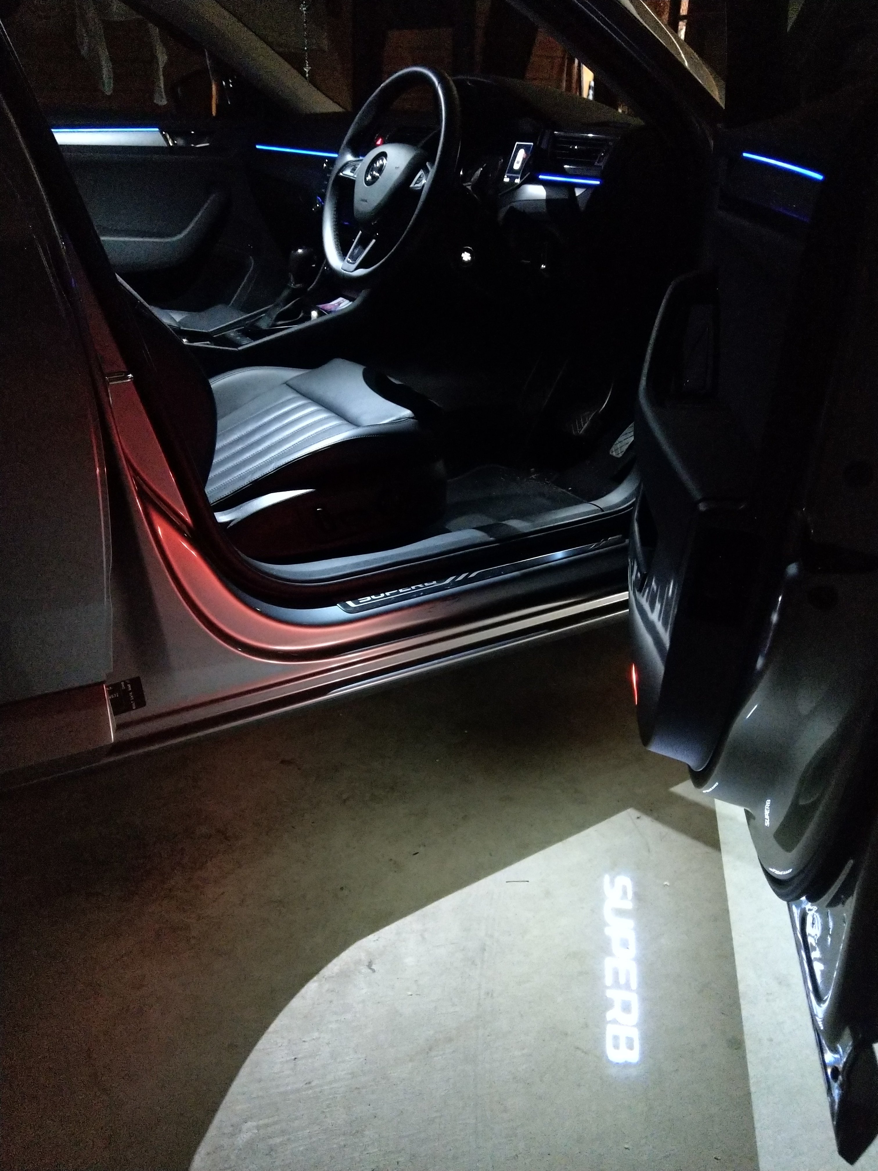

I just got my led LOGOs for the front doors. I am a little bit confused whether to leave them on the car or to get back to the old lights (led).
That's some really AWESOME logo!!! Hat down to the designer!
Simichoil
i felt the same when I fitted mine which say SKODA, as they are not as bright on the road, although quite cool. Might go back to the original fitting and just put led bulbs in.
i like mine that says "SUPERB" :)

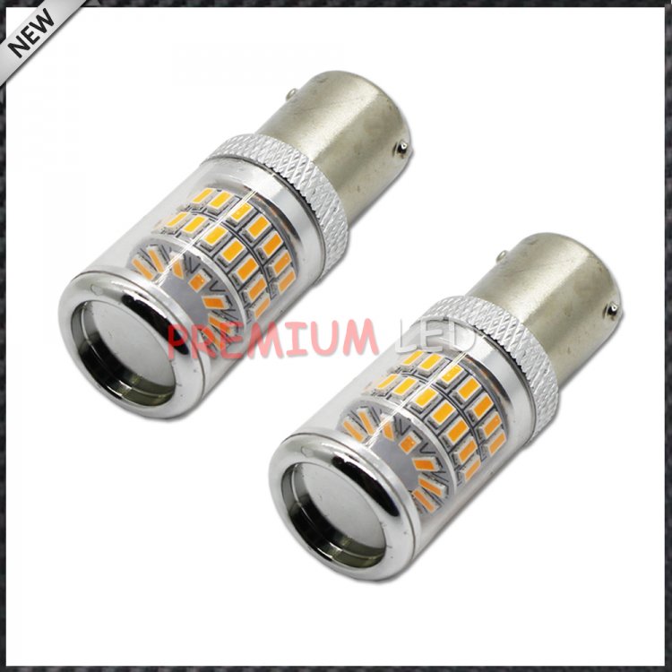

Final question... would you suggest that both the reverse and indicator bulbs are "internally mirrored" (https://www.aliexpress.com/item/2pcs-Amber-Yellow-Error-Free-BAU15S-7507-PY21W-1156PY-LED-Bulbs-w-Reflector-Mirror-Design-For/32316963252.html)
or, as you have linked earlier in the thread, indicators are mirrored,
and reverse are fully lit
(https://www.aliexpress.com/item/2x-50W-1156-S25-P21W-OSRAM-10SMD-6000K-White-LED-Turn-Signal-Light-Backup-BA15S-Led/32359807413.html)?
