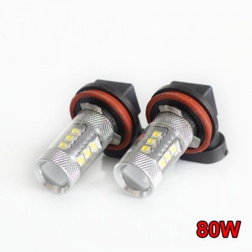

1 minute ago, MartiniB said:
that design bulbs will provide absolutely wrong beam of light!
I completely agree, I would never fit them!

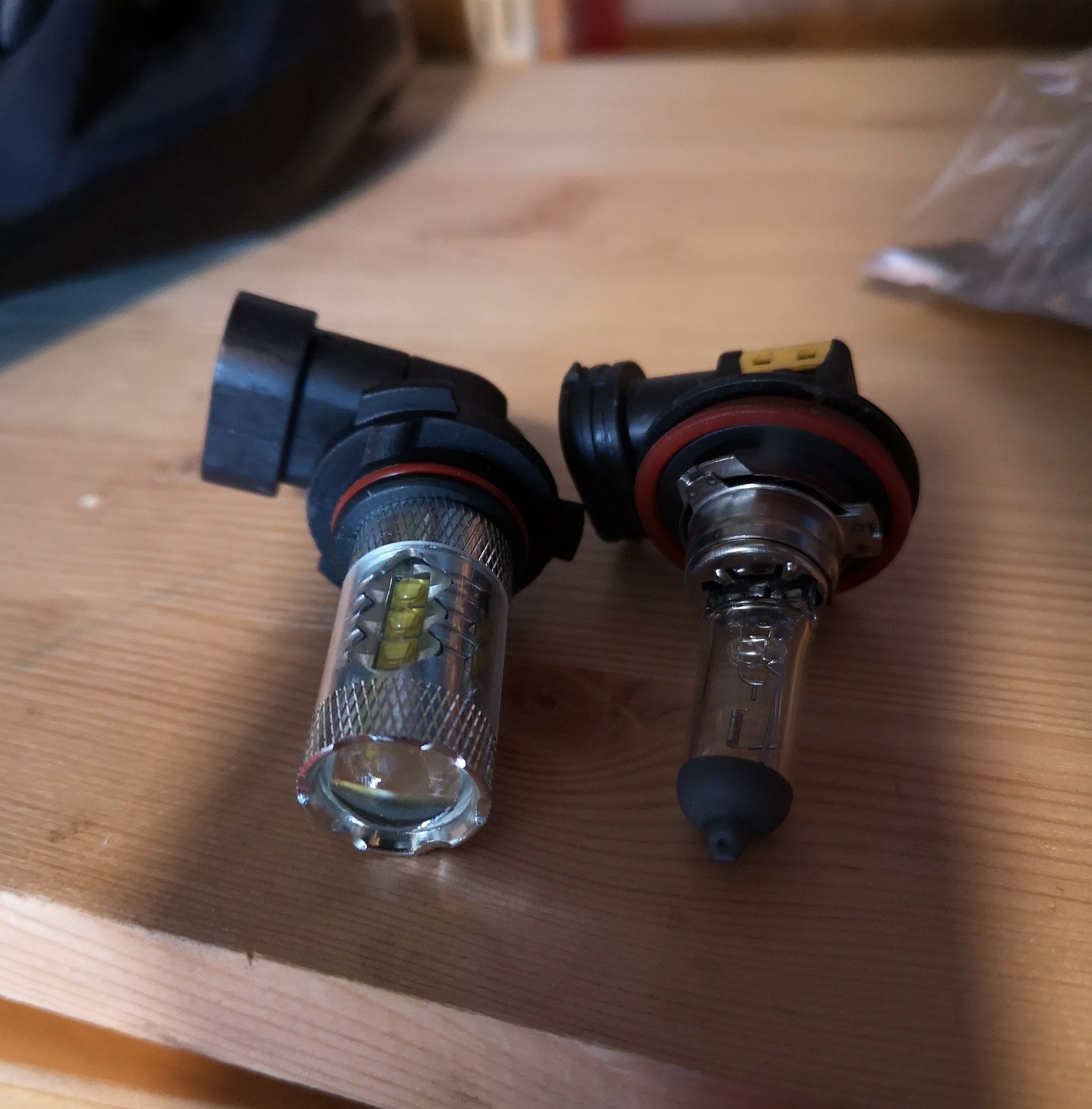

It was taken from newbie link where they ordered H8 leds. This is what they received:

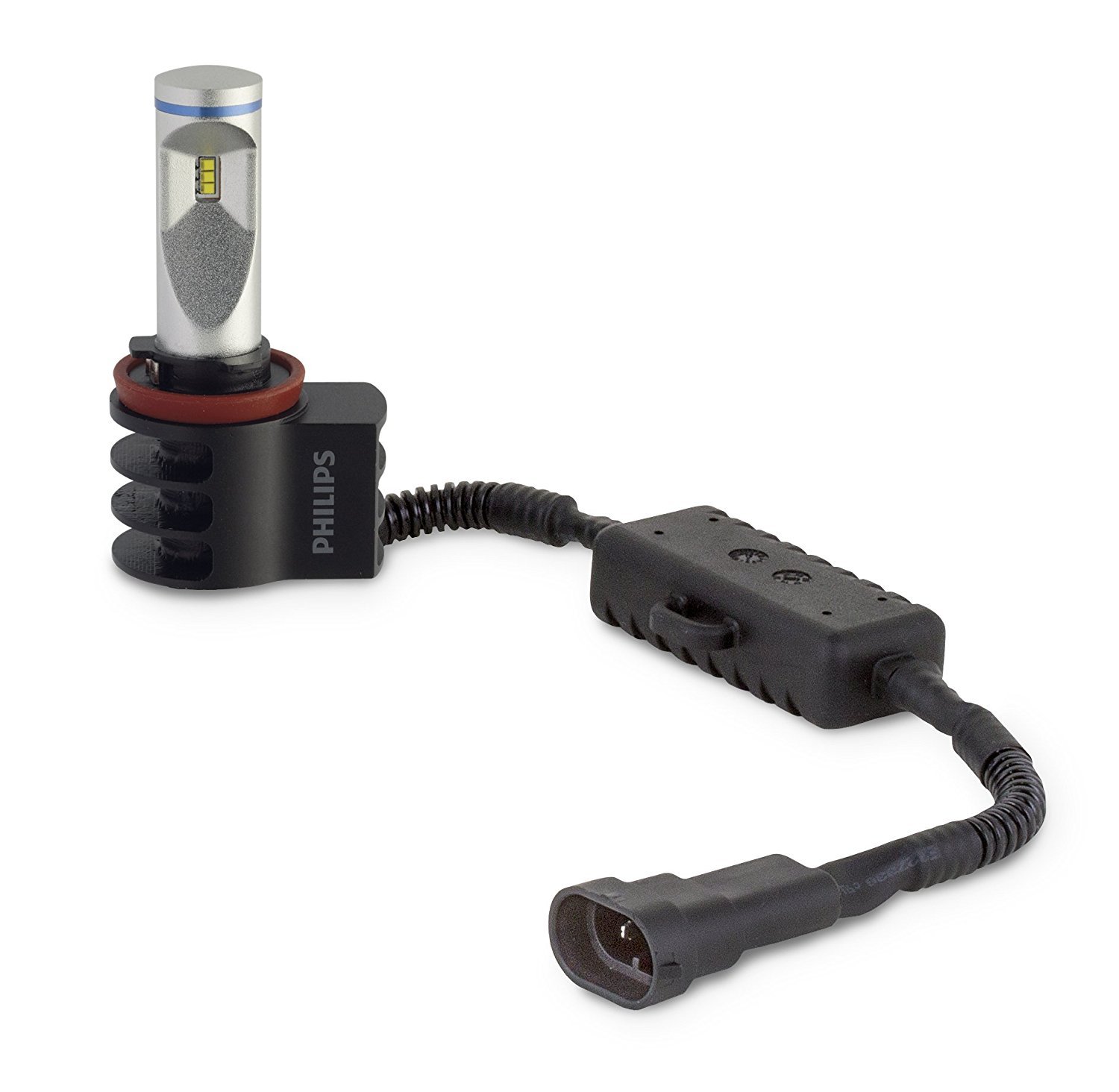

But I don't think the left bulb is a H8/H11/H16 version, if it was, I'd expect it to look like this:
The design you posted:
Is exactly what I fitted to my FL MK2 Octaiva. However, rather than being a genuine Philips version, it was a cloned Chinese thing that was significantly cheaper :D
