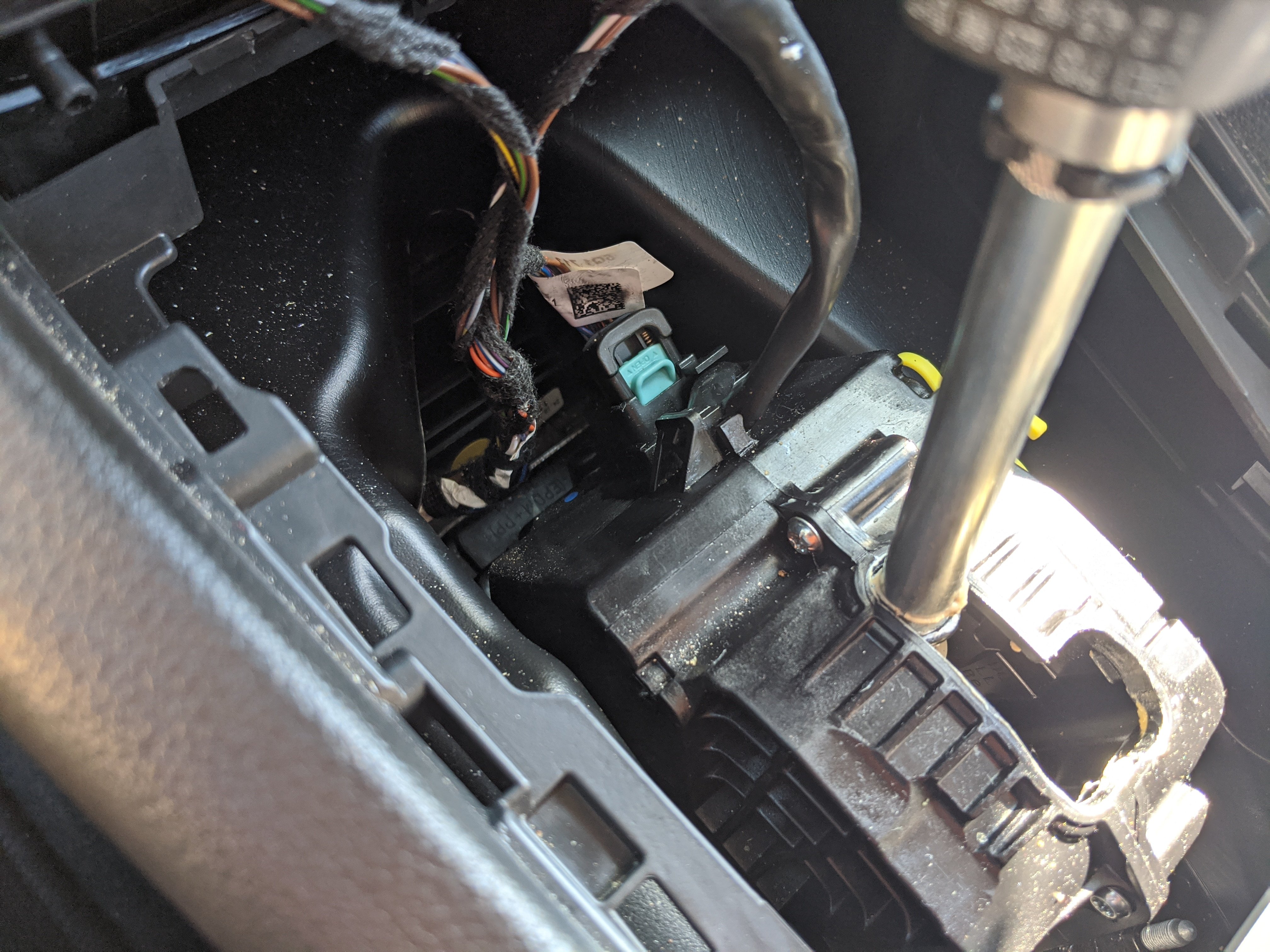

FZS1 - Indeed, it mentions having this error only while in motion and that was my case as well. As far as the fix goes, it is a bit of, as we would say here "foefelen"(covering a hole in the wall with a poster) but does the trick. Even if the velcro detaches the switch will not cease to function as it is the black surrounding going over the gear selector lever that matters. Adding a bit more photos to see how it looks with/without the new switch. This black surrounding is held by 1 torx screw underneath and could only get loose by pure torture. If people managed to do that, they would destroy other parts on the car first.
You seem to have quite a few electric gremlins on your car. This might be a long shot but will ask anyway. How is your car battery? Some Octavia's were shipped with bad Varta's that caused all kinds of gremlins. Now, I'm guessing here but maybe worth looking into.
NikTheGeek - That would indeed explain why the issue kept popping back. I would guess the new selector will work fine for a while but after some time will get the silica buildup and suffer in the same way. Not sure though but new remediated levers might have a different part number. If this is true and what they are, I don't know. Skoda is being quite reserved with this and some other "know" issues. Maybe a new remediated lever doesn't even exists. It what I understood from people but might have totally got the wrong picture.

  • Here is how i changed my switch on Skoda Superb 3 2016.
  • Problem solved only £40, I bought the switch from a friend "mechanic" and it tog me a half hour to mount on top of the DSG gear shift very easy so the only thing you need is 5Q0-713-128-A, some tools

 The piggyback add on switch 'fix' looks a bit of a bodge job to me (NOT your fitting of it !!!!!!), because if the velcro attaching the newly added switch to the selector mechanism fails, so will the switch adjustment?
Just for information the micro switch harness assy consists of 4 parts,
1 - a connector that connects to the dsg selector mechanism.
2 - a connector that connects to the car harness.
3 - a small black box that you Velcro to the dsg mechanism (I believe this has a circuit board in it which disables the switch within the dsg mechanism itself that is causing the problem).
4 - a micro switch assy that is fitted to the top of the selector mechanism, which is firstly secured with a screw and then with two metal clips, once the switch has been setup using the method shown in the procedure ANOTHER two clips are fitted. Once this has been done there is no way the switch assy can ever move, they would have to be forced off because they dig/cut into the plastic.
I have been really happy with the fix on my Octavia and it has saved me a great deal of money.
Thanks to you all for your info - Now the piggyback switch fitment makes sense to me. I was assured that the selector mechanism fitted to my car had the new type of switch fitted. The part number is 6C2713041F. I don't know if the part number for the mechanism changed when the new type of switch was fitted to it, or if indeed it ever was fitted with a new type! The battery issue interests me though, as the garage mentioned something about the battery after they replaced the selector and had the P park error permanently. As for the !LIM problem, the garage said they have several Fabias with this, all DSGs.

Matt, take a look back a few posts and you'll find a PDF from a recall that gives a quick fix for this. Part costs around 40€ and takes around 30min to install.

What is the part number for this replacement switch, for the fix
5Q0-713-128-A

Thanks to this thread my dealer fitted the microswitch to my 2017 Octavia yesterday.
I’d emailed this thread link to them the week before so either they read it or knew about the problem already.
Mine had the intermittent error soon after setting off (so not door related in my case). It didn’t appear often but amazingly did it twice the day before I took it to the dealer - so they might have been able to see a code.
Fingers crossed it has fixed it for good.

Thanks to GOJKONJEGOVPAS for advice on this, I called my local independent garage that I use and asked if they could get the part number, it came in next day and it took about 20 mins to fit, the error remained at first until all the error codes were cleared, I have had no problems since the part cost under £50 and I owe the guys some cider as they helped me fit the part on the day so I was very lucky.
