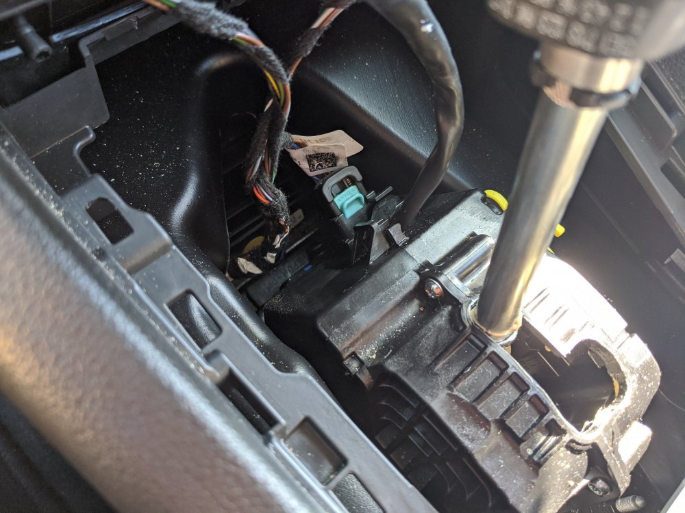

On 23/03/2021 at 12:19, Nevals said:
Hi all,
Can anybody tell me if this switch can be changed on Superb MKIII (2016)?
Or do I need to change the complete gear selector assembly?
Thank you in advance.
Yes the switch can be changed in the box. You have picture from insight the shifter box in attach but to do that you have to disassemble whole central part in the car from the rear to the climatronic.

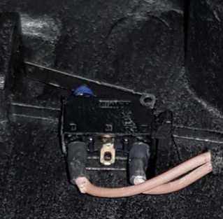

The Engineer told me that the Error message you see doesn't always result in it being logged for some reason, he had come across this before, could be a bug in the logging software I guess. I didn't need a new gear selector mechanism either, its a microswitch that gets gummed up. Apparently the repair is just a case of piggybacking a new microswitch on the existing one and swapping the wires.

It’s a Microswitch on the gearbox. Gets gummed up you could try to clean it but probably best to replace. You can piggyback the replacement on to the original apparently. Had mine done under warranty.
