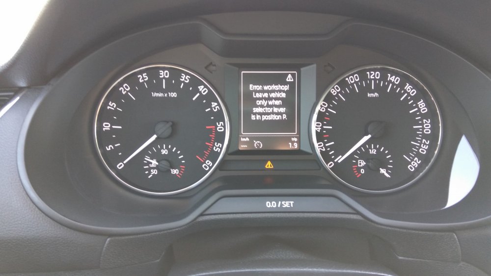

On 14/03/2017 at 14:16, toni8b said:
Recently I had this error pop up few times just as I started diving, manage to capture a photo this time. When I restart the car, the error disappears.
