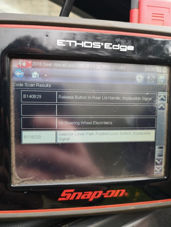

Hi, don't like to revive an old thread, but a quick Google search brought me here. Have a 2016 Seat Leon 1.2 TSi automatic and am getting the exact error mentioned above B116229 "Selector Lever Park Position Lock Switch, Implausible Signal.
This has been coming up intermittently since I bought the car used 9 months ago (with 12 months warranty). I've taken it in a few times for the intermittent fault, and they changed a water pump and a few other bits which never solved the problem.

Just to give a quick update on my situation, the garage opened on the LAST day of my 12 month used car warranty. I phoned 6 times and nobody returned my calls. So I drove in at 3 o'clock and managed to get them to raise a repair under warranty. They also found an issue with the boot door sensor too, so bonus for me 👍🏻👍🏻
