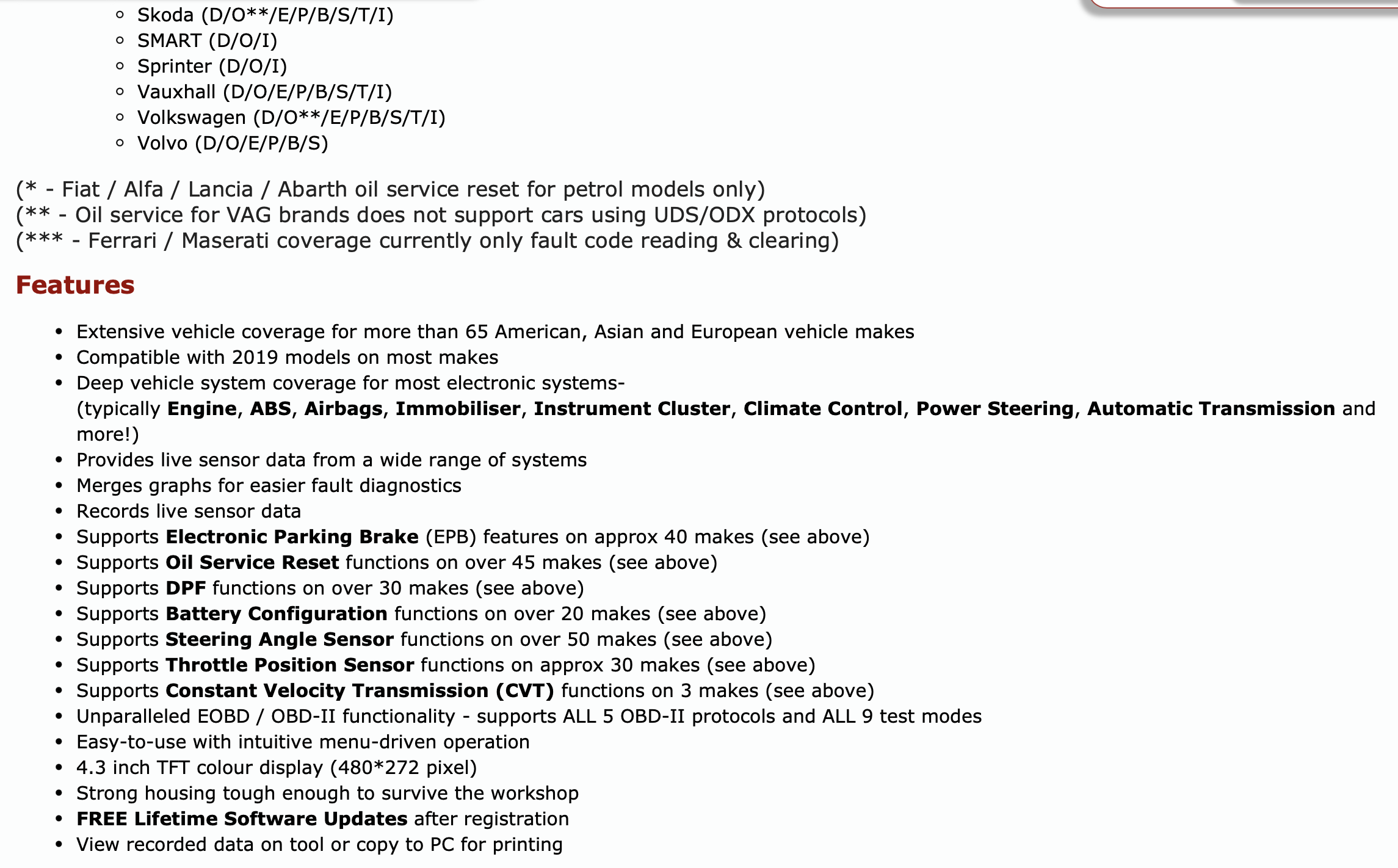

Hi Folks,
I have been chasing sorting multiple lighting issues for a while now, and have decided I need a Scan tool
I have followed links on this page and from the Gendan Automotive Products site, saw the Foxwell ND680pro
I am looking at a multi make compatible purchase, as apart from my Skoda (2010 octavia combi CFHC), I have BMW, Jeep and Isuzu vehicles which do or may need its attention, and I don't want to keep buying expensive kit
My question here is (please refer to screen shot attached), does my octavia use the UDS/ODX protocols relating to the oils service reset functionality of this tool?
Is there anything VCDC system diagnostics can do, which can't be done on this multi vehicle reader?
e.g. can I re-code a replacement BCM with both of these options
I am new to this any advice greatfully received
great forum guys, TIA

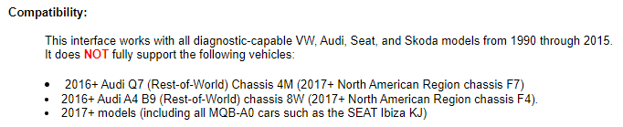

I’ve not managed to make much sense of the Ross Tech website so thought someone here might know…
I’ve currently got a Ross Tech HEX + CAN lead which I was using in my previous Octavia Mk3.
Would this lead work on a 2019/2020 Karoq or would I need something more up to date?
Details for the HEX+CAN:
On a 2019/2020 car, I'd expect a HEX+CAN to be able to access some modules but not all :)
For full compatibility, you'd need to upgrade to a newer interface like a HEX-V2 or HEX-NET.
