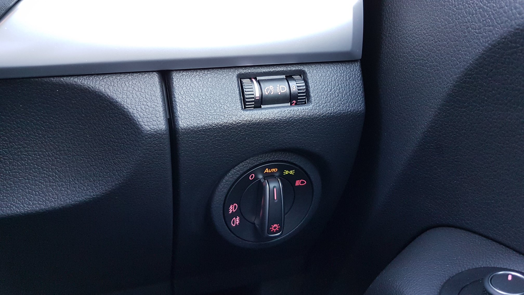

I can see they raise/lower when switching between full and dipped, but there's no adjustment dial in the cabin.

Yes, they appear to make slight up/down adjustments when starting up
I fully agree that they seem too low. I have the same problem with both my cars; had I had the option of adjusting manually like on the old car I would have set them higher. Yet both work as they are supposed to - I had them tested and this is the road legal beam height; it may be modified by the dealer but that could expose to MOT failure as the lights are considered dangerous and thus strictly regulated (as goes with the mandatory headlight washers on HID/LED vs halogen systems)

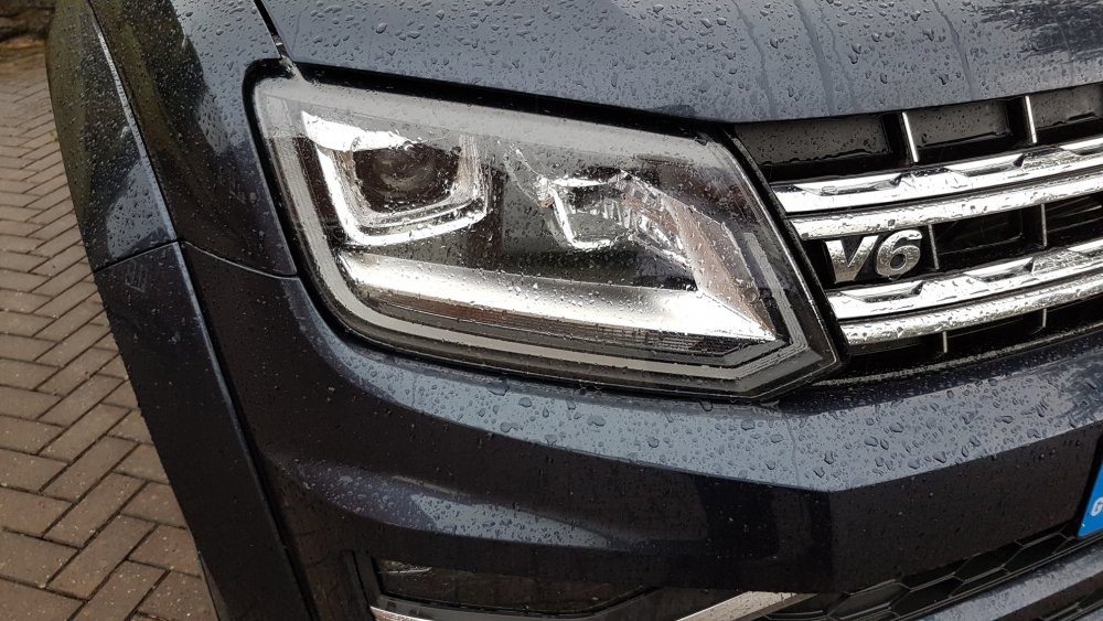

I'd also read that washers and self levelling were mandatory on vehicles with Xenon/HID/LED headlights, but I'm currently driving a demo VW Amarok Highline V6 TDI and it has no washers, and a levelling switch on the dash!
Could those by any chance be halogen headlights with a lense system? The high beam looks like a halogen one.
Lensed halogen mate.
Ahh that explains that then. Thought they were xenon but haven't actually driven it while dark, or taken much of a close look at the bulb etc.
Silly me :giggle:
They are normal projector halogen lamps with a little side light on the inner ones with cornering lamps built in. You do not get headlight height adjusters on Xenon or LED's.
By the law, until certain amount of Lumens washer and auto leveling are mandatory. It is not obligatory by the source type of the light, but the strength.
