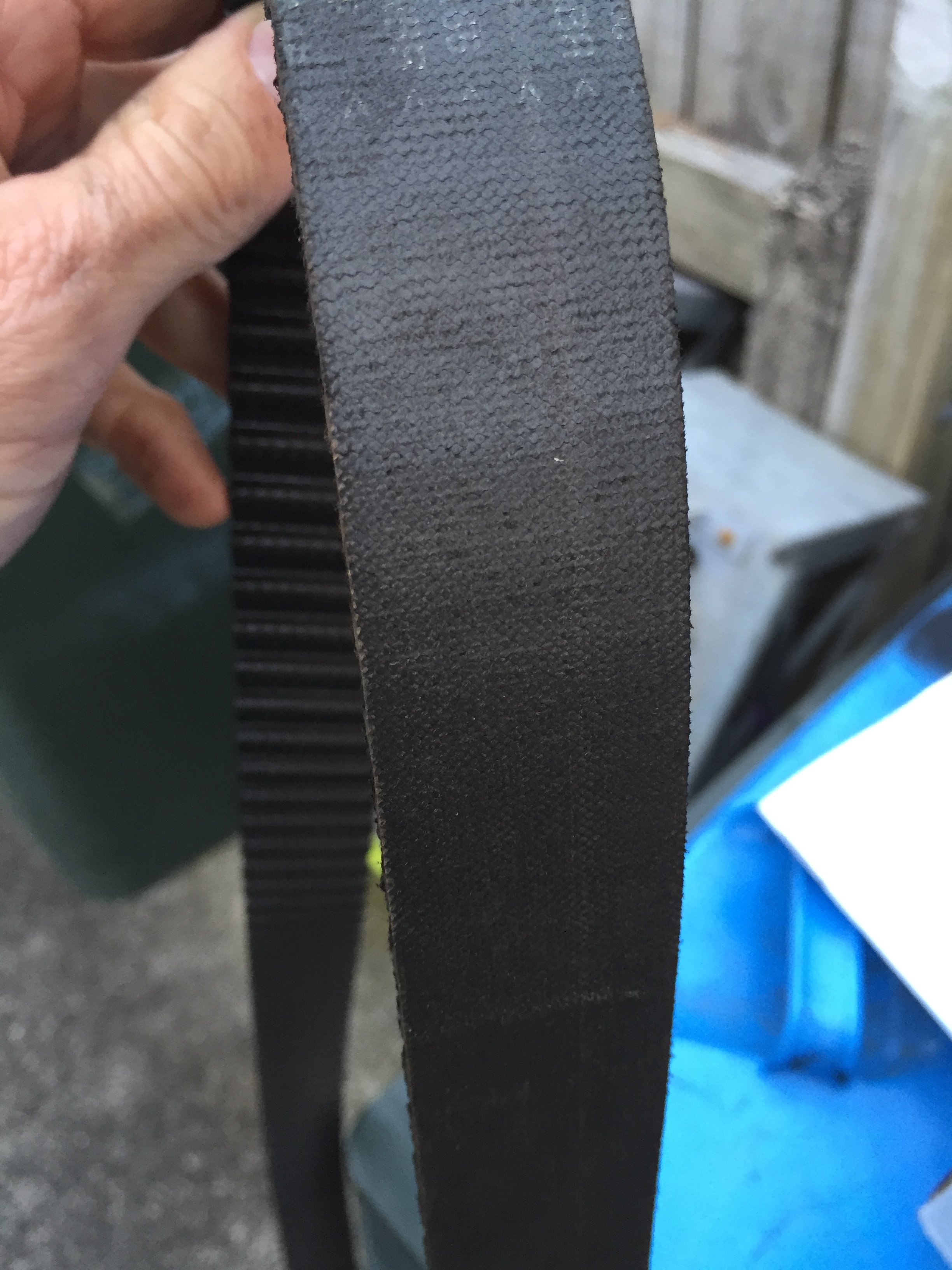

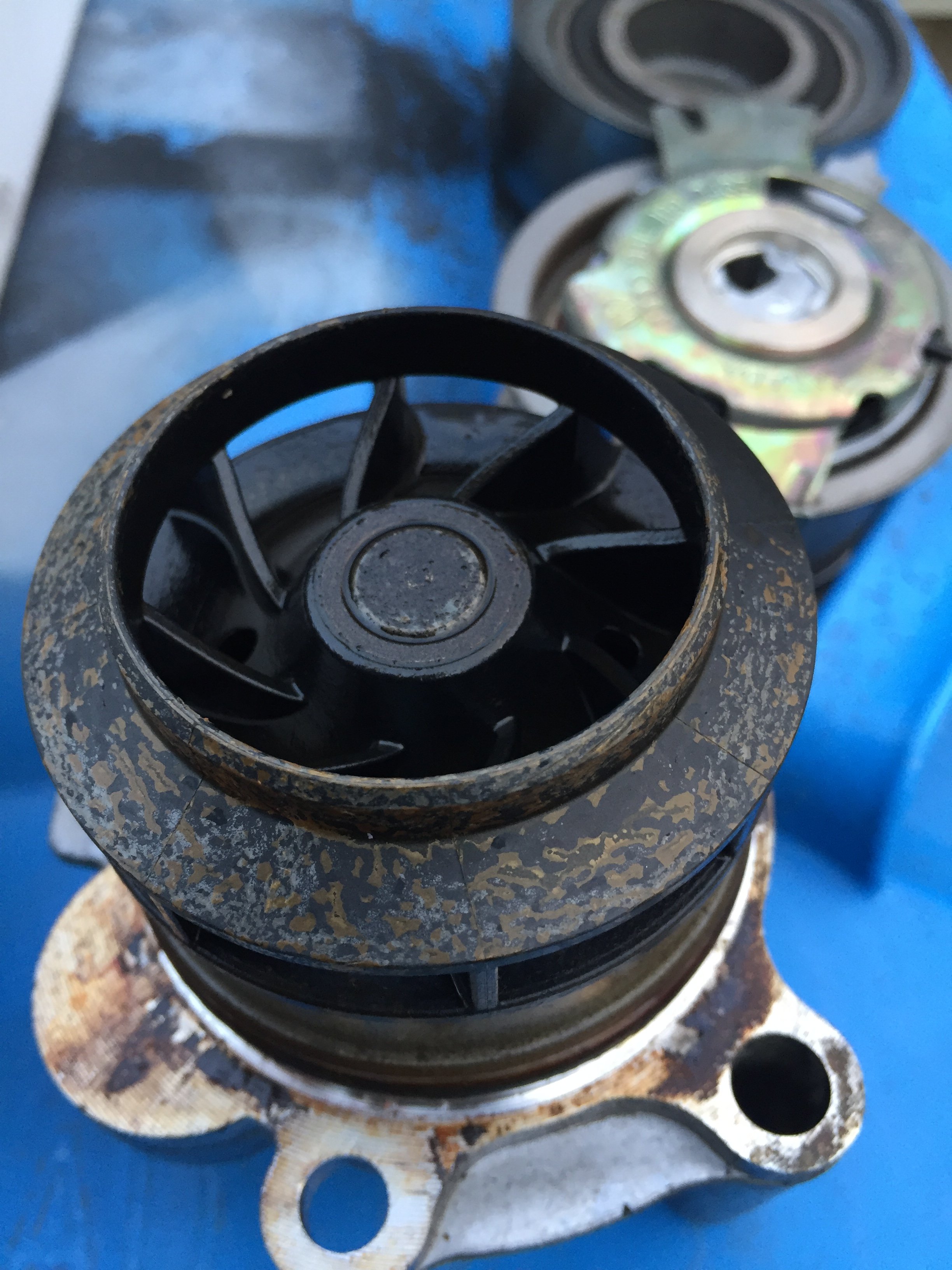

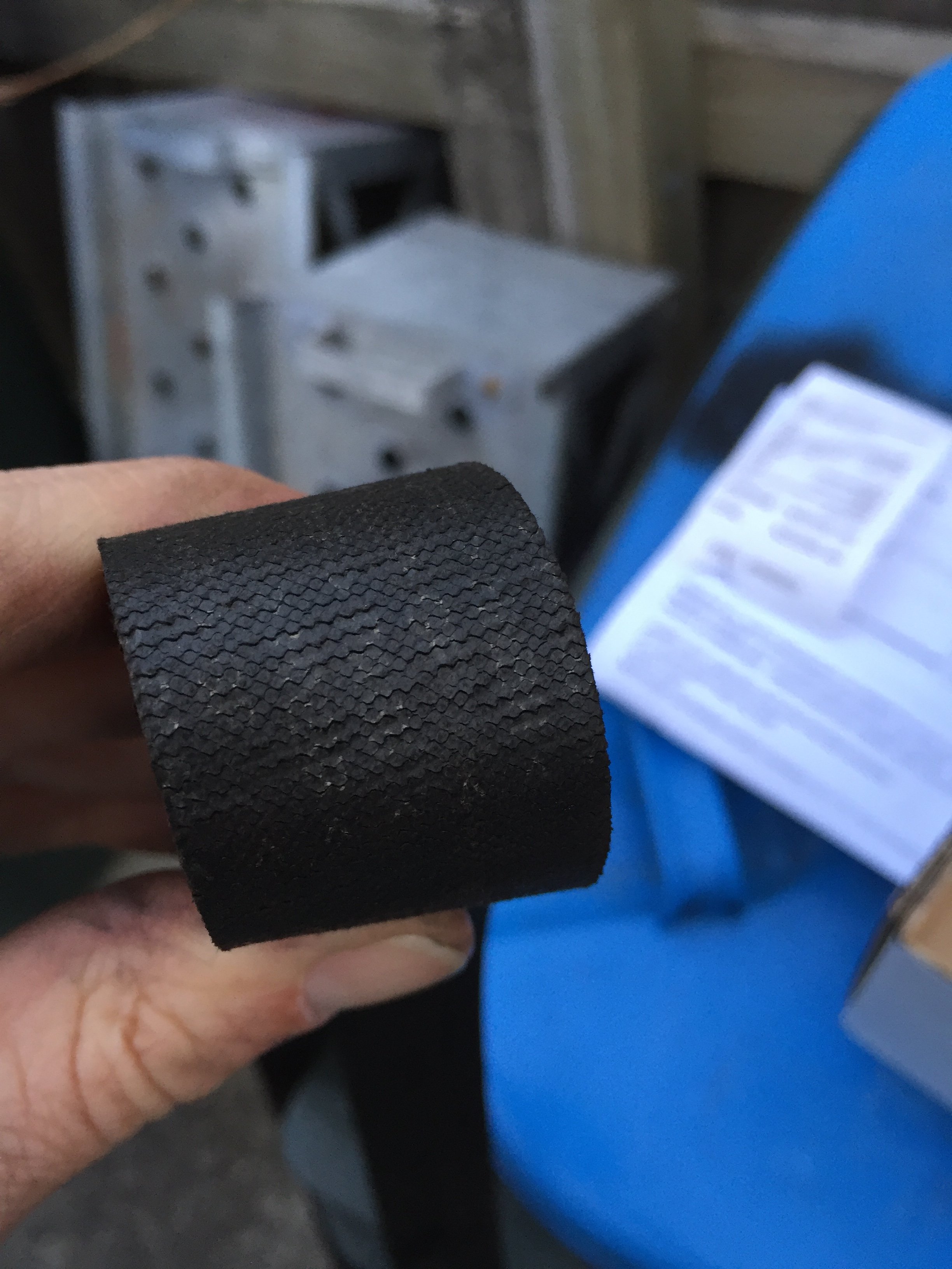

I will post a photo of the water pump and belt once complete as I am interested in their condition.

Cambelt changed (early according to Skoda NZ) yesterday at 7 years and 100,000 miles. Tensioner, guides/pulleys and bearings feel brand new. Belt condition up for debate, but mechanic said it looked good.
All of this is for your information only, I would not suggest varying from your importers recommended service schedule.
