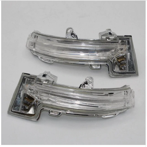

You’ll need a coding tool to get them going so you’ll be able to check the part numbers on that. I did and I still read mine wrong!!! There’s a good chance you’ll need door controllers to match the mirrors though. The swipy indicators I cannot wait for and they are plug and play, I’ll be dismantling the mirrors soon to fit the new LED modules for the puddle lights when they arrive so I’ll get a better feel for how they are held in. Apparently they are due on Boxing Day which I highly doubt but my experience of AliExpress is that they are conservative about shipping times. I guess they will be here in around 2 weeks or early in the new year.

I found them on Aliexpress quite easily, just type in Octavia wing mirror lights and it should come up, around £50

As above, I got them here
https://s.click.aliexpress.com/e/cDA5lBzrbut you could also get them on eBay for a variety of prices using the same list of images so I just went with the cheapest :)

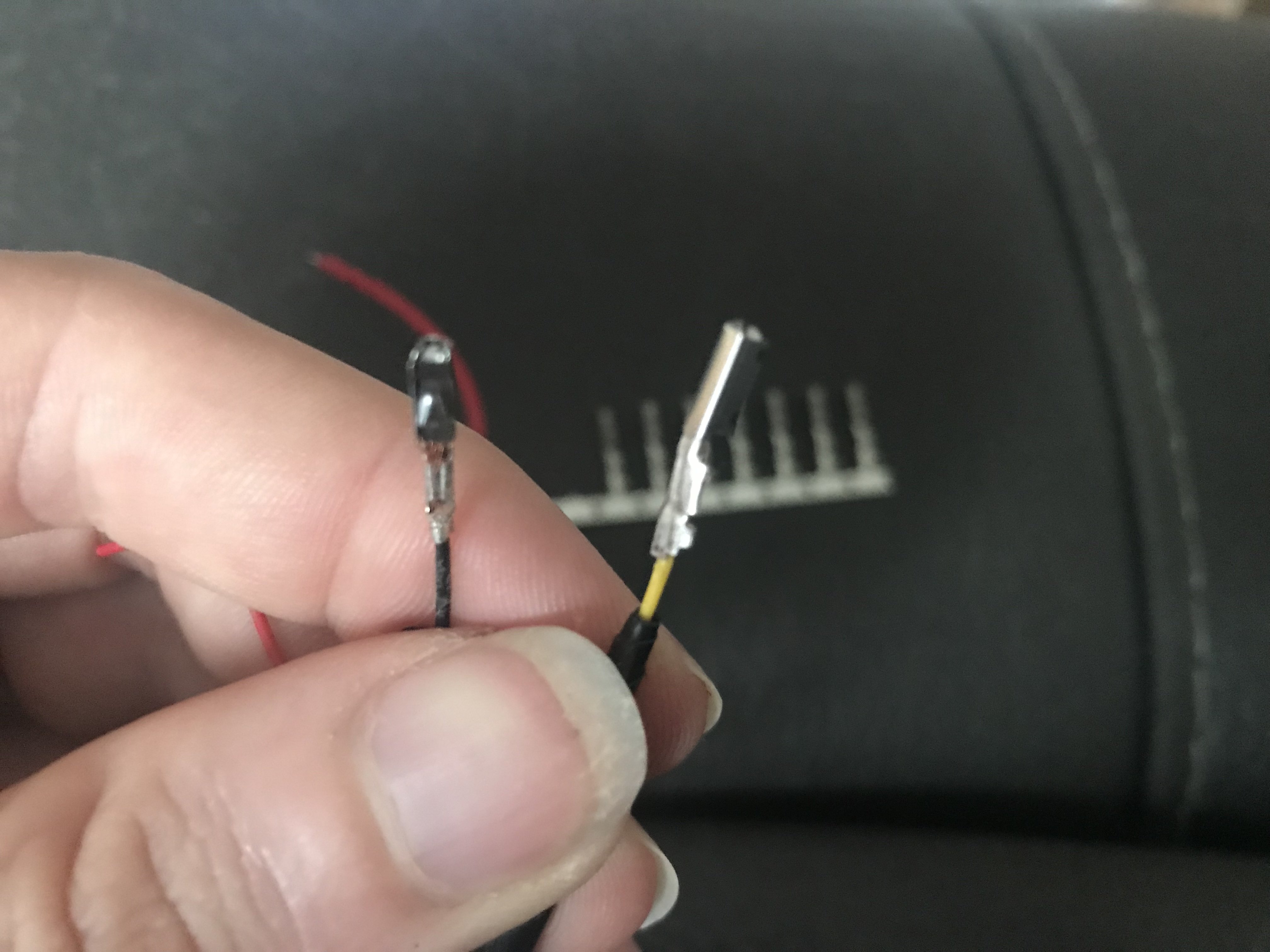

Forgot to post a picture of the video wiring loom...

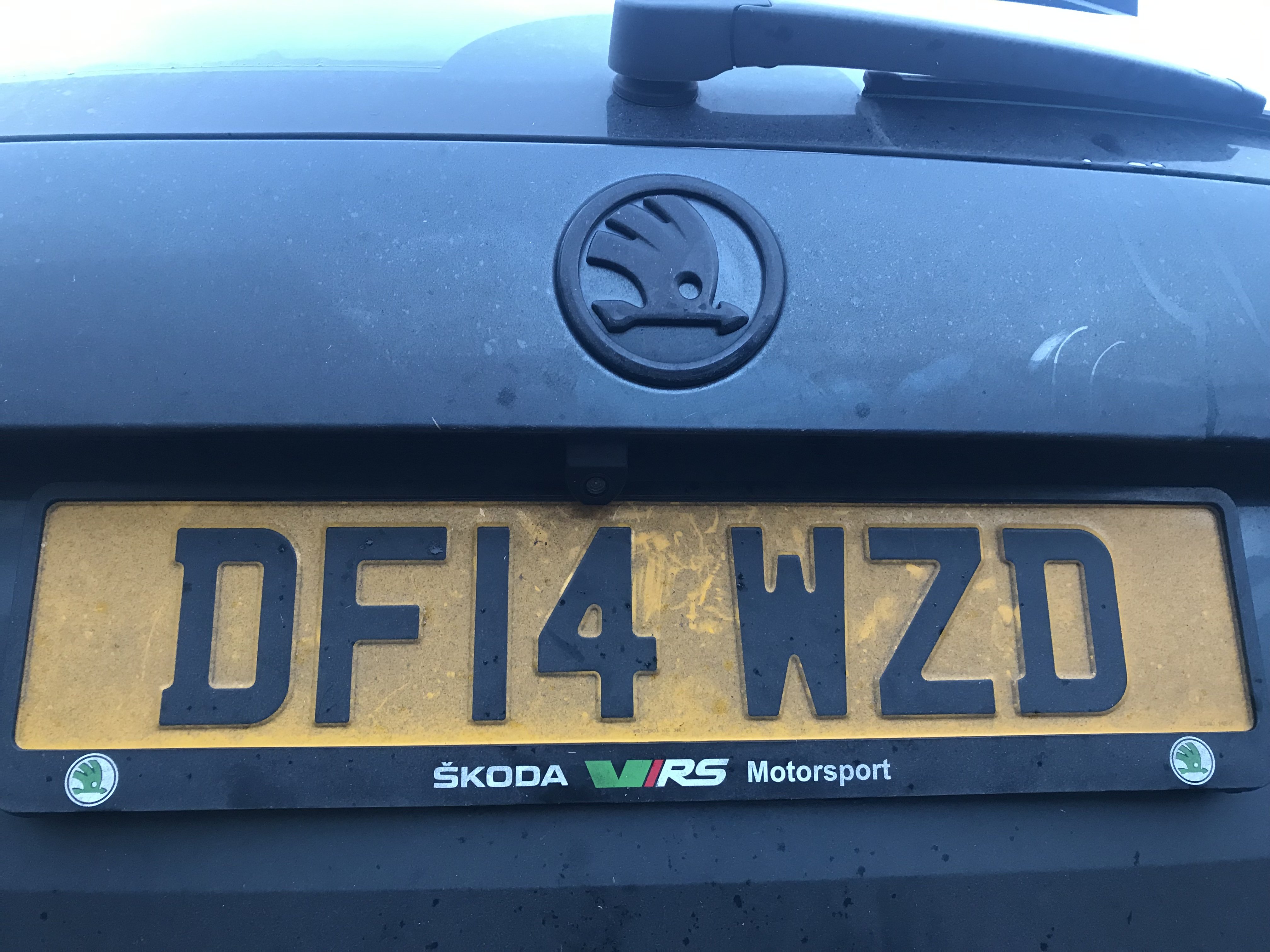

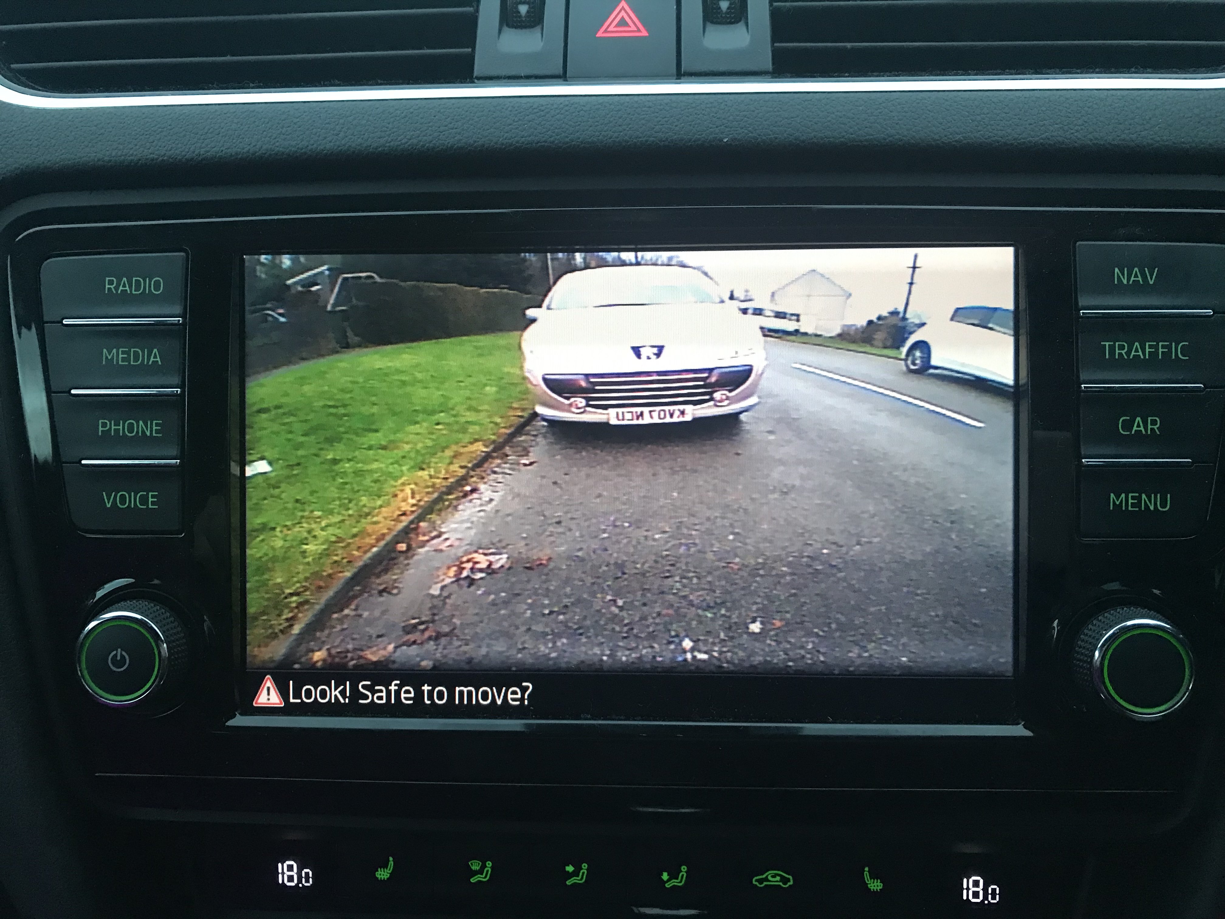

Finally!!! The sub £20 reverse camera install is complete. Shout out to my Dad who did the cable routing through the passenger side of the car for me today because he felt sorry for me with my broken thumb, all these mods, but only 9 working digits to do them with. This is quite an easy install and something that all UK spec cars at least are capable of running. You need a Bolero with BT or above (MIB1 or 2, doesn’t matter), some of these to connect the video feed to the radio quadlock after you’ve chopped the RCA plug end off https://rover.ebay.com/rover/0/0/0?mpre=https%3A%2F%2Fwww.ebay.co.uk%2Fulk%2Fitm%2F171641862721 and a camera which is NTSC, not a PAL one! That detail has held me up by 7 weeks on this install. If your car is Pre MY16, it should be a 92x35mm boot handle like mine so you’ll need a camera like mine if you don’t want to cut. It’s bigger than I wanted, but on my dark coloured car it’s still neat. I’ll link some cameras below. Pretty sure MY16 onward is 112x48mm so I’ll link one of them in too. Coding is simple, just 5F Infotainment > Long Coding > Byte 19 Enable Bit 4. I also found in 76 Park Pilot > Long Coding there is a setting to add a lowline reverse camera which I did and as you can see it all works really well :happy: The parking sensor display is usually on the left of the screen, and it all works like an OEM camera, except the camera I’ve ended up with (not the test camera from my Dad’s car) has no lines, but I don’t mind. I tapped into the rear wiper motor to power the camera, which is much easier than trying to power it from the rear lights. I’m very impressed with it so far. Here is a link to the type of camera I have https://s.click.aliexpress.com/e/bGNgICLB And here is a link to an MY16 sized camera :) https://s.click.aliexpress.com/e/sPzYJSt
Just noticed that the Peugeot shown on the screen shows the number plate reversed.  Is that just a quirk of the camera you've fitted or will it also show reversed on a factory fitted camera ?
That’s how it would be, and exactly the view you would have in the rear view mirror. It just sees what’s behind the car, doesn’t flip it over. So an Ambulance with Ambulance written in the backward writing would be shown correctly etc.
Just wondered.  Thanks for that :rolleyes:
Nice
Couple of quick questions, you say the parking sensor display is usually on the left hand side, does it not appear on this set up then as it’s missing from the pic you posted?
Also, I thought the point of connecting the power to the reverse light was so when you out the car in reverse, a signal is sent to the head unit to activate the camera. How does it know it’s in reverse?
sorry I’m a bit of a novice with these things
It is usually there, I just pressed the button to close it. If you move your hand toward the screen you can get it back again. Because of the radio coding, the car uses the rear parking sensors to tell when it’s in reverse. A great system :)
Ah, that’s great thanks, next on list then.
The Car knowing it is in reverse has nothing to do with Rear Parking Sensors. Direct from the Gear Selector.
Yes it does, mine was a poor explanation, my point is that it relies on the sensors working to switch the camera on. I know this because I had to fix the damn sensors before the camera would come on. No sensors equals no camera on this car. There must be a way around that for cars that don’t have parking sensors, but that was how the cookie crumbled on this car.

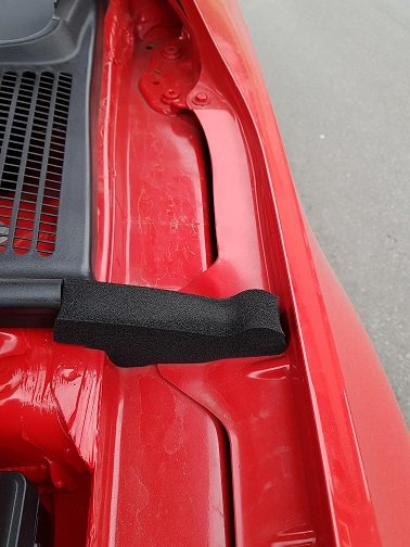

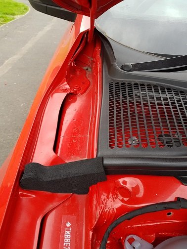

So, I was about to look at fitting the gas struts I picked up a little while ago - I'd been waiting for the socket I required to remove all of the screws.
Anyway, popped the hood and I found these two pieces of foam under the bonnet
These are going to be in the way of the struts. They do just appear to be stuck down and there is no indication they are covering anything.
So, firstly, any idea why these have materialised on later models?
Any suggestion what they might be doing and reasons for me to leave well alone and not bother with the gas struts? :)
I installed gas struts on mine and left the foam in situ. Doesn't seem to have had any averse effects when I had the bonnet up the other day.
