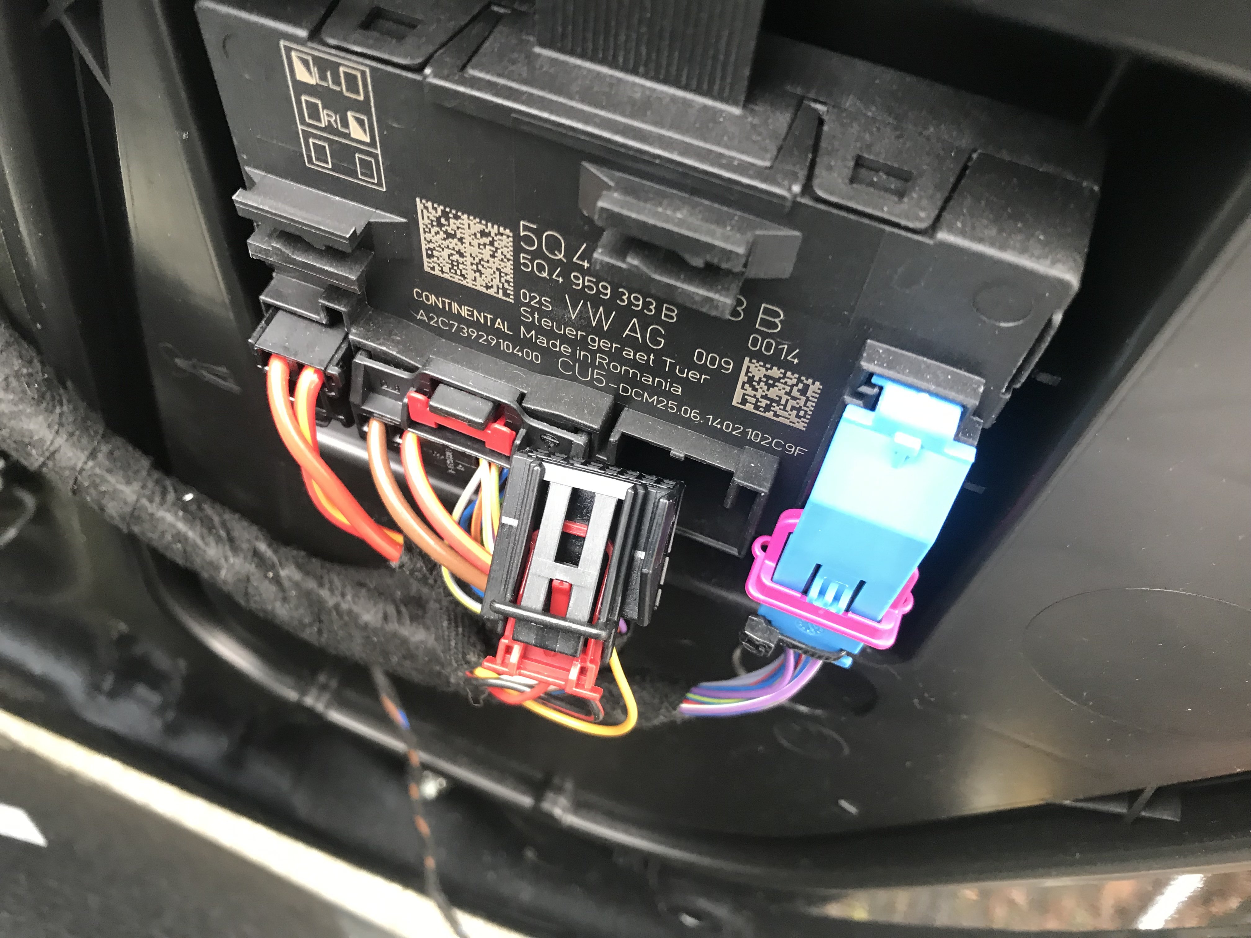

Getting these sorted first haha, hopefully the new door controllers will be here by the weekend.

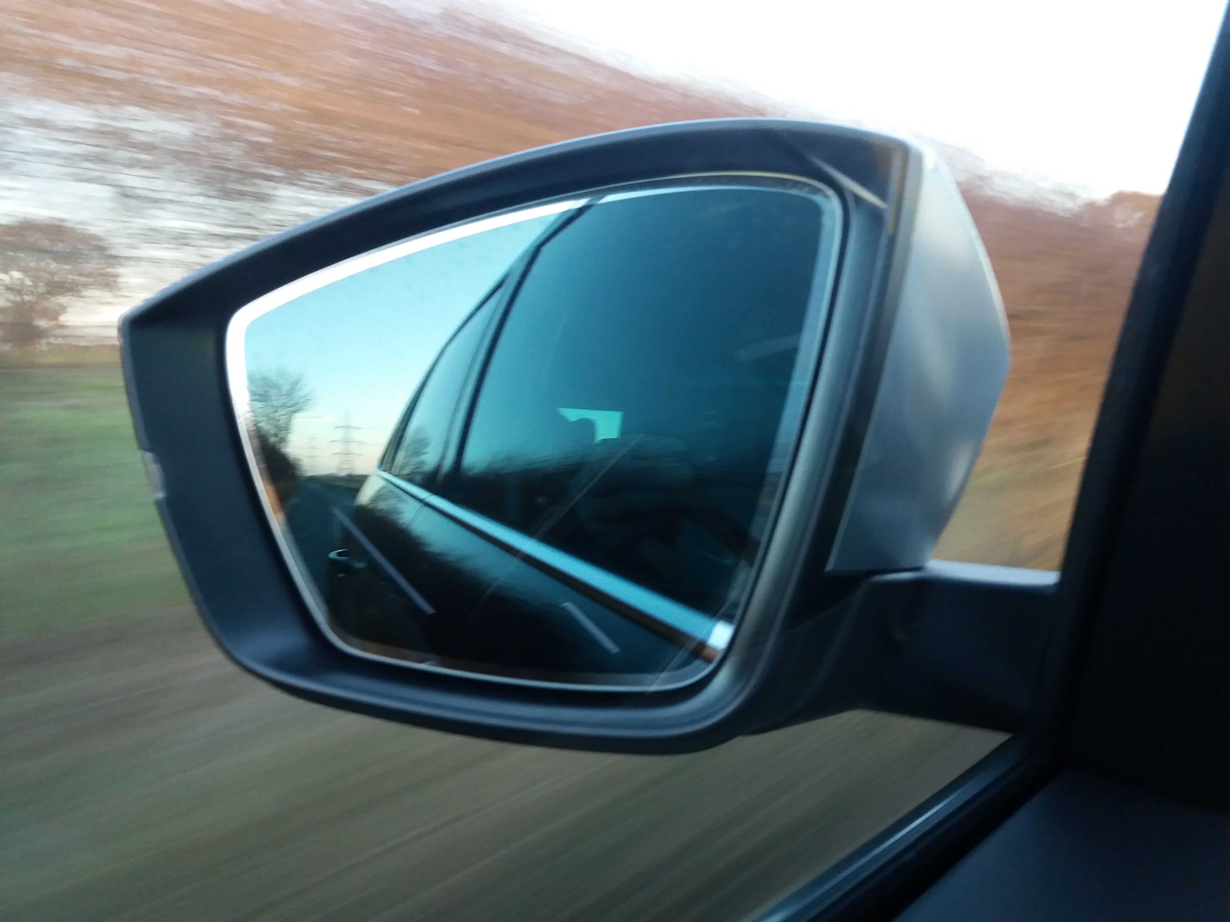

Great job. Are they autodimming or is that another mod you're working on? I think this is one of the best value options, particularly useful at this time of year.
They are supposed to be autodimming I think, but they don’t look like the ones on my Mercedes. Pretty sure they should be autodimming as that came with the folding option iirc but I’m not sure how accurate that info is.
There should be a thin black line that goes around the edge of the glass for autodimming.

Thanks. I hope it’ll all be sorted when they arrive. Doing half this work again and changing the controllers isn’t the issue for me, it’s making sure everything in the doors work again when I’m done!!

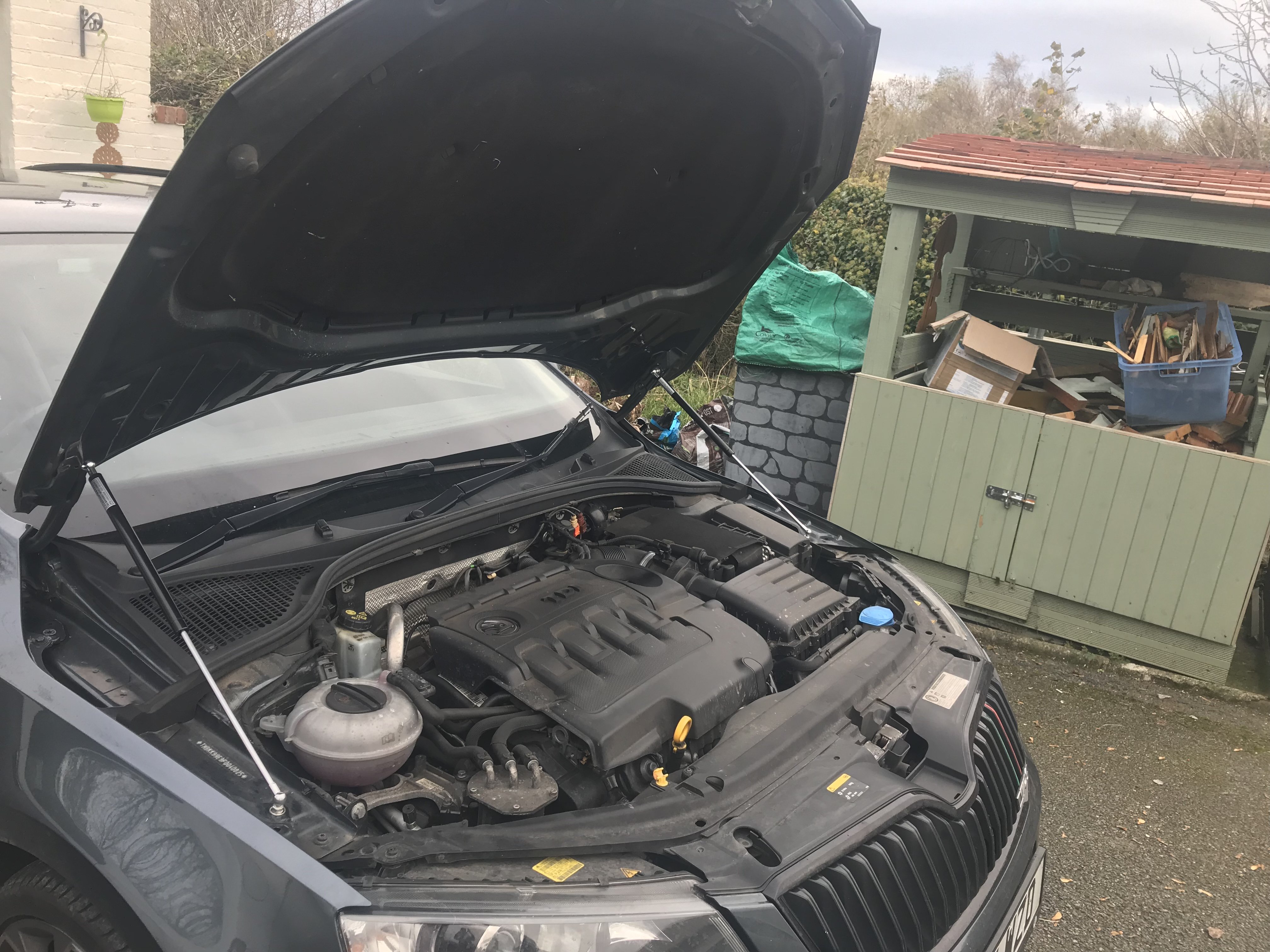

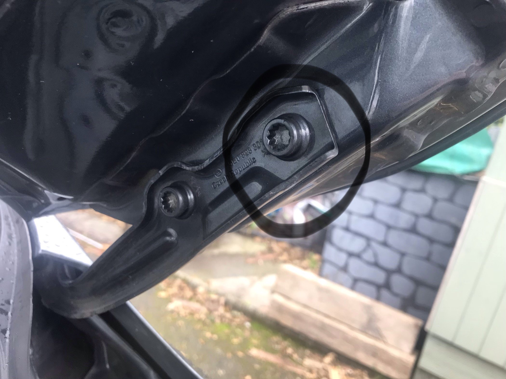

I have always hated the stupid stick that originally held the bonnet up and a set of gas struts have been on the cards for a while now but I could never justify £40 for them from SuperSkoda. I was recommended this set from eBay for £7.50 that do the job just as well. They are a little longer than the ones from SuperSkoda but they work really well as you can see.
They lift the bonnet well too :)
They take only minutes to fit once you have a 10mm socket to remove the ring bolts and an M10 spline tool to remove the bolt that holds the bonnet hinge on. Much better than the stupid stick!!
Link here https://rover.ebay.com/rover/0/0/0?mpre=https%3A%2F%2Fwww.ebay.co.uk%2Fulk%2Fitm%2F192589481940
Price is now £8.58 but still worth it :D
Great job, how easy are they to fit? I've not taken a look at the fixing locations yet but is there much work required to get these to fit etc?
They are very easy to fit, you’ll need a 10 mm spline tool to remove the bonnet hinge fixing and I think the wing bolt is requires a 10mm socket. The new ball joints in this kit use a 12 mm fixing so you’ll need a 12 mm spanner. The wing bolts are M6 thread and the bonnet bolts are M8 thread. It’s great to have a helper to hold the bonnet open while you are doing it, but it’s possible to do it by yourself :)
Thanks!

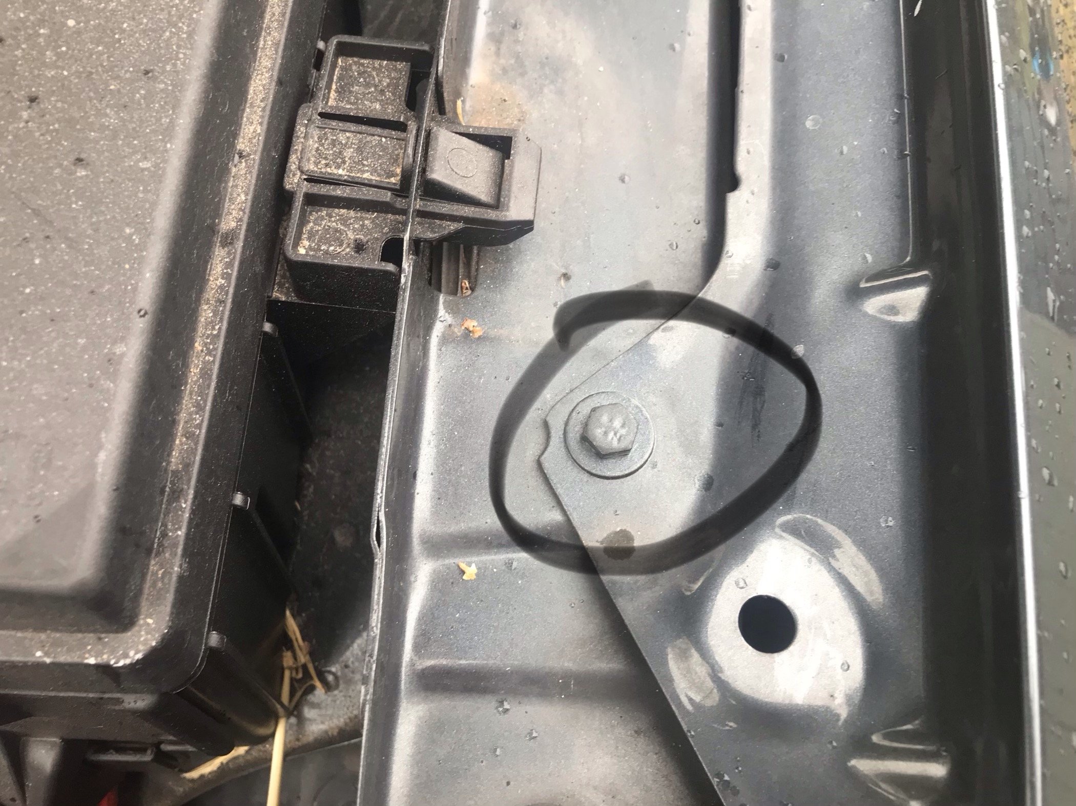

So you need to remove the top hinge fitting and replace this with the top of the gas strut.
Then I notice there is a hole on the inside of the wing where the bottom fixing of the gas strut would go.  Thats the two mounting holes?
Cheers!
The 2 fixings circled need replacing with ball joints :)
In case it helps, this is what the auto-dimming door mirror glass looks like, pictured here on a Kodiaq...
By the look of it these ones aren’t auto dimming which is a bit of a shame, but I really wanted the power folding so that’s ok. It also means if I break a glass removing one this weekend for the LED modules then I have a spare!

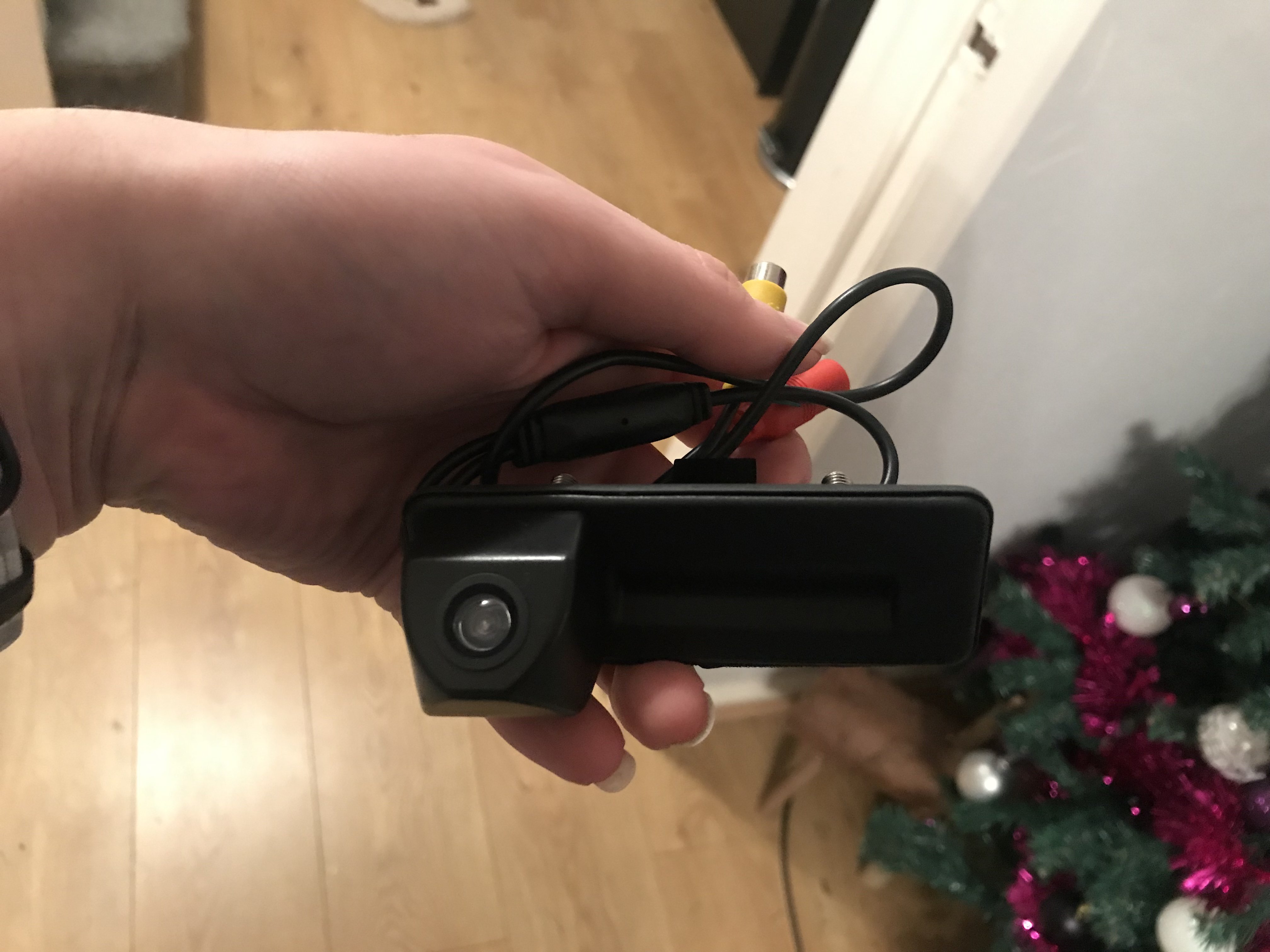

Camera as finally arrived!!

I wish I'd ticked the camera option so I can't wait to see the results

#Sasha - Do you know if those bonnet struts are available on Amazon? Cant seem to find them ;O
Also.. Where did you get the reverse camera?
