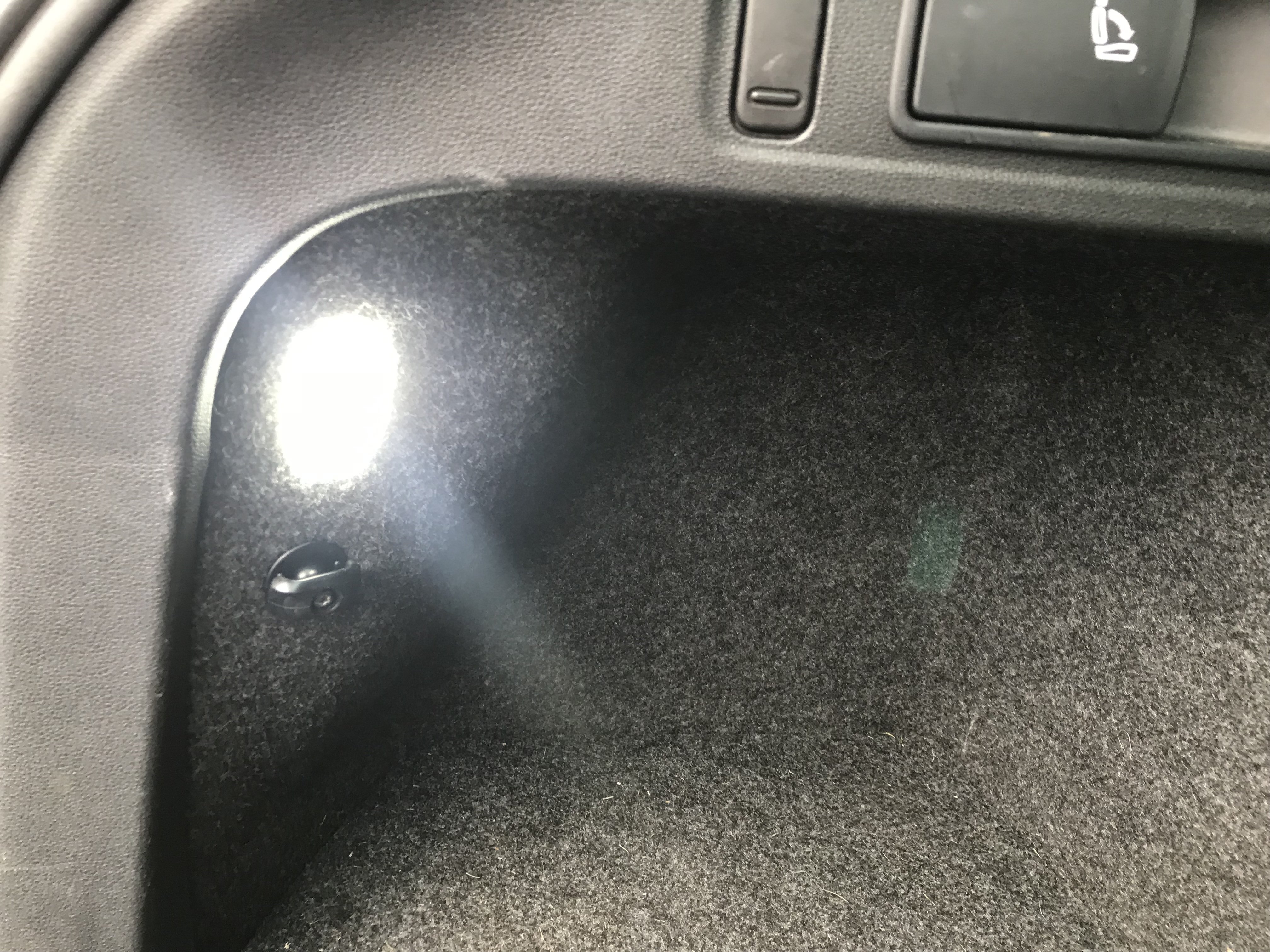

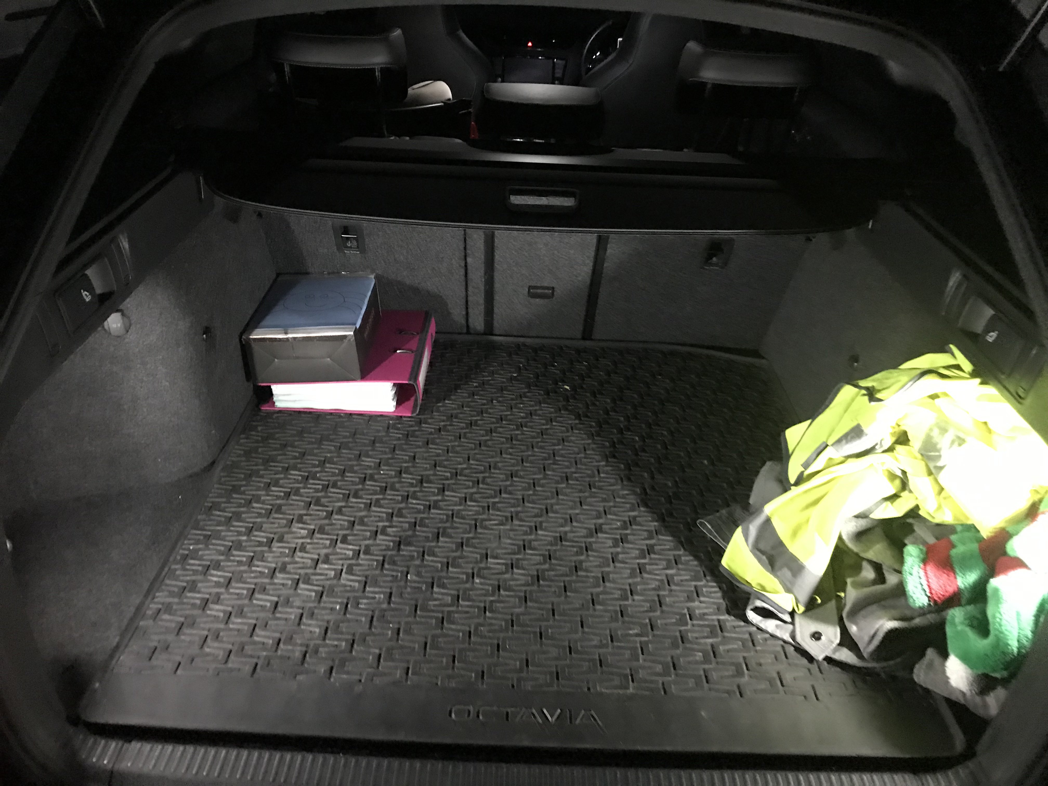

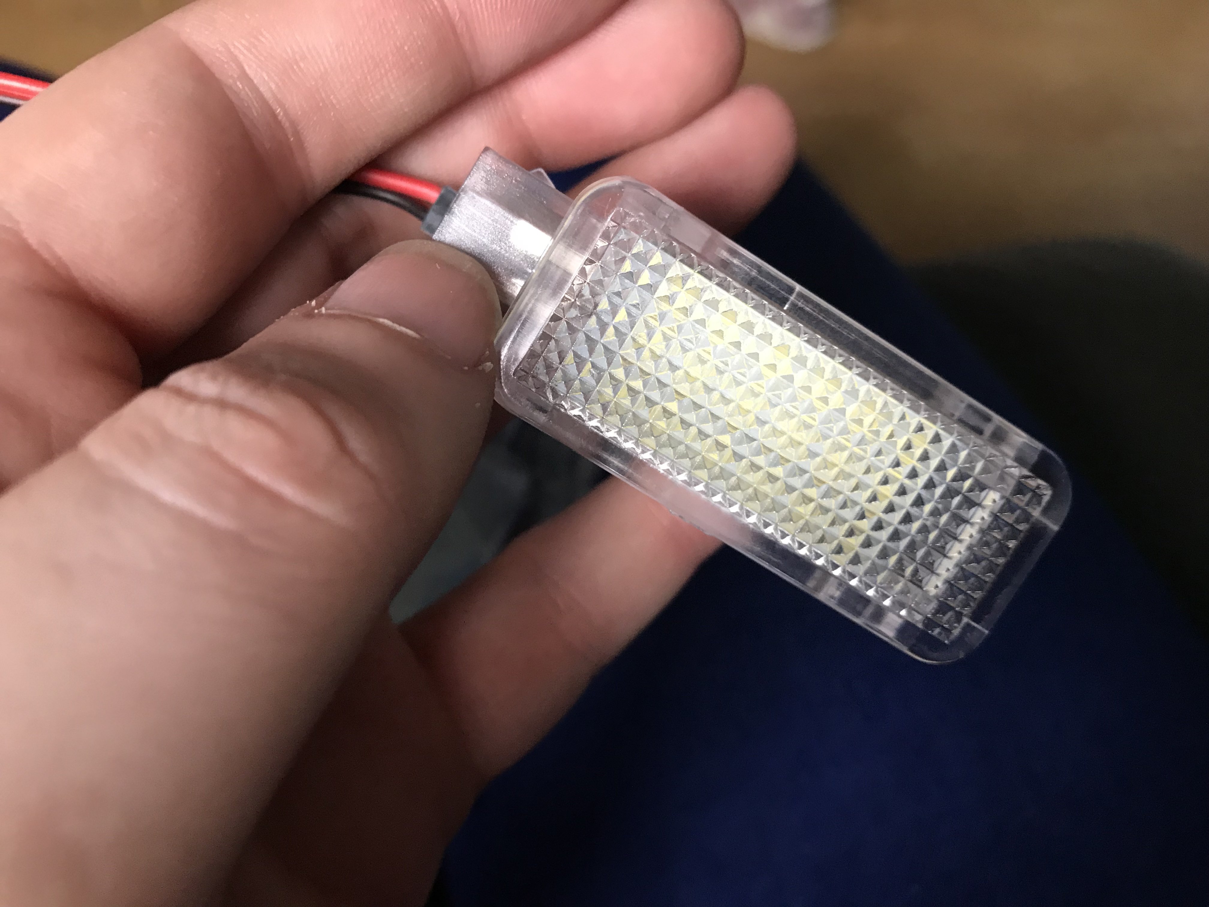

I always hated the boot lights on this car and putting LED’s in the original holders wasn’t doing it for me so I invested in £6.50’s worth of China’s finest LED panel boot lights and they are great! Don’t be fooled by the wiring loom, just unplug that and plug the OEM loom into the other socket then reinstall into the boot panel. Lovely :)
Link https://s.click.aliexpress.com/e/ceXaT9rj
Nooooooooooooo. I was debating getting these or just some LED bulbs. I ended up getting these LEDs. I hope I don't end up regretting it!
Fingers crossed they work how you want, but if they don’t, at least you know that these do :)
I fitted the same a while back, at the same time I swapped the interior bulbs for some Osram LEDs, they do give a nice bright clean white light. As the FL has nice white puddle lighting already the only annoyance i have now ancillary lighting wise is the yellow staring back at me from the torch in the boot, wonder if there's an easy way to change that for white.
Edited by uchuff
That would be awesome to know! Part of me really wants to retrofit the torch but it’ll be more trouble than it’s worth.
