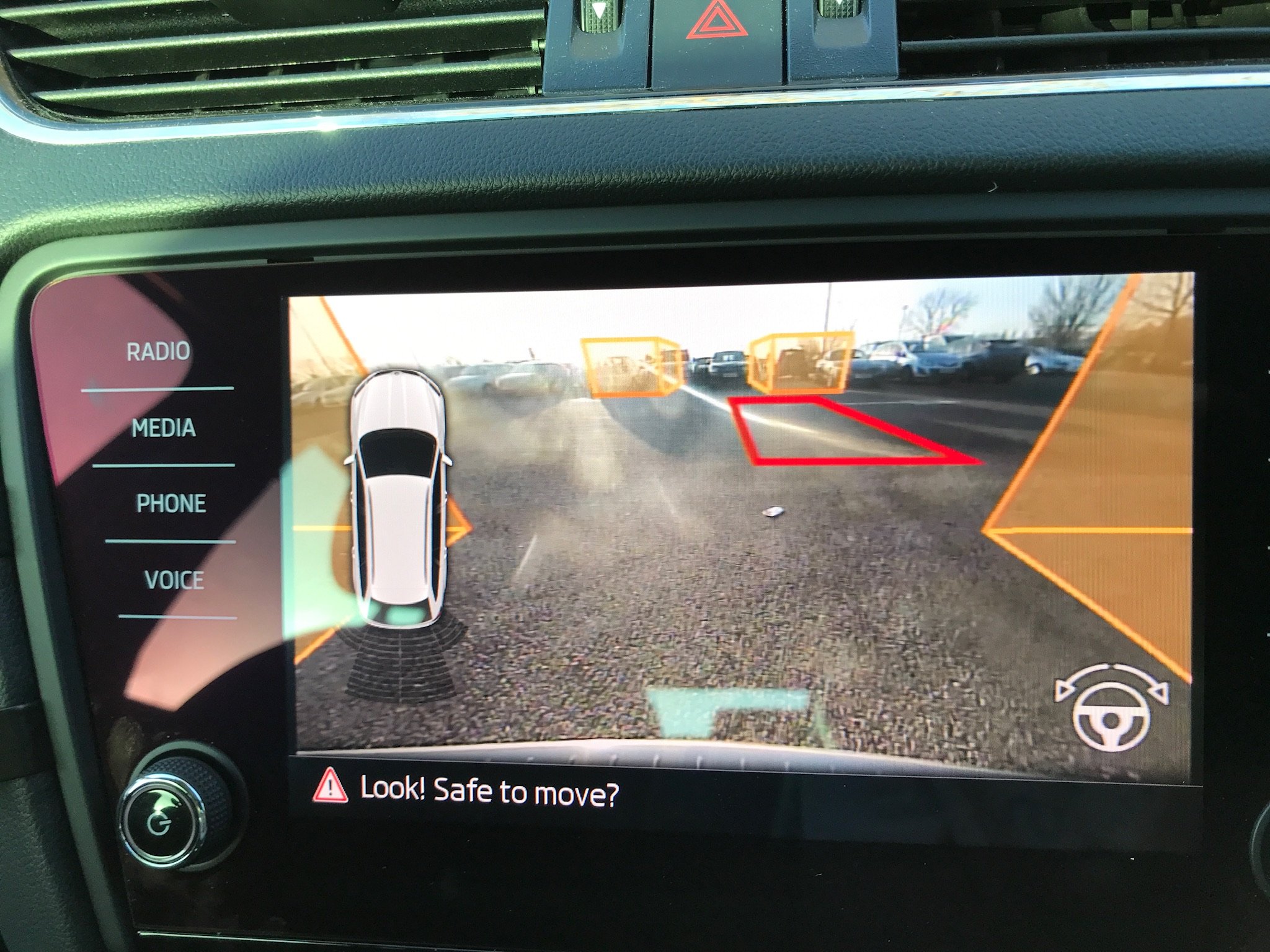

Finally!!! The sub £20 reverse camera install is complete. Shout out to my Dad who did the cable routing through the passenger side of the car for me today because he felt sorry for me with my broken thumb, all these mods, but only 9 working digits to do them with. This is quite an easy install and something that all UK spec cars at least are capable of running. You need a Bolero with BT or above (MIB1 or 2, doesn’t matter), some of these to connect the video feed to the radio quadlock after you’ve chopped the RCA plug end off https://rover.ebay.com/rover/0/0/0?mpre=https%3A%2F%2Fwww.ebay.co.uk%2Fulk%2Fitm%2F171641862721 and a camera which is NTSC, not a PAL one! That detail has held me up by 7 weeks on this install. If your car is Pre MY16, it should be a 92x35mm boot handle like mine so you’ll need a camera like mine if you don’t want to cut. It’s bigger than I wanted, but on my dark coloured car it’s still neat. I’ll link some cameras below. Pretty sure MY16 onward is 112x48mm so I’ll link one of them in too. Coding is simple, just 5F Infotainment > Long Coding > Byte 19 Enable Bit 4. I also found in 76 Park Pilot > Long Coding there is a setting to add a lowline reverse camera which I did and as you can see it all works really well :happy: The parking sensor display is usually on the left of the screen, and it all works like an OEM camera, except the camera I’ve ended up with (not the test camera from my Dad’s car) has no lines, but I don’t mind. I tapped into the rear wiper motor to power the camera, which is much easier than trying to power it from the rear lights. I’m very impressed with it so far. Here is a link to the type of camera I have https://s.click.aliexpress.com/e/bGNgICLB And here is a link to an MY16 sized camera :) https://s.click.aliexpress.com/e/sPzYJSt
Just for the record after failed attempts with an OEM camera which had no end of line programming  from https://www.cars-equipment.com/. On another point dont use them i spent months trying to get a response until my credit card company refunded me then they were all over me hence i had a refund and their camera is still in fitted to the car. I am looking at this as an alternative but the camera you mention for the MY 16 is not correct in the link . The size and everything is right but it has no side or top clips to keep it in place unless you find a suitable adhesive.  This is the correct one https://www.aliexpress.com/snapshot/0.html?spm=a2g0s.9042647.6.2.7eda4c4dkdCzxz&orderId=508341794444648&productId=32964548434 i only realised as my original handle is out of the car and identical without those silly threaded bolt fixings . Just to save anyone wasting money .
Before you go getting another camera, see if you can find someone local to you with VCP (Vag Can Pro). I had exactly the same problem regarding the programming having bought from cars-equipment. VCP is able to load the programming to the camera.
I did think about that but it needs calibrating as well and by the time I mess about I might as well spend 20 quid and use the original wiring. The camera I have at the moment didn't cost anything in the end. Cars equipment didn't even respond to my credit card provider within 60 days so it was refunded and I had a letter from Nationwide saying I can dispose of the faulty goods.

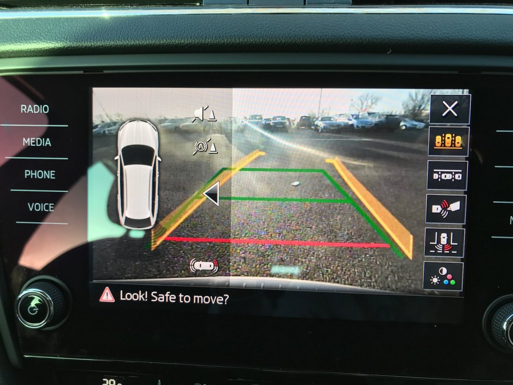

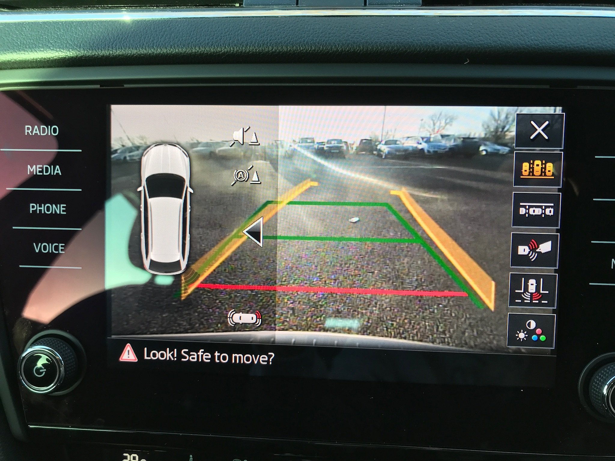

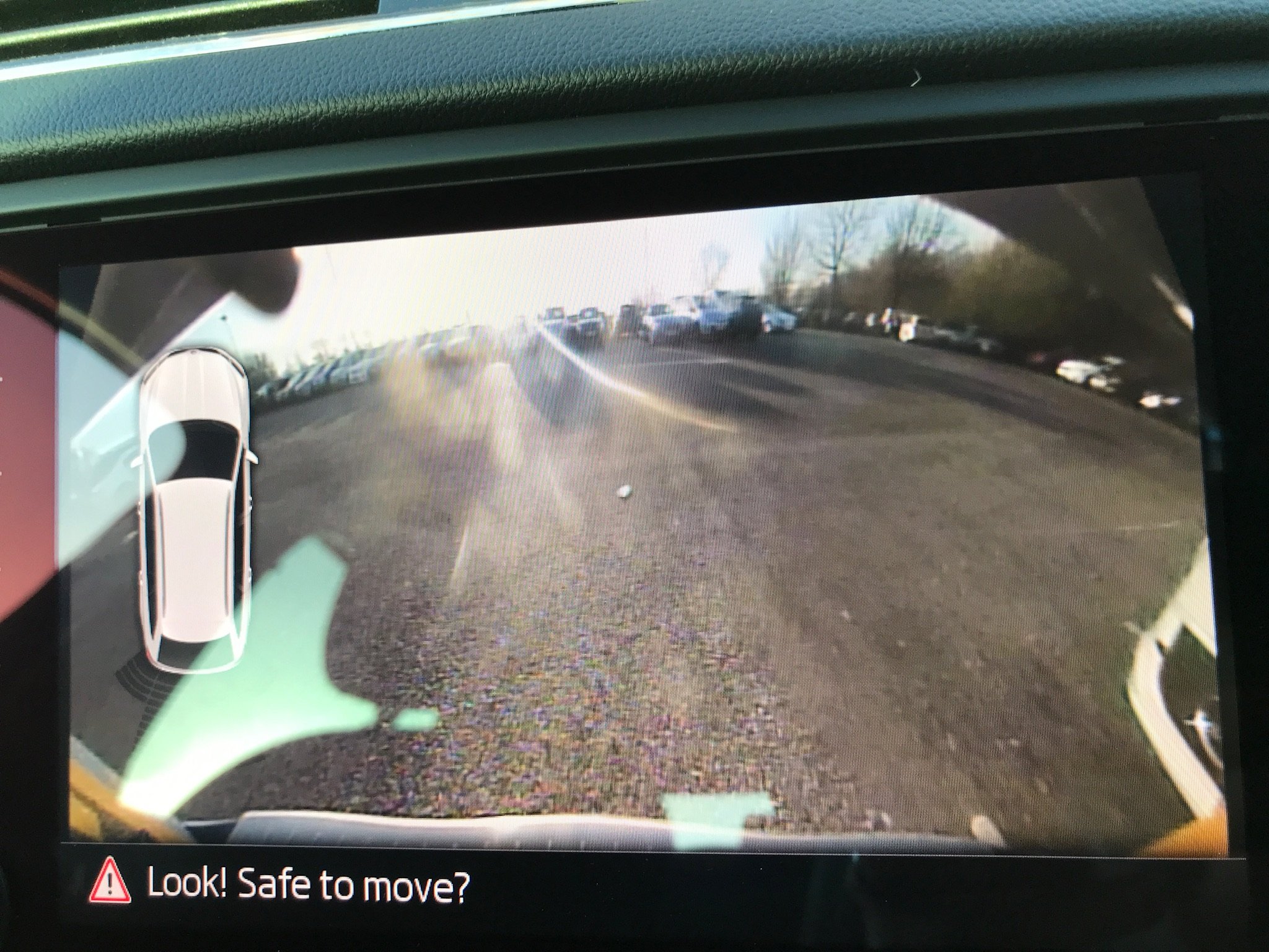

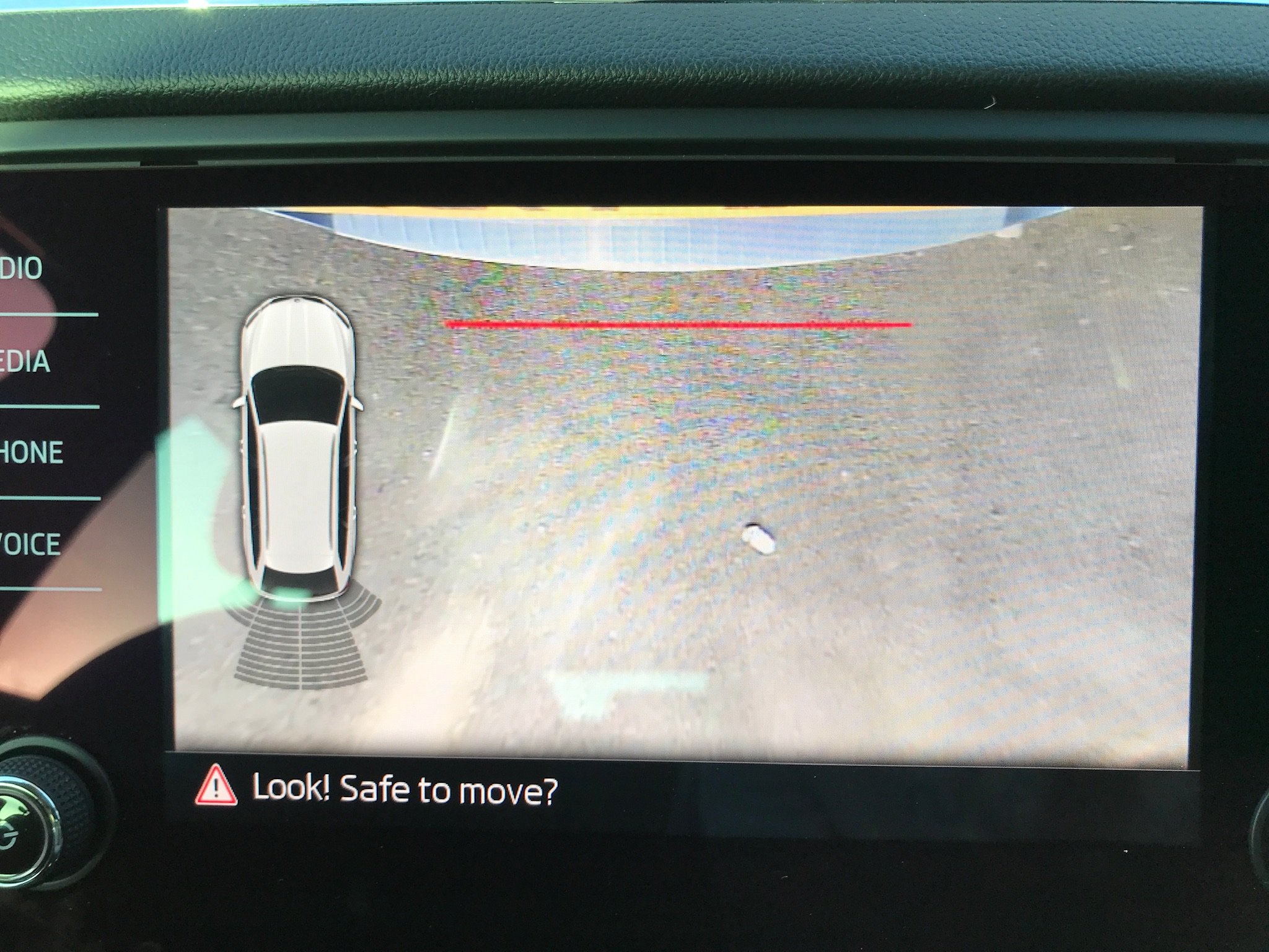

I didn’t bother with the calibration and it works perfectly, with moving lines, etc. You’ll get a lot more functionality out of the OEM camera if you can get it working.
Normal reversing view.
Parallel parking guidance.
Trailer hookup view
Fisheye view for backing out of a parking space.
Edited by wg100
Trailer hookup view
Looks good Was it easy to do with vcp I've seen a lot on eBay etc but never used it as I have vcds. There was quite a few comments on Ross techs site when I posted about the end of line programming and someone mentioned that no coincidence that car equipment and skoda both being in Prague possibly coming from source hence no programming .
I really need to get to writing my how-to guide!
The guy I found with VCP had done a bit of research into what had to be done. The process was actually quite simple. Once the initial programming is loaded, the coding can be done.
Ive had the camera installed for over a year now and not working as id lost all interest . I had seen so many people with the same issue its just finding someone with VCP and the know how . Its all correctly wired up just needs the camera flashing . Did you end up getting yours refunded .
