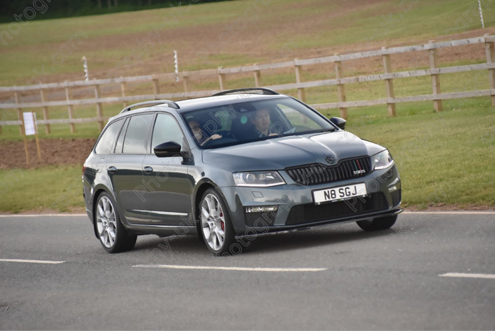

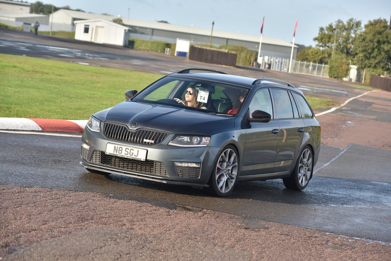

I have to say Sasha it's looking really well on the track 👍 😁
I guess you noticed a bit of a difference now from when you took it round Donnington track?
Deffo! It looks a much better height now and although it’s a bit down on power compared to a TSI it can handle the track as it will brake late and corner flat.
