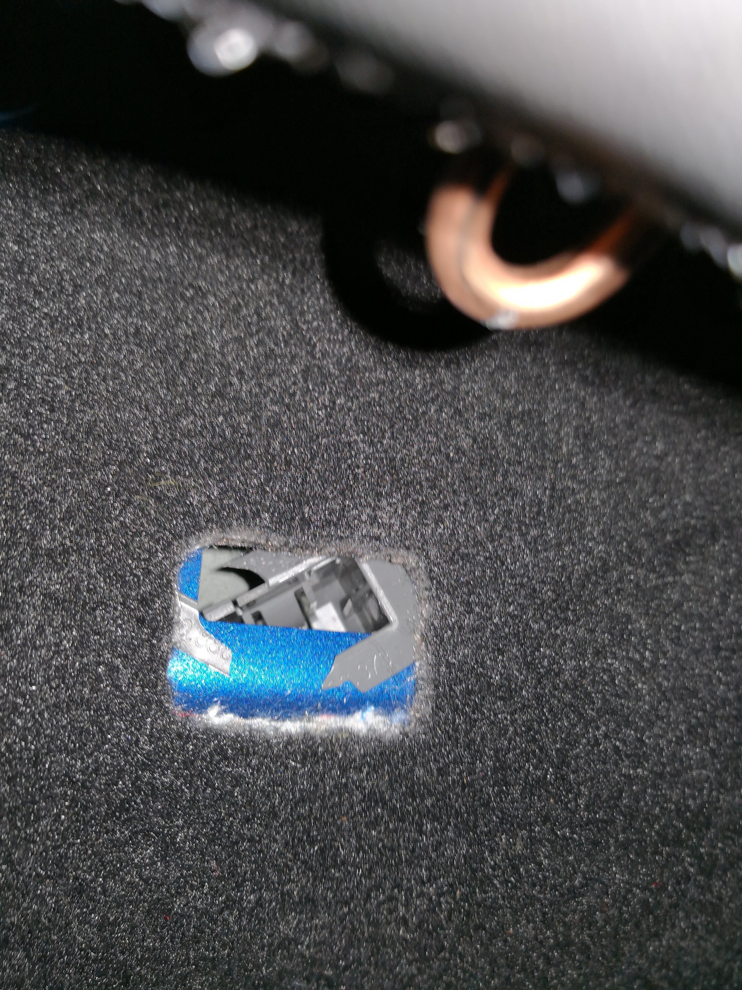

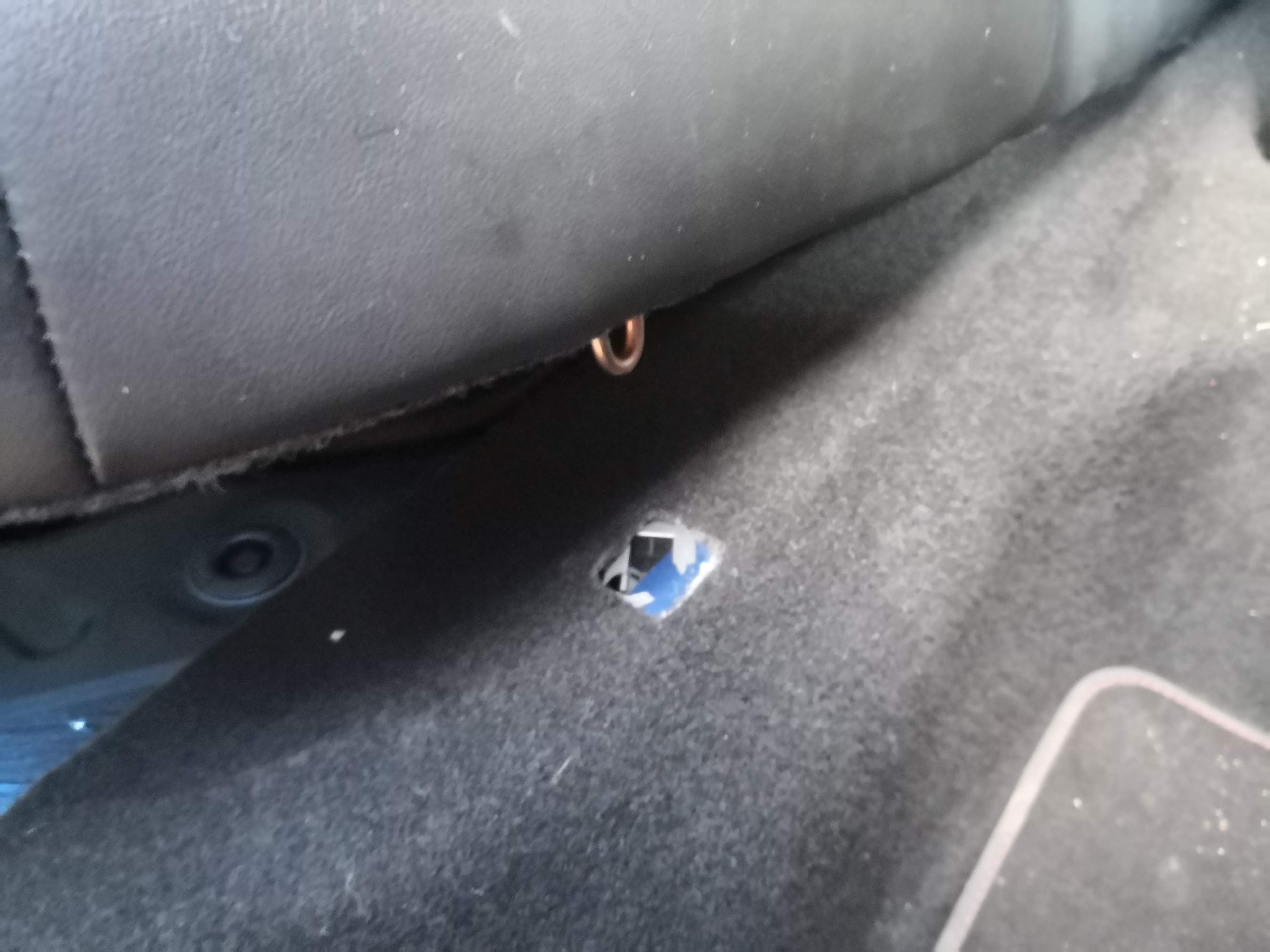

Ok so was vacuuming my vRS today and noticed that the rear seat behind the drivers seat was lose!, im able to lift it up slightly and upon further inspection it looks like either the a clip or retaining bolt that secures the lower part of the seat in place has either snapped or come undone.....
has anyone else come across this before?
I did have the car in for an annual  service yesterday but cant think it would have been something they did if this bolt/clip is even accessible from the under side of the car?, the last time i actually vacuumed the car was back in June time so its been a good while and might have been like this for a lot longer and ive just not realised!?
Edited by BlockABoots
Should be a big plastic clip in there that holds the base in.
5G0 886 373 is the part number for the clip if you need it
Ah so looks like the plastic clips has snapped then
thanks!, is it just a case of removing the broke clip housing and just inserting the new clip....all this can be done from inside the car (no need to go on the underside?)
Im still not sure how it got broken to be fair...very odd
Yes that clip just snaps into the hole from inside the car . Google the part number you'll see a picture of it.

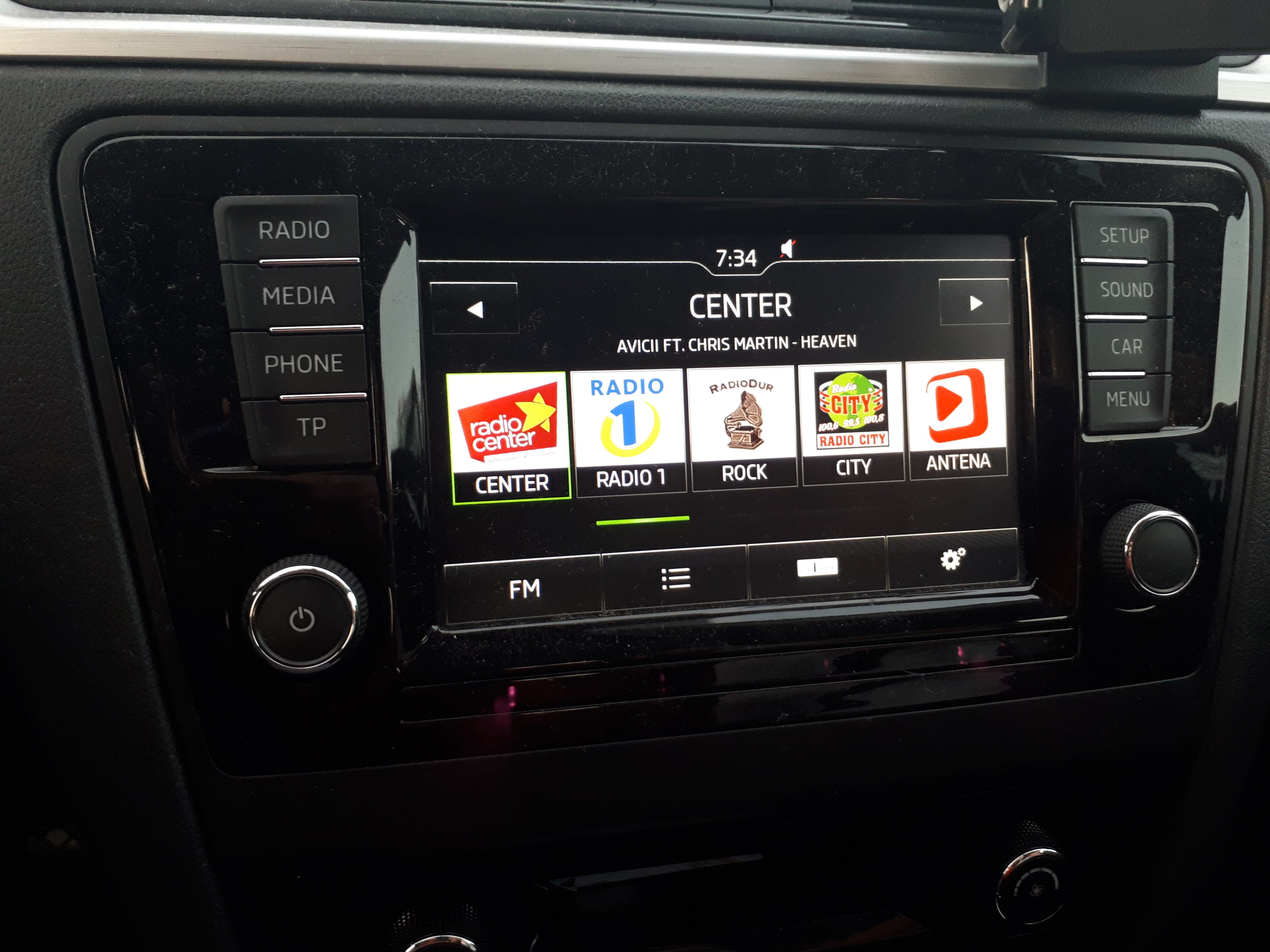

And do you maybe know how is done this way around? I have done 5F Infotainment > Long Coding > Byte 19 Enable Bit 4 and realised that camera still do not work. Because of missing park sensors ;(
I’ve done this on other cars with no standard sensors and it worked, what radio do you have?
Hello,
I have Bolero in my Skoda Rapid MY 2015
Do you have a BT and VOICE button? You need the voice button otherwise this feature is not supported.
Hello,
I have bluetooth (for phone) button on steering wheel. I also have voice control button on steering wheel but when I press it, it says ˝voice control not available˝
On 25/11/2019 at 07:35, Max46 said:
Hello,
What about on the radio? Can you put up a picture of the radio screen?
This is radio that I have
From experience these radios don’t work with the camera, you need one that says Voice where yours says TP unfortunately.
