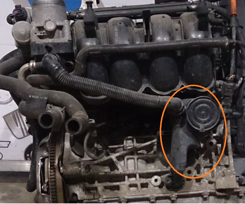

Does this engine have the oil seperator / breather module on the back of the engine?

Yes mate, circled in orange here. Corrugated pipe is the outlet up to inlet manifold. Only breather-related pipe going to the airbox is the thin one on the (RHD) passenger side which is a fresh air inlet pipe (with non-return valve at the point it enters the cam cover).

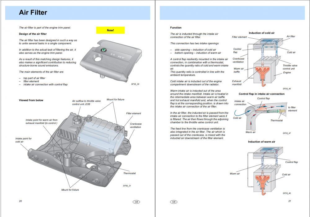

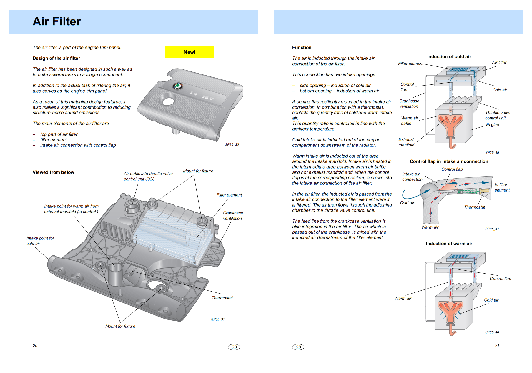

Inside the air intake housing on top of the AUA/AUB/BBY/BBZ et al engines, there's a thermostatically controlled flap which diverts fresh air (ambient air) or warm air (from exhaust manifold) depending on external temperature. The flap is supposed to be open by default, only getting in the 'hot air' position when temperatures below 0°C are reached. Well, in my case, the flap was stuck on the 'hot air' setting, which is a nuissance considering temperatures normally exceed the 30°C mark where I live.
This excerpt from the SSP35 regarding the the AUA/AUB engines explains it better:
  • Sponsor
It also works the same way in the 1.2/12-valve engines, AZQ and BME codes. Not sure if any others.
The fundamental problem is this design fails in the 'all hot' position rather than the 'all cool', when the thermostat no longer works.
Edited by Wino

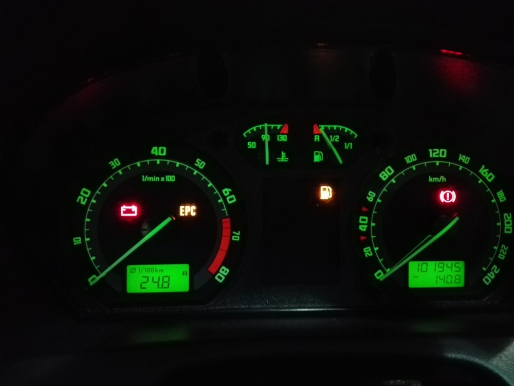

Hello people,
This is my first post here.
I own a 2007 Škoda Fabia Elegance, 1.4 16v, it's the BBZ engine (101 bhp).
I have an expensive and annoying problem with it. It's just consuming petrol as if it were dumping it down the drain.
This week I topped the tank. Drove it until the reserve light came on. 10.014 gallons. And I only managed to get 140.8 kms (roughly 87.5 miles) out of it. That's about 14 km per gallon (US) or 27 l/100 km. That's absurdly high.
Apart from the high fuel consumption I have no symptoms of an issue.
I suspect a broken coolant temperature sensor is the culprit. Do you guys have some input on what may be wrong with my vehicle?
Thanks in advance.
