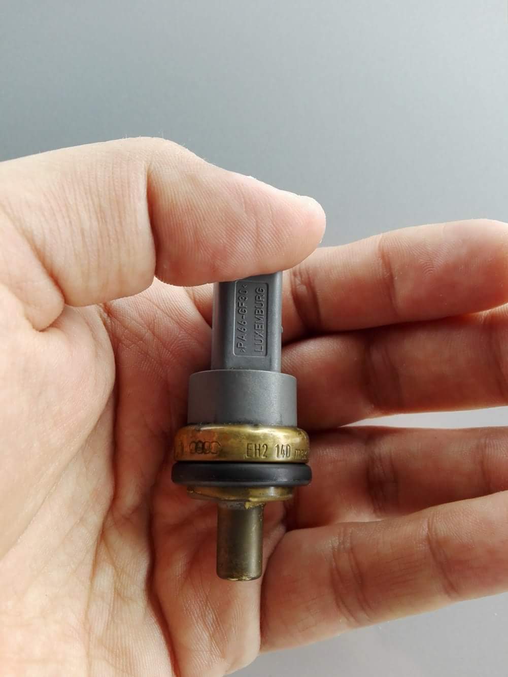

Just ordered the ECT sensor. It's a two connector piece with gray top. Checked it this morning.
At first I thought I could use a green top, but that's a 4-pin instead of two.

I think all Mk1 Fabias use the same coolant temperature sensor.
Please let us know if the new one fixes your problem. :)
Thanks @Wino. I'll do. Just learned that this morning when ordering the replacement part.
