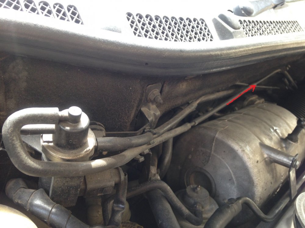

:crying: After replacing the cover (with the integrated gasket) the leak is back. It is coming from this area.
45333797_1046484745531857_2733690656055623680_n.jpg?_nc_cat=102&_nc_ht=scontent.fbkk14-1.fna&oh=e650a18394ba535a184062ce2c7b4957&oe=5C3C445D
I have already changed the breather tube and pressure regulating valve.
Any ideas what I should do next ??
Thanks. :)

I don't have a mental picture of the arrangement on an ASY engine, can you put up a photo?

Actually, is there a vacuum pump for the brake servo on the end of the head (right side of your pic above)? That might (?) exhaust into the camcover adding to pressure, so check for leaks in the brake servo hose which might be creating an increased volume of this.
Edited by Wino
  • Sponsor
Is there just one hose, going to the brake servo? Looks like it from that link.
In which case, with engine running see if that hose is hissing/sucking/leaking atmospheric air into itself at any connections along it's path. A source of smoke may help to spot such leakage as it will be pulled visibly towards leak points.

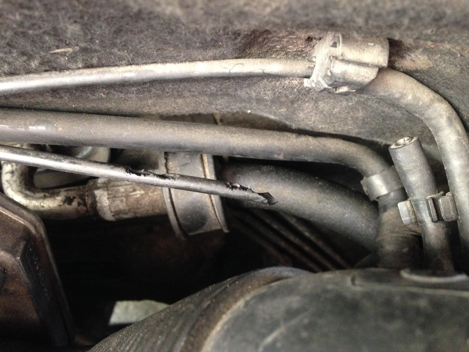

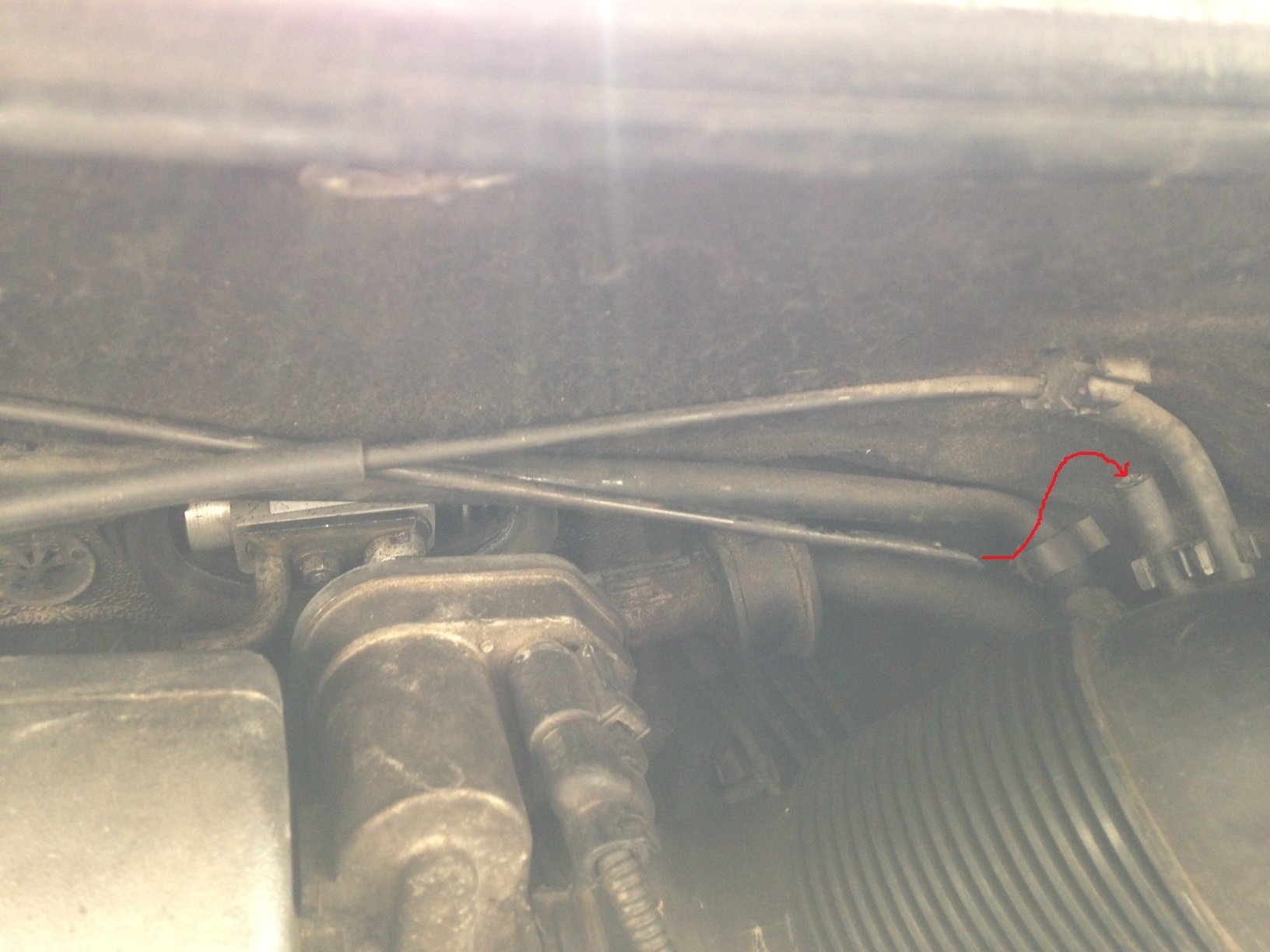

I had a look at the hose coming from the vacuum pump, it has another hose feeding into it. From here ....IMG_0309.thumb.JPG.ec62df84281a2ccab9539c6a622ceb99.JPG
This hose has perished and is no longer connected to the hose feeding the  vacuum pump.
From what you said the other day - I am presuming this is the source of the over-pressurization in the crank case. I'll get it fixed ASAP and hopefully the cover will stop leaking. Thanks again.
*  EDIT - MISTAKE - The broken hose actually comes from the air box, then to the pressure converter, before going into brake servo hose. It is broken between the airbox and pressure converter.

Hmm, what - if anything - does it go to at the airbox? If it's just a source of filtered air, I can't see that leak/brokenness being the cause of anything amiss.  If it's going to some sort of vacuum motor/diaphragm (i.e. a dead end) at the airbox then maybe.
I can't check where on the airbox it goes into, because the car is at the garage, getting the hose fixed. (best to get it done anyway)
Hopefully it'll stop the leak, if not it's back to the drawing board :(
I'll keep you updated - Thanks again :)
  • Sponsor
Looking at this page https://skoda.7zap.com/en/cz/fabia/fab/2002-225/1/129-129025/ there may be some sort of vacuum-powered blend flap in the lower half of the airbox, proportioning input from the two (prewarmed and cold) air feeds (24 and 14)? See if the vac line goes in somewhere around item 23, when you can. (And investigate inside at your leisure to see what is really there. :))
