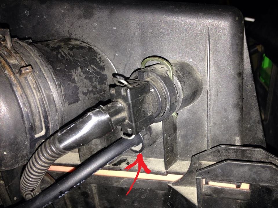

As far as I can make out from the photos of an upside-down airbox here: https://www.ebay.co.uk/itm/SKODA-FABIA-MK1-TYP-6Y-00-07-1-9-SDI-AIR-FILTER-BOX-6Q0-129-601-AE/253755564121?hash=item3b1502a059:g:GVcAAOSwWV9bTHTz the air pipe you are looking at goes into the top half of the airbox, and as such is probably just a source of filtered atmospheric-pressure air. So I doubt that fixing that hose will affect the crankcase pressure, unfortunately.

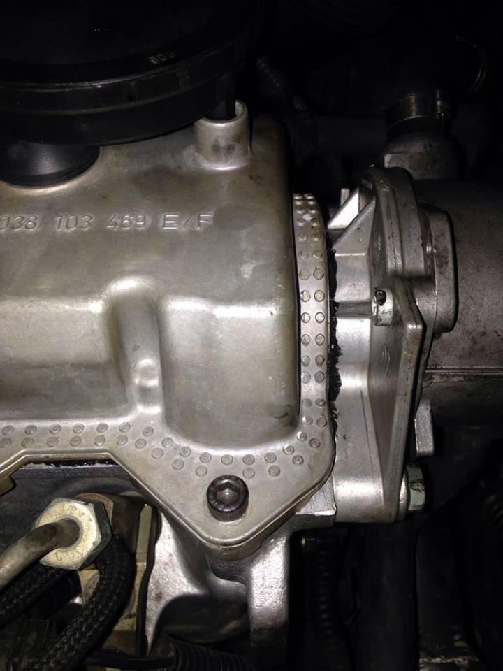

The assumption of excess crankcase pressure may or may not be correct and may not be causative of the leak. Presumably the vacuum unit, bolted to the cylinder head and driven off the cam, also has gasket or O ring between it and the head in the area of the oil leak and these could be the source?
Hot oil is very thin and will find its way through imperfect joints easily by capillary action. I suspect you may be barking up the wrong tree, simply use RTV silicon to seal the new cam cover in place and you should have no further trouble.
The leak seems to be coming from between the cover and the top of the block, rather between the block and the vacuum pump. But, I'll check the vacuum pump area when I collect the car.

The broken hose went into the upper part of the airbox (see below)airbox.jpg.8734ab615092b7ef90fee737402ee798.jpg134892494_coverend.thumb.jpg.586541cd62e07f01498ed15563fffc15.jpg

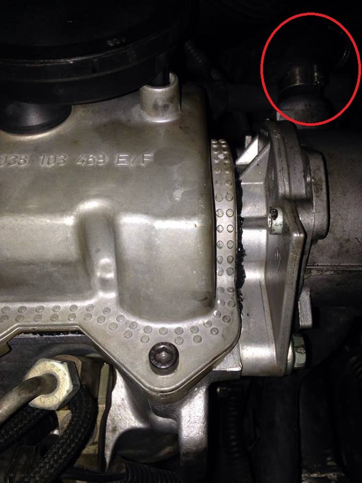

Yes - just one hose coming off the vacuum pump.

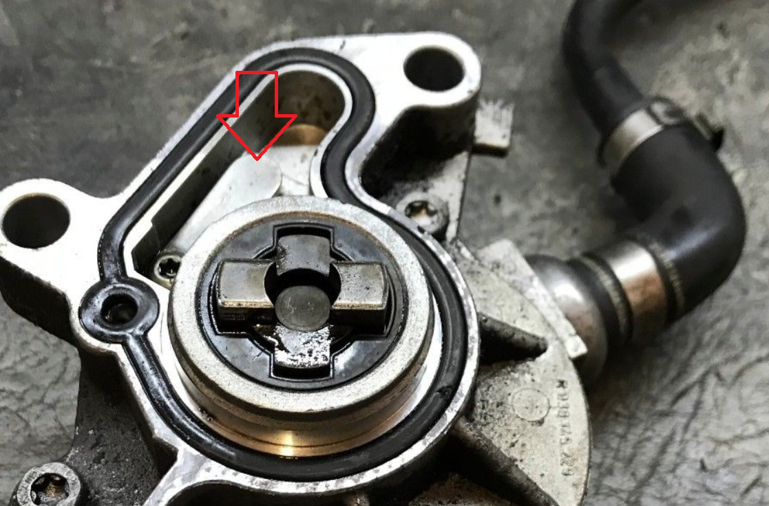

So the vacuum pump must exhaust into the cam cover.
Really need to know what that new hose connects into at the airbox, and if that is blocked.
Hard to see in this picture, but this is the only hose coming from the vacuum pump.

You can see the little flap valve where it exhausts in this photo (stolen off an ebay listing).

I'm still fairly sure (pending you having a looksee inside the airbox lid) that the hose going to the airbox is just a source of filtered air, and it was getting unfiltered before via the disintegrated hose, so no functional difference.  The process of fitting that new hose will be what's made the difference, not the presence of it, I reckon.
