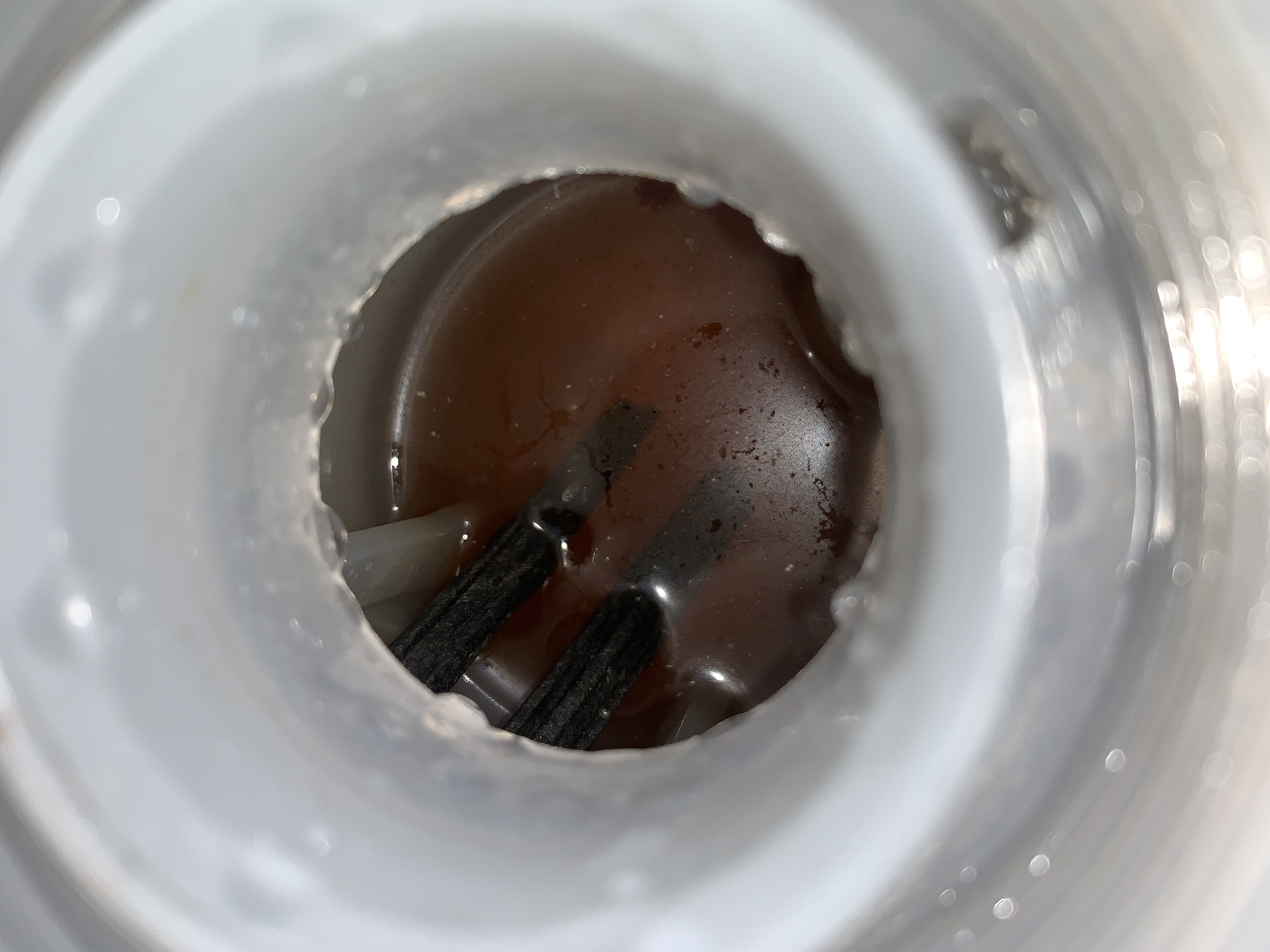

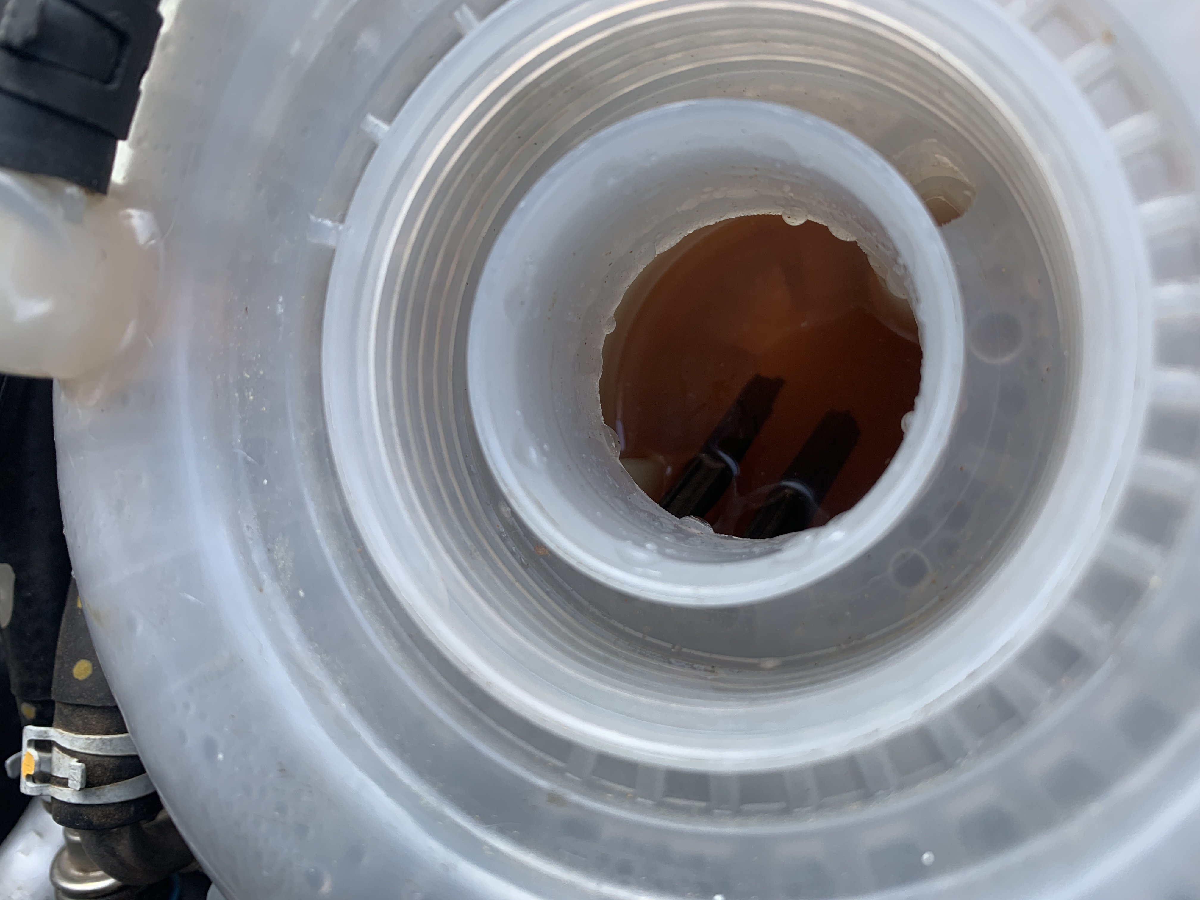

I am having some issues with loosing antifreeze and it's discoloration. Skoda garage has cleaned and changed coolant two times. Every time a day or so after coolant is no longer red but rather brownish with colorless film on the surface. Smells like exhaust  fumes to me. And today I looked at the engine while running and weird sound can be heard. I recorded a video which can be seen in YouTube https://youtu.be/7QG139VI0gc
I am also attaching images of collar from today, 2 days after it was changed and cleaned thoroughly.
Those with some experience about failing pump sound, would that be the sound of what I recorded?
Thank you in advance
