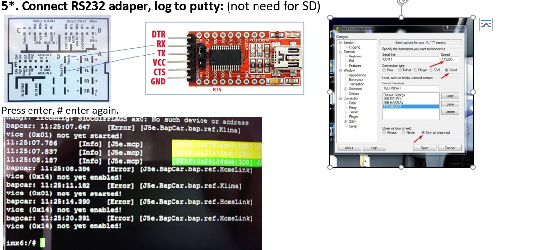

hi i have a 5Q0035864C drive that has been updated with wrong files, and now it continually reboots with the logo.
Could anyone help me please ?
Unit must be placed in emergency mode and reflashed. It requires unit to be open and UART connected.
All check your PMs
Hello
Is there a new firmware available for my device?
Hello!
I have SKODA KODIAQ Bolero MIB2.5
Now there is firmware 0478, you can get a link to firmware SW0480?
Thanks
On 27/8/2021 at 10:15, pab567 said:
La unidad debe colocarse en modo de emergencia y recargarse. Requiere que la unidad esté abierta y conectada a UART.
 hi pab567 thanks for answering,
 1 - I read a manual and it says to connect the unit to UART + PUTTY.
 2 - and emergency mode keep the motherboard dots together during the update process.
3 - in the manual it says nothing, but I guess the unit has to be connected to the power and to the screen, as if it were put in the car.
4 - I have both the unit and the screen disassembled, but I don't know which are the pins where to connect the power supply.
5* One more doubt, in UART you have to connect GND?
thanks for your help
3 - yes
4 - KL30 (+12V), KL31 (GND)
5 - yes

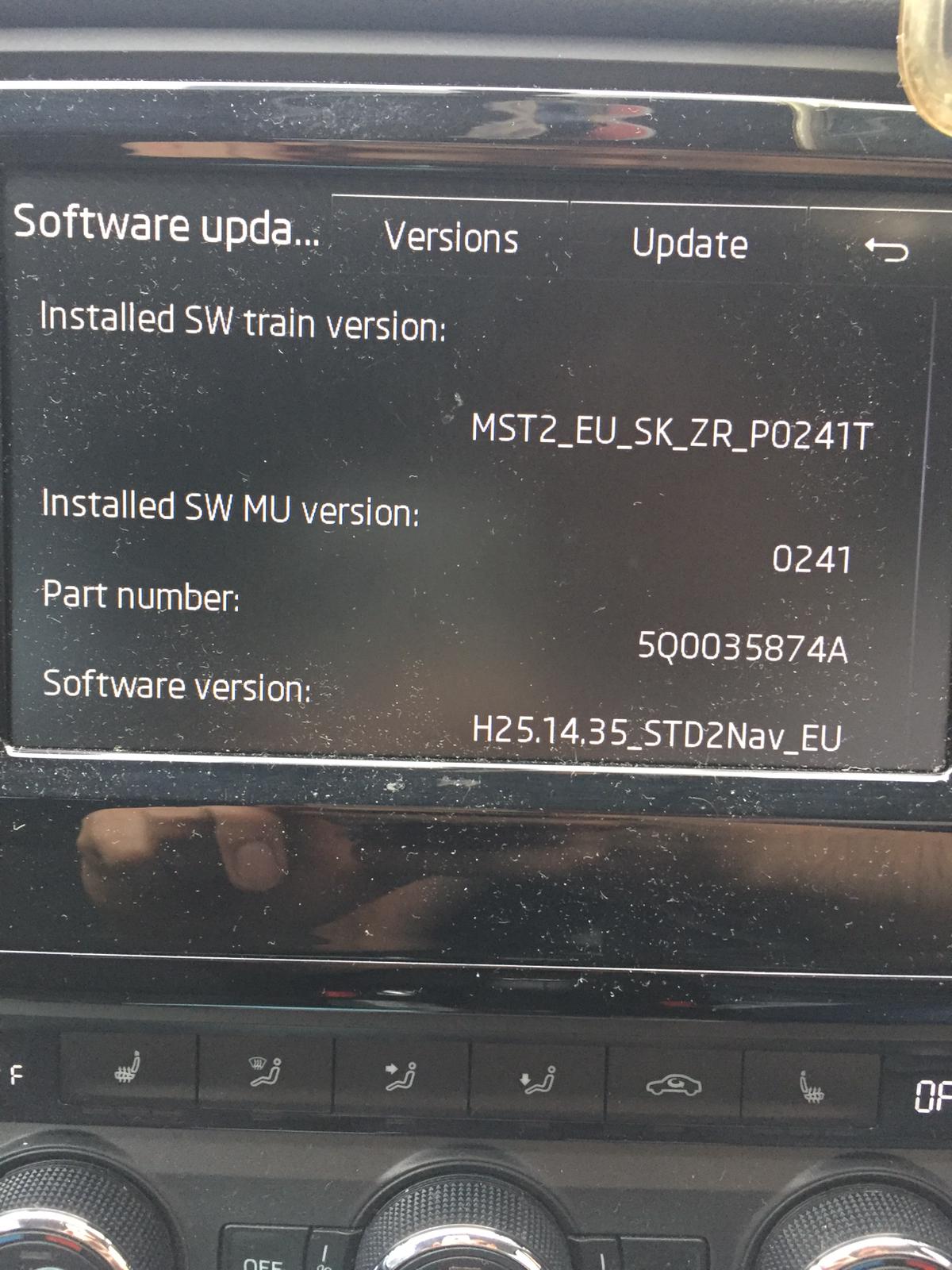

Sorry my software is 0241 and not 0468, honest mistake.
