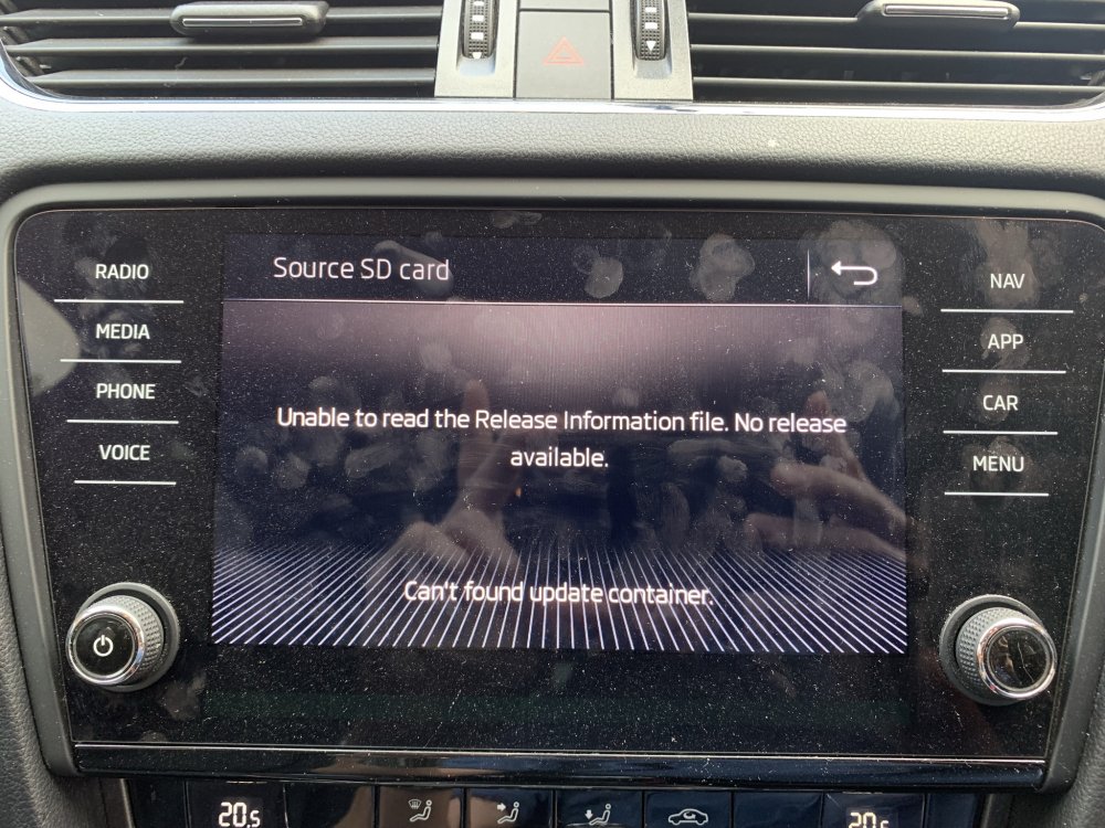

still having trouble updating my Amundsen, fresh FAT32 sd card, loaded with MST2_EU_SK_ZR_P0478T.7z which i understand is the latest version, press and hold menu, update from SD card, always get the same screen, is there a step i'm missing? presume just need the file on the sd card?
IMG_9764.thumb.JPEG.78ef8085ae50ee1bd81cd81edc0b8e56.JPEGIMG_9765.thumb.JPEG.12521a0cfe69f55c62b40719ac2aee34.JPEG
Looks like that file is some sort of zip archive. It's a big one :)
You must decompress that archive and copy the contents of the resulting folder to the card

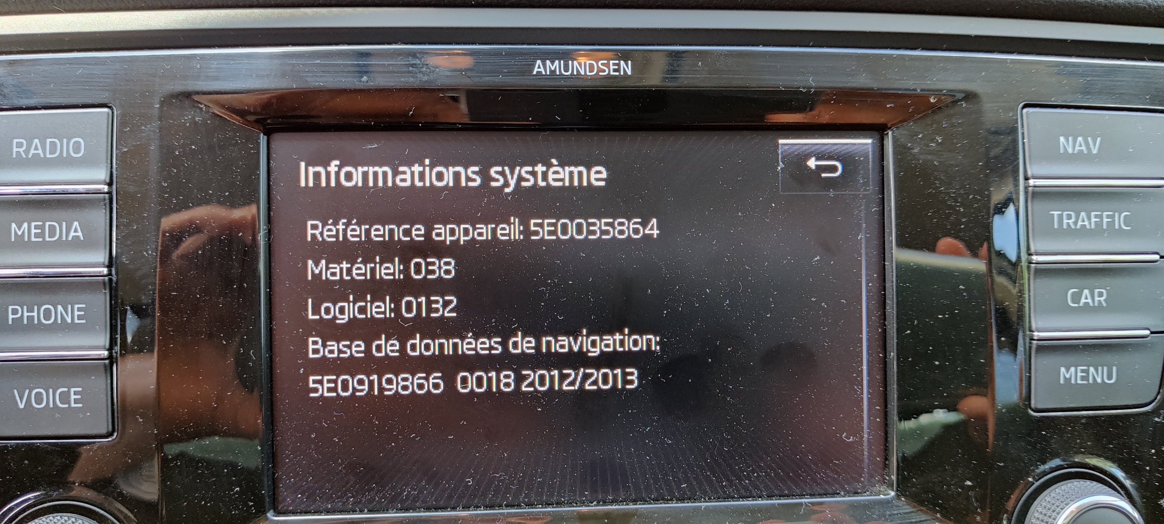

This is a photo of my system before I try to upadate. Do you think It wan not the right version?
3 hours ago, varaderoguy said:
@jay01600 Have you updated with the correct version of firmware for your unit.  Is it a SOP2.x, SOP3.x or SOP4.x version of firmware?  It sounds like you've put in a newer version of firmware than your unit can cope with.
If (for example) you have a Amunsden with Version 0251 on it, you can only upgrade to 0253; (example) if you have 0347, you can only go to 0351, (example) 04xx can only go to 0478.
From 132 to 490 --> do you think it's my problem?
Do you have an idea to downgrade my unit?
Best regards
Speak with @pab567 to make sure he can supply you with the correct firmware for your SOP version - in this case an SOP1.x version.
