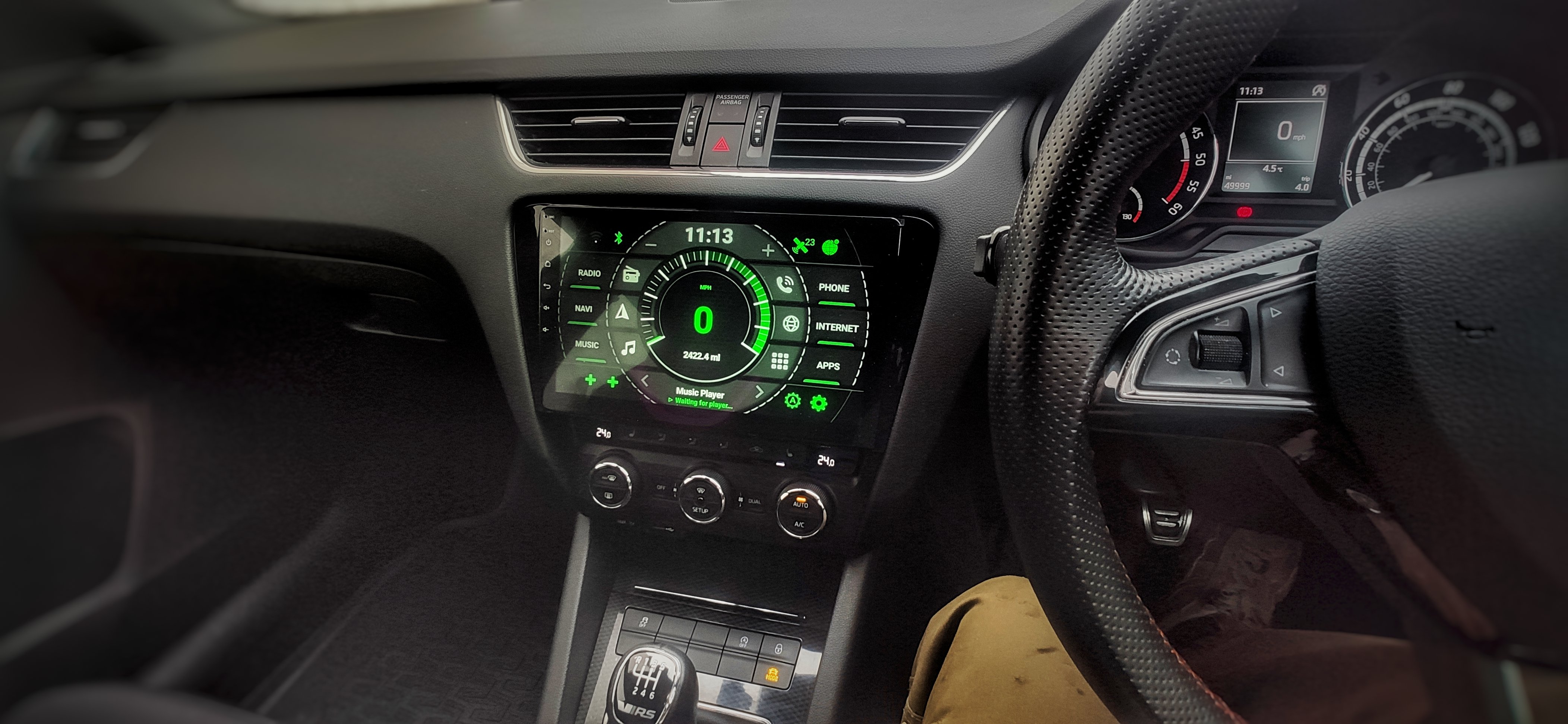

Here is what you get when you press the drive mode button:

GPS antenna comes with it and is mounted under the dash behind the stereo as shown in the installation video on 1st or 2nd page, reception is perfect for me. Note in pic above the custom launcher I am using displays number of satellites connected live.
Yes I saw that after I posted....
Which launcher is it?
It's the Agama Launcher
