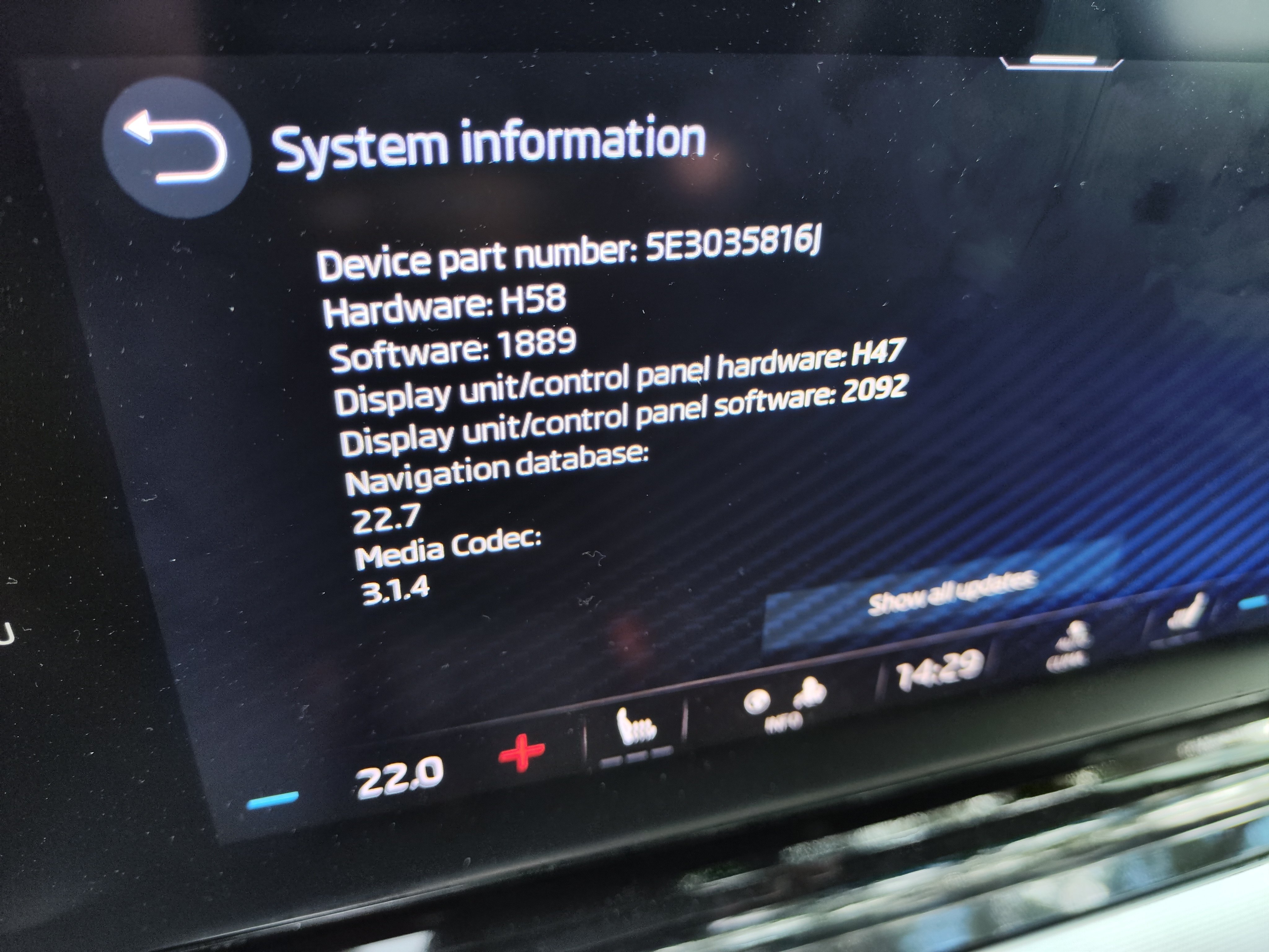

i read the software updates people are getting.can anyone help me.i have been told on here my software/hardware are correct but are they?  hardware h58---software 1889----display unit/control panel hardware h47---display unit/contro; panel software 2103----navigation database 21.2-----media code 3.1.4.i contacted skoda 12 days ago and they said there could be a problem and they would get back to me and guess what not a word since.my screen keeps going blank and at times other things come onto screen and have to switch car off and turn it off and all is fine. any advice please.
Might be worth posting an image of that information, would be useful to have it document for you as much as anyone else that reads this.
Yes, they are correct. Your navigation database will update in the background when you use the navigator on a longer trip, assuming you have an active Infotainment Online license.
What do you mean by "other things come onto screen"?
Here's my current software. Car works like a charm with these:
Edited by Jorgeminator
Updated yesterday or so they have told me! Went for a drive today dialled sos twice. Unbelievable!
it say configuration in progress,then sometimes goes blank and cannot do anything unless i turn engine off.any help?i am going to pop into the skoda garage by end of week and hope to get some help off them.

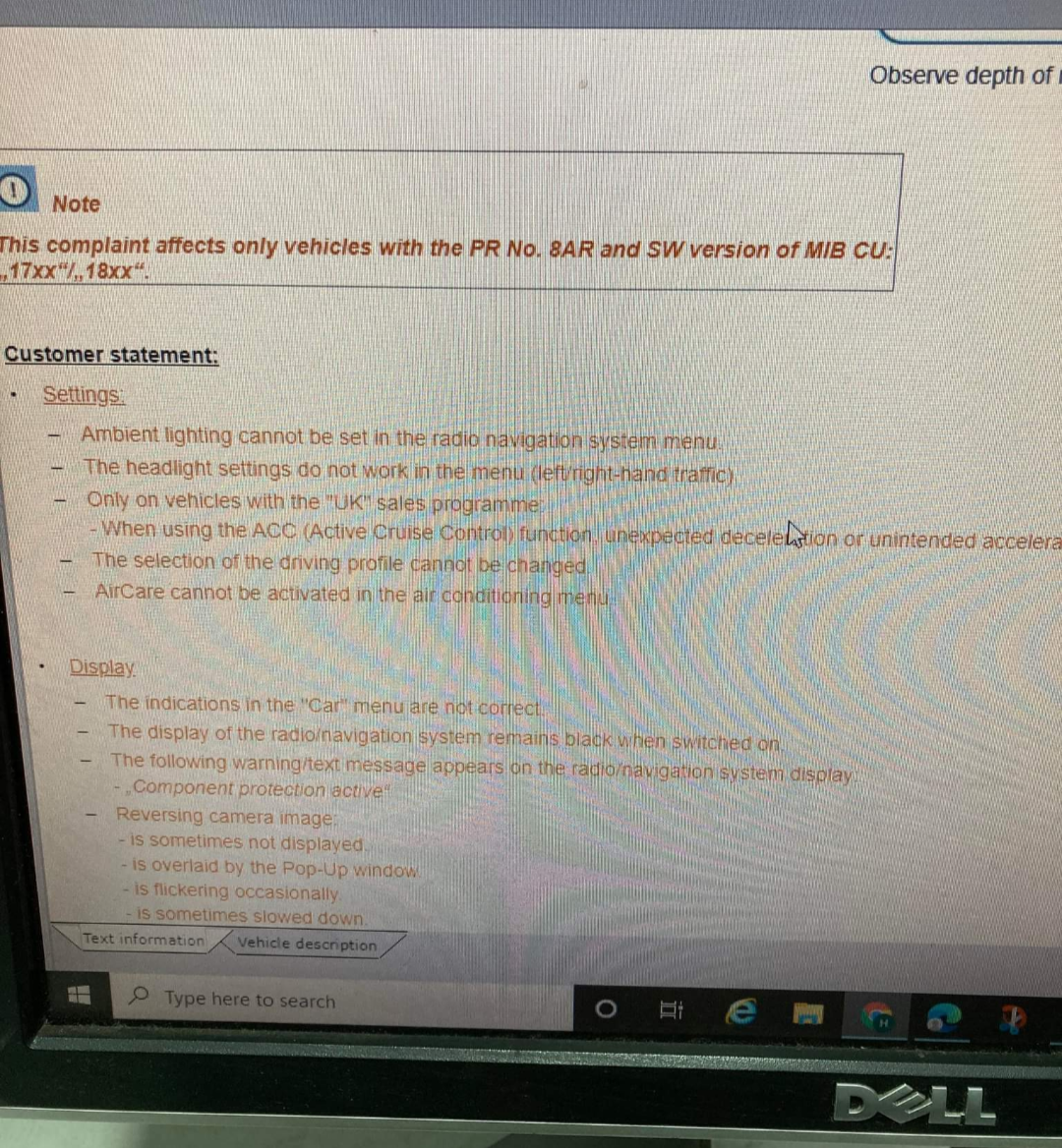

Only just seen all the replies to this topic I started, here is a screenshot (albeit a fairly poor one) of the TPI information that the Skoda techs get from Skoda UK listing the requirements for the update to 1896 and the issues it resolves.
Hope this helps some of you
