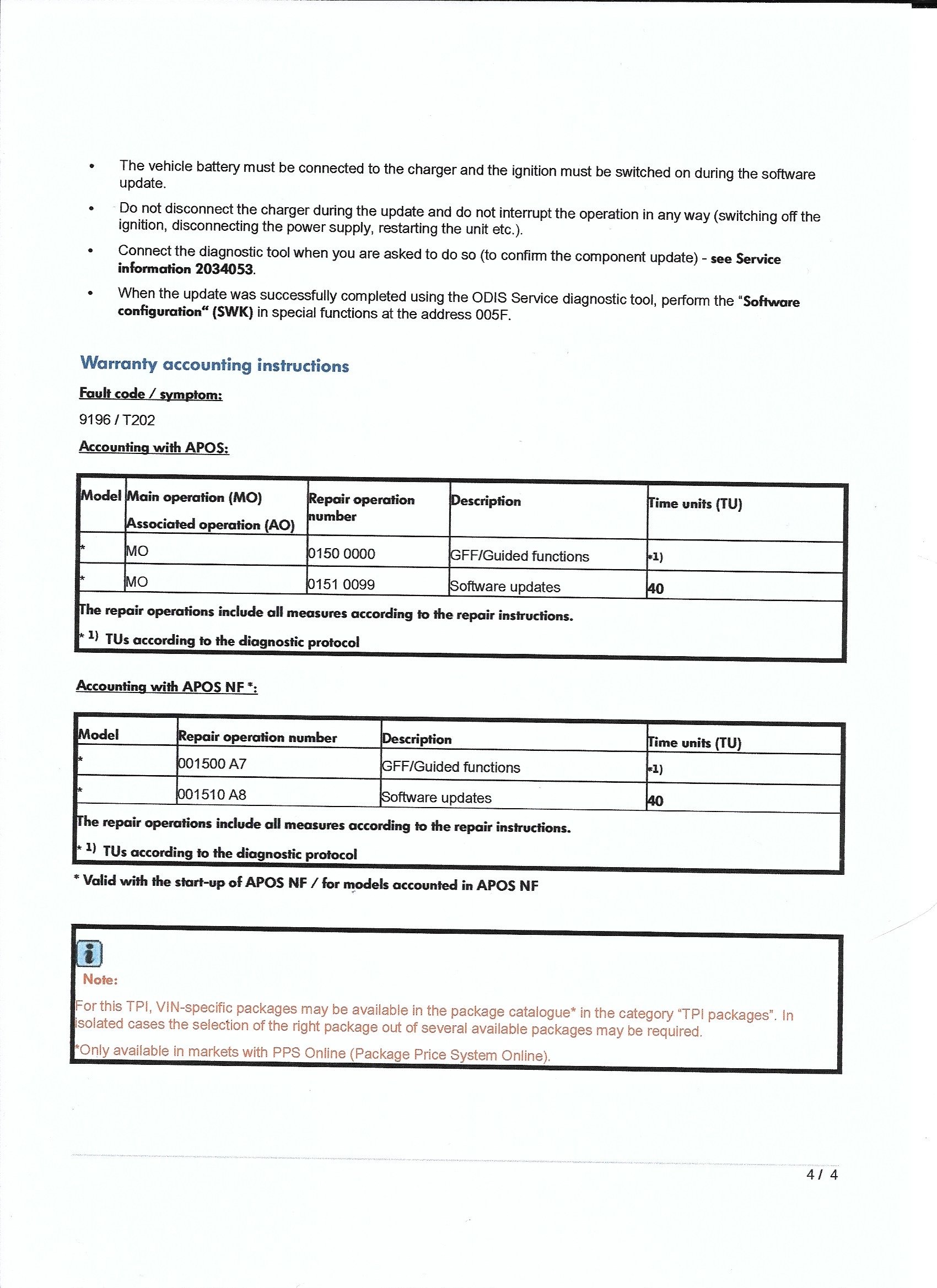

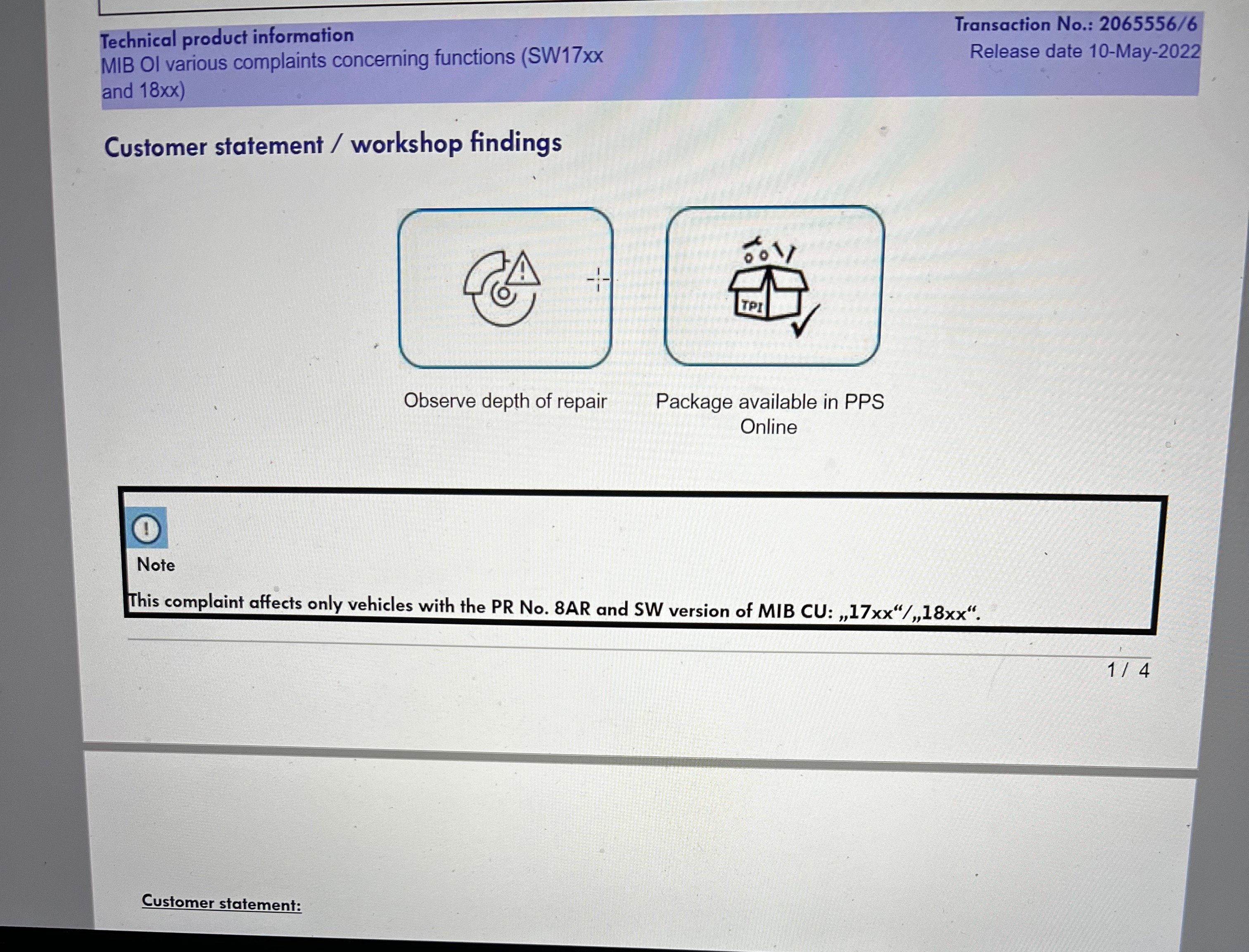

@Macca24 Are you able to share the TPI for this with everyone?
If it's the full document, I have been wanting to read it for ages.

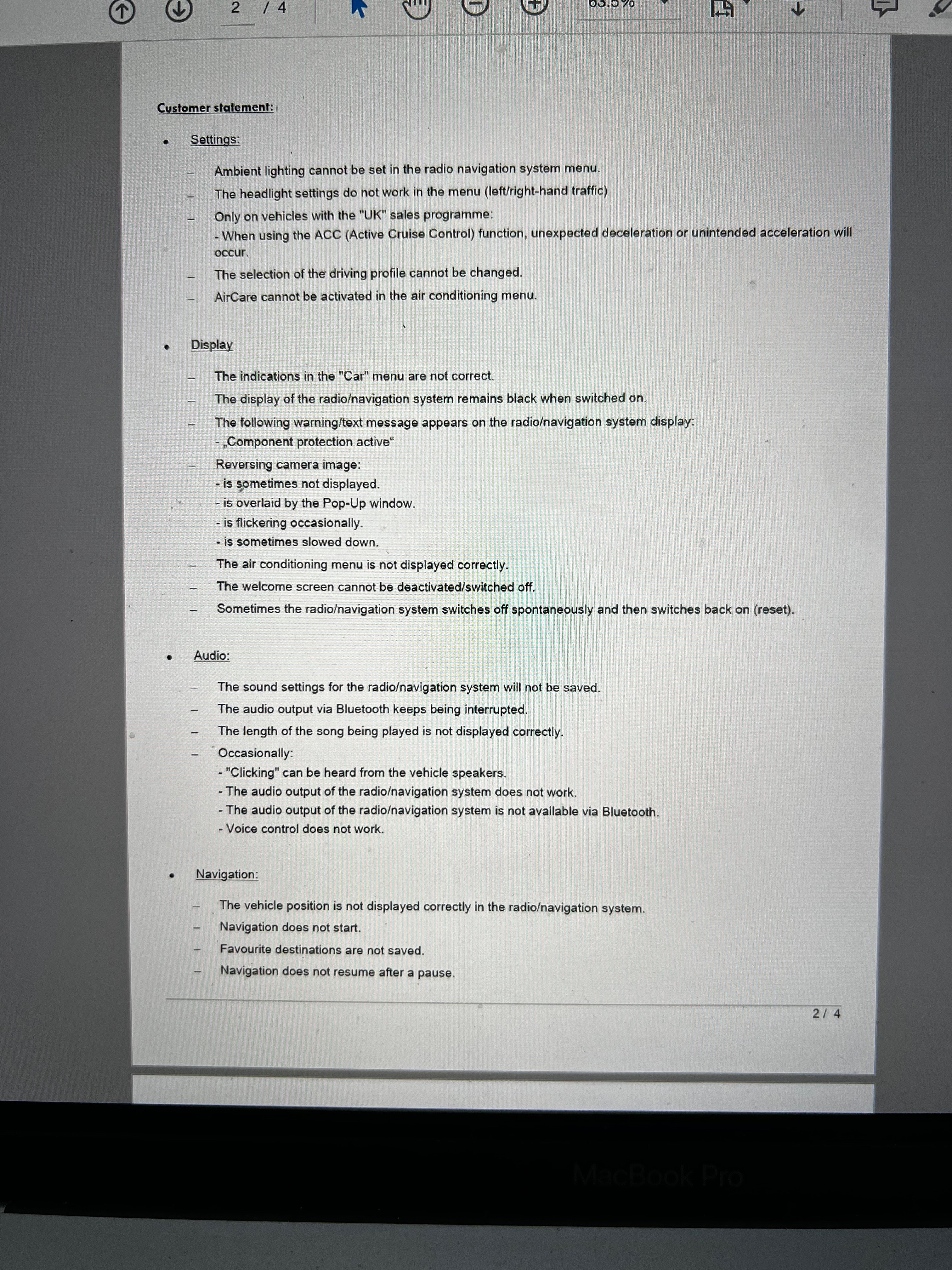

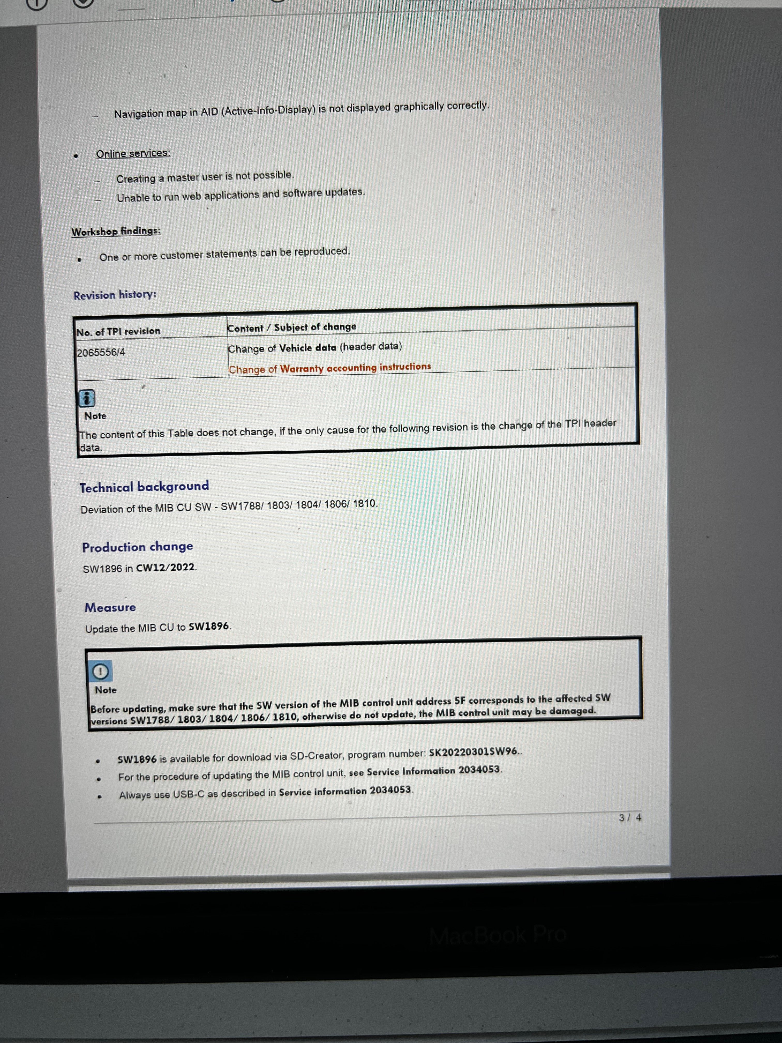

I'm surprised it's only 4 pages, the VW document I suspect is bigger maybe, with more details.
Thanks for adding what you have @Macca24
This is what I managed to download from Erwin.

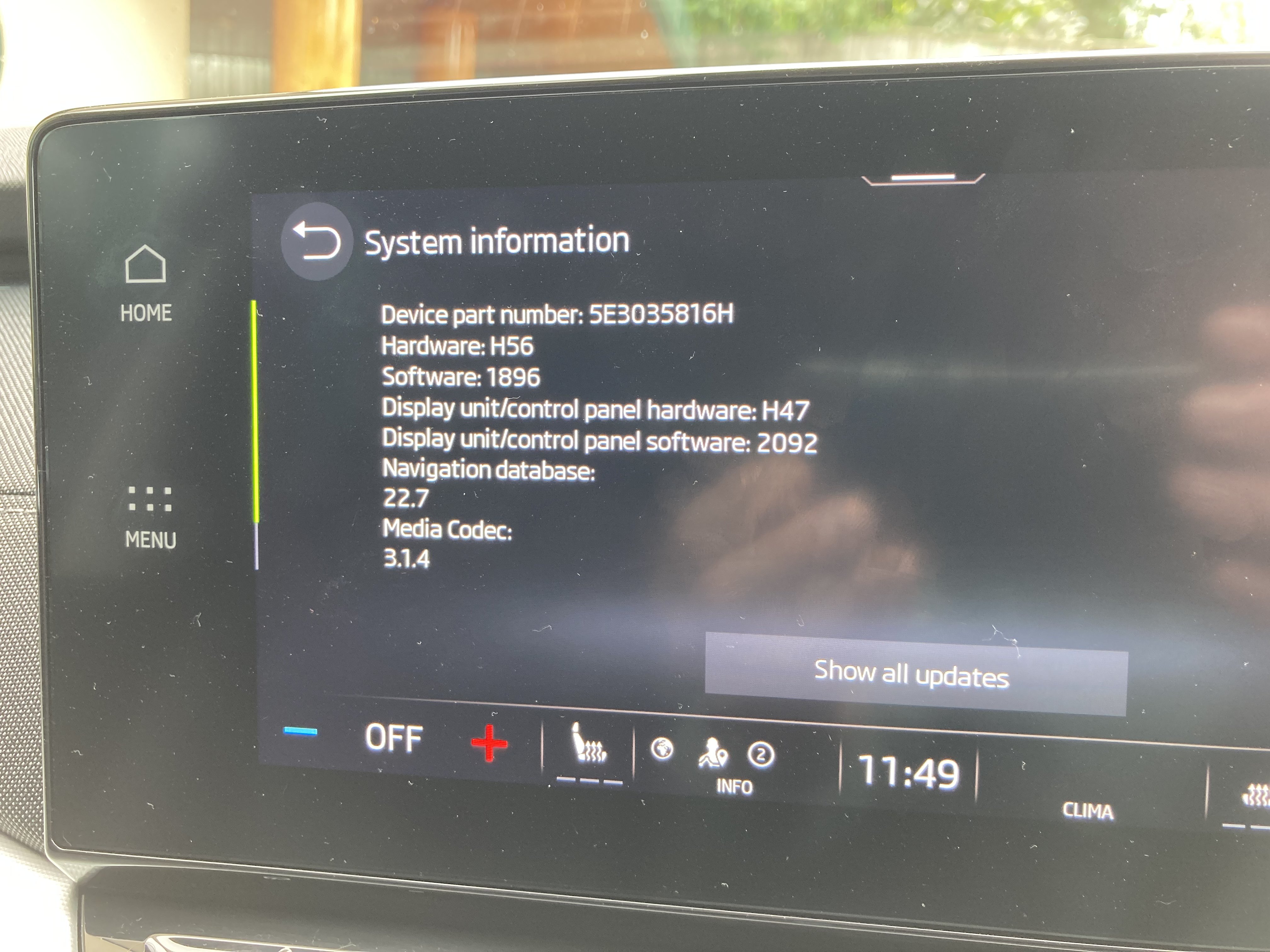

Well, this is frustrating…
Had the car in for a service at 2yrs - they did an s/w update which took three days! So, I how have…
  • Device part number now has H suffix (no suffix previously)
  • S/w  Version now 1896 (was 1668)
However, many settings have been lost (set back to default)…
  • Had to reconnect my phone to CarPlay
  • All my SatNav favourites have gone
  • Radio favourites have gone
  • Mapping auto dim/ night mode reset
  • and I don’t know what else yet…
Just hoping that it hasn’t screwed ACC or kph/mph which were fixed a year ago.
Here’s to an hour or so of going through all the menus looking for the many things I setup about 18 months ago… 😔

Happy camper here now up to 1896. Great service from Bournemouth Hendy. Booked within 2 weeks and a few hours later call that various updates done for ACC thinking it’s in Europe and inability to save satnav destinations. Despite a service manager overhearing the problems as I checked car in and trying to explain it as ACC being designed to be really cautious. My clue had been the traffic sign recognition changing to km p hour when it misbehaved ie 110 showing when on motorway it should be 70.
The ACC couldn’t cope with rain but worked well some of the time. Touchscreen laggy, Kessy getting confused who was getting in car etc. Inability to save destinations or home location.
All seems instantly improved. Mib module wasn’t talking to Skoda and getting updates apparently , so that was fixed and updated to 1896. Then as soon as got home an OTA update appeared so all looking healthy.

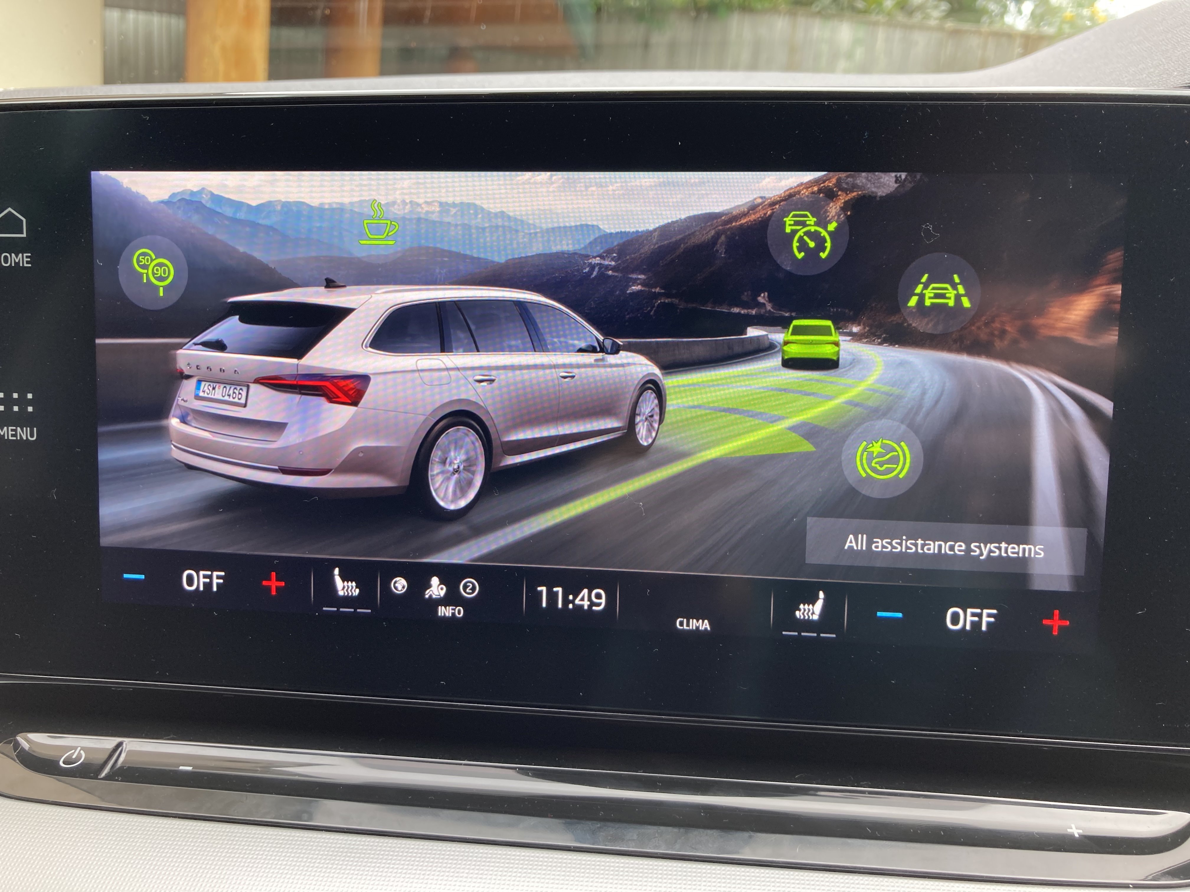

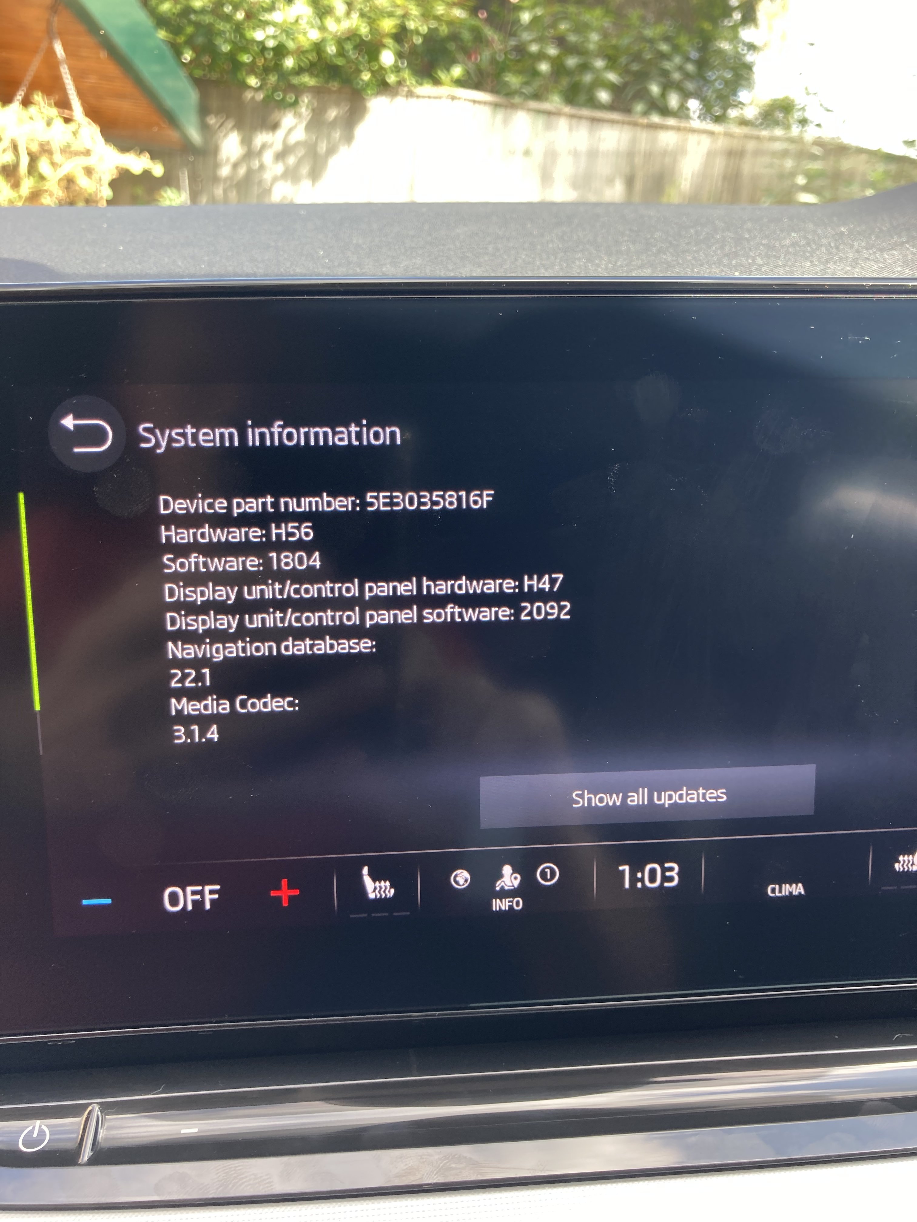

See photos as was part F and now H.
New assistance screen too
Latest versions

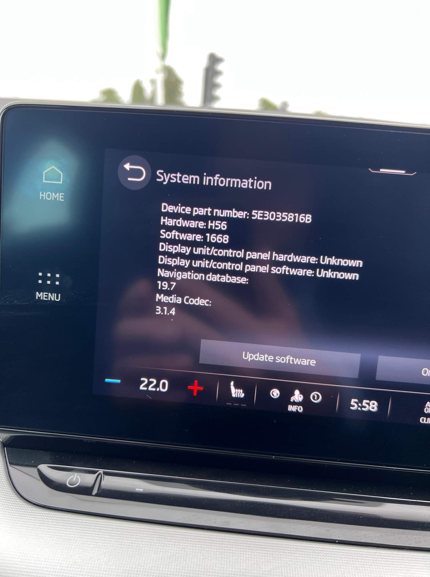

Hi there.
Just out interest, what year and model of Octavia do you have.
I looking at a First Edition for sale at a garage and asked the sales to take a photo of the sys info and asked him about software updates to 1896 before I commit to buying it,
Heres what he replied to me and im not sure he's right, Any advise,
His message to me.
Hi David apologies for the delay in getting back to you ,there was a delay in getting the information ,so the vehicle you enquired about has a software update that’s takes it up to 1778 from 1668 the latest one that will come on vehicle built in month 12 /22 will be 1896
The problematic ones were 1788 1803 1804 1806 and 1810 ,I have this in an email from Skoda technical
Edited by scoobyguy

14 hours ago, mitchec said:
Hi there.
June 21 build iV
