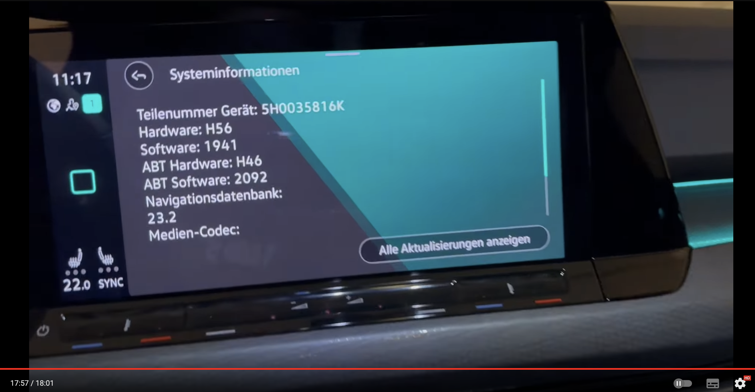

Anyone could check if 1941 is compatible with older cars (2020) with H56? Asking here because my dealer is unresponsive again and I still don't know if they can install it for me...
Is compatible with all hw versions
@Edela  check the video I linked above - the guy with the Golf mk8 has H56, see minute 17m57s
That's great news @Rainesh - it looks like there's some hope for all of us...
