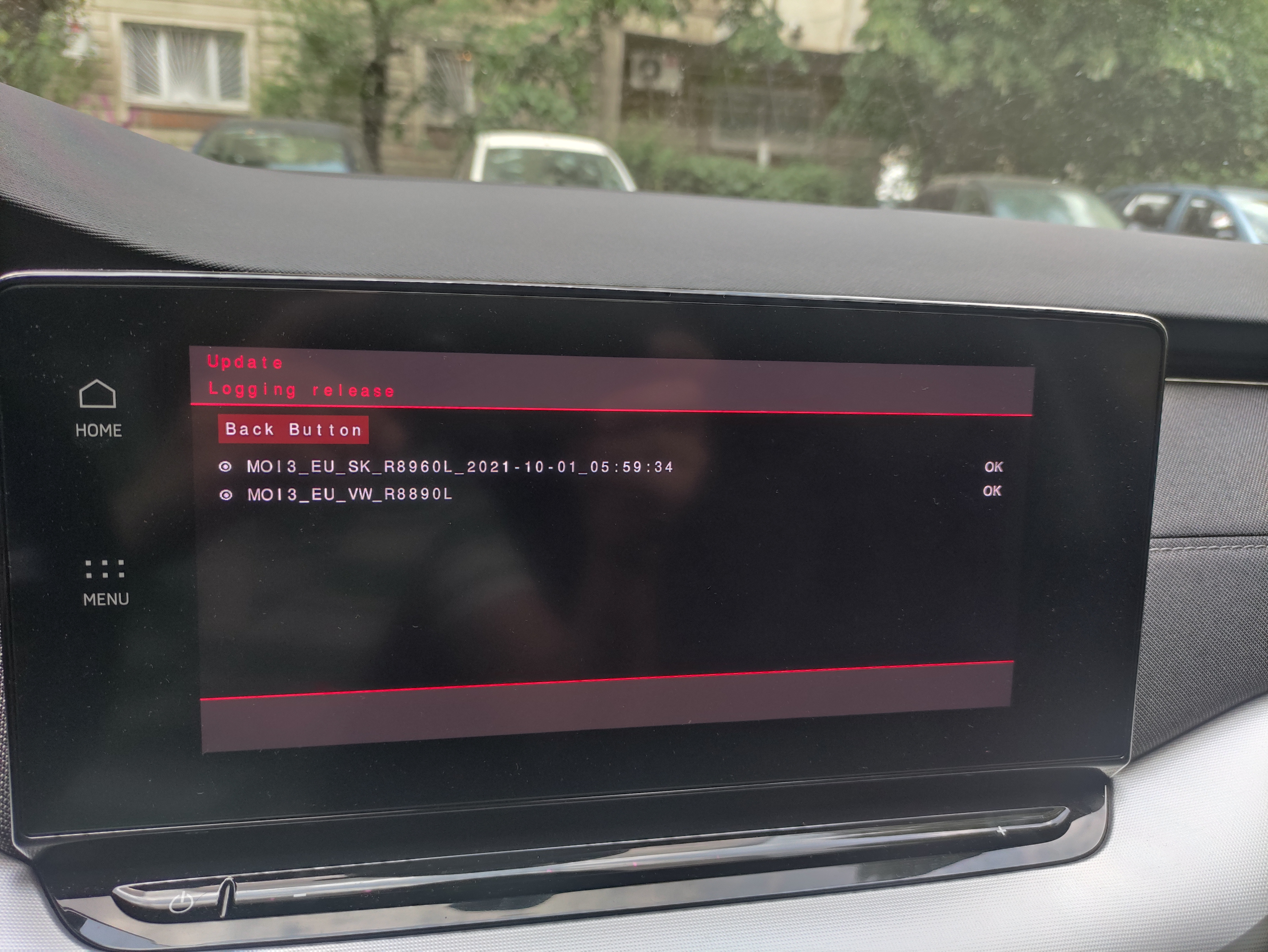

Infotainment Software Updates
For all the cars that have been delivered from the factory the SW train is: VW.
If the cars has received a major update change via the dealer, the SW train will be changed to: SK.

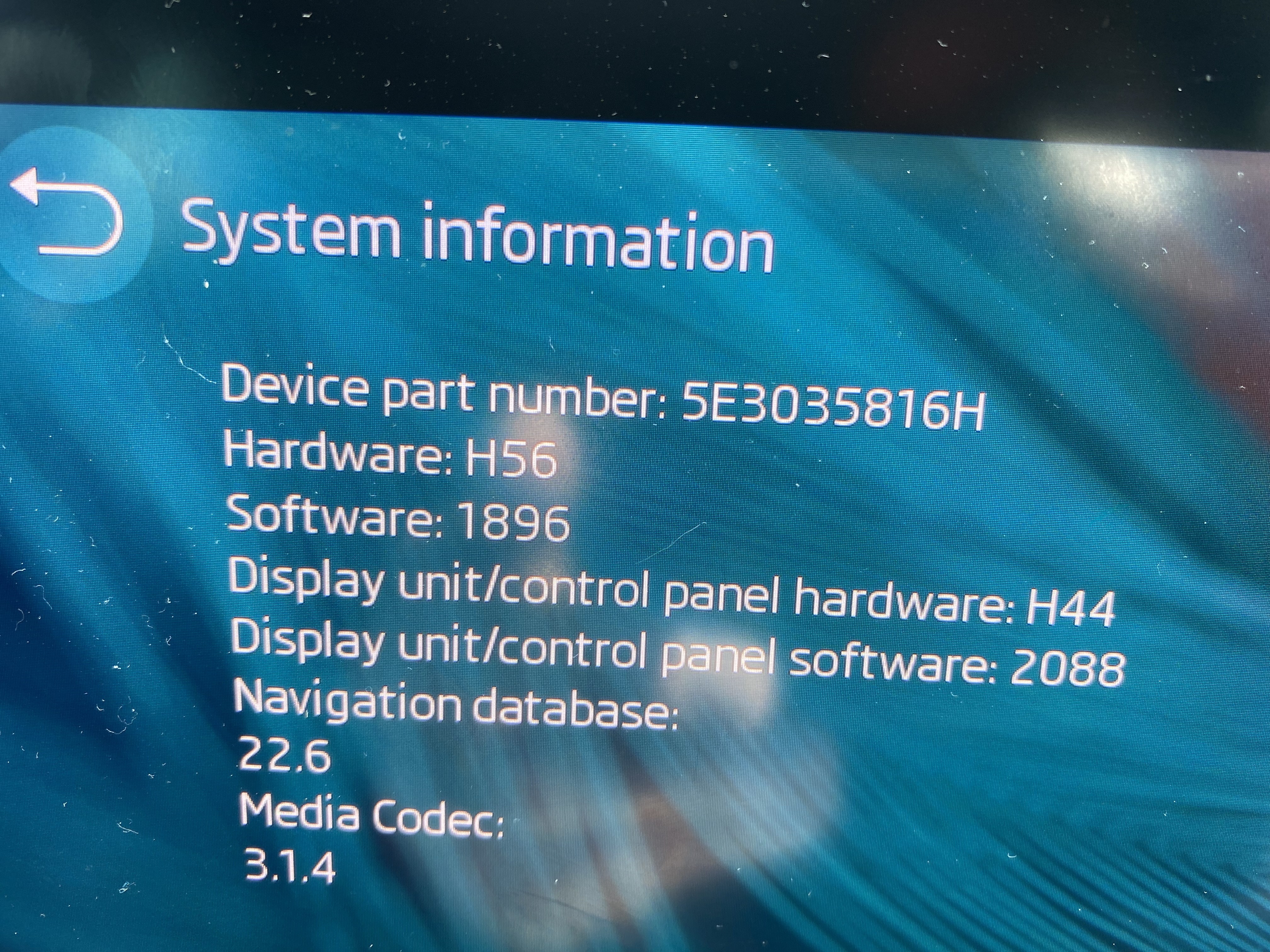

QQ: Will we be able to update our units with any kind of software afterwards? E.g. Someone with SW version MOI3_EU_SK_R8960L(1896) can process an update directly to MOI3_EU_VW_R9410L(1941)?!
Edited by djmartzian
Ok - other than checking in ‘System’ to see if versions are updated dated to a higher number - how do you confirm that OTU updates are complete. Only time I seem to get updates is through main dealer.

Indeed, the Mk8 guys managed "to fix" the reboot issue by upgrading to 1941 version. The same solution was proposed here, in one or two pages behind in this thread. (from top of my head, @varooom was the one).
BUT (always it's a but), this version has been released with the VW and SE(Seat) software train, and unofficially yet. I'm not aware of such release by SK.
https://mibsolution.one/#/1/9/MOI3
The process to upgrade is also unclear (for me at least) - please see one of above posts with my concerns.

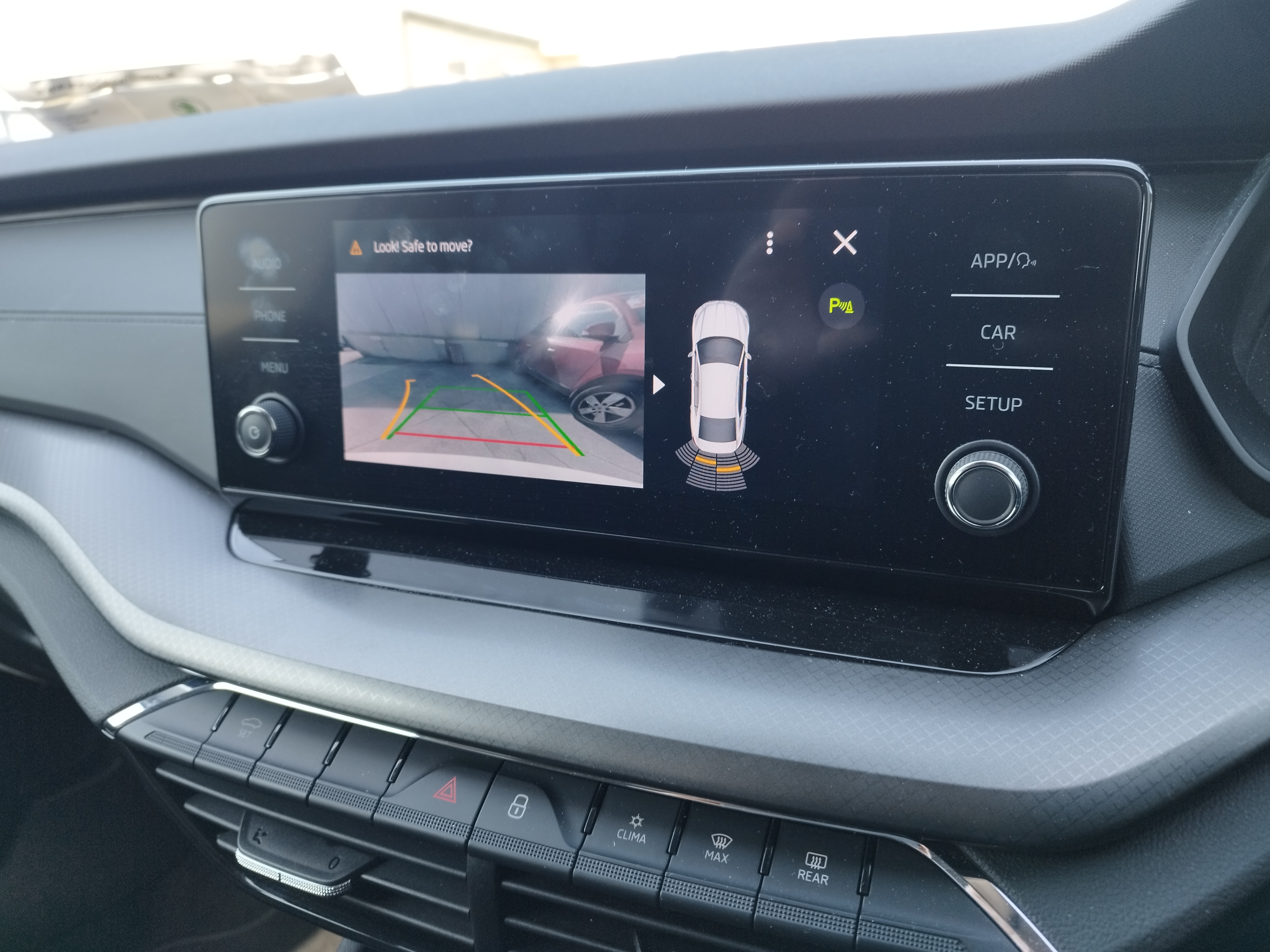

Been reading through this. Based in Ireland so I have a 1.0 TSI Ambition Octavia. It's the 5th Octavia we've had from new (2 car household) and our 6th Skoda overall. The car is a 221 reg meaning it was first registered in H1 2022.
The car has been plagued by SoS warning lights and issues with the reversing camera blacking and freezing.
The car has been back to the dealer numerous times. In fairness to them they're decent enough and have provided me with a replacement car but Christ it's frustrating.
I was told that the fault log in the car, didn't register any of the SoD faults but I had photos to back up my claim. Anyway, after the 1st visit they advised they did a software update. On the reversing camera, the standard response was its working and they couldn't see any issues.
Anyway the issues continued and eventually they brought in a few weeks ago. I managed to catch a photo on my phone of the reversing camera showing a clear space behind the car but the sensors were red. So the sensors were picking up the wall, contrary to what the camera was showing (image attached).
The car was with them for a week and upon its return I was told that there was a number of tweaks made to the software. Should there be any further issues the media unit would need replacing. My sales guy mentioned the same as others "Skoda force dealers and customers through a ridiculous troubleshooting process before replacing the unit under warranty".
So this evening my camera froze again. It's already caused one minor tip. I accept that ultimately the responsibility is mine but if my car has a safety feature such as a reversing camera, I should be able to rely on it. The car is already due to go back because the central locking is banjoed after the last software update. The internal central locking button won't unlock the doors or boot either. Only way to unlock the car now is to open the driver's door. On top of that, turns out the rear passenger door won't lock at all - I don't know if that has always been the way though.
My patience has run out at this point. It's a shame, such a lovely car but let down by very shoddy IT issues.
