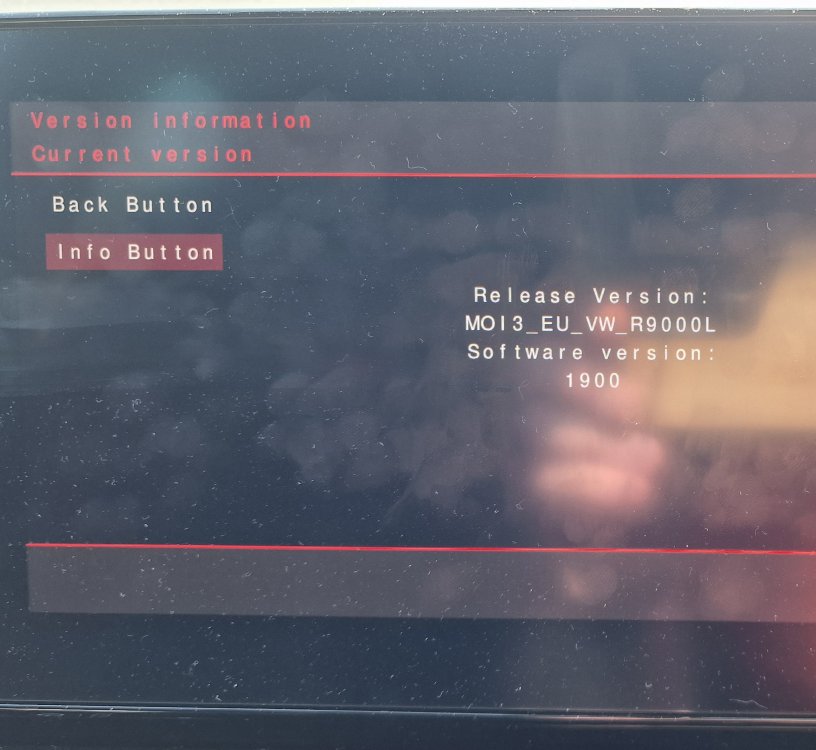

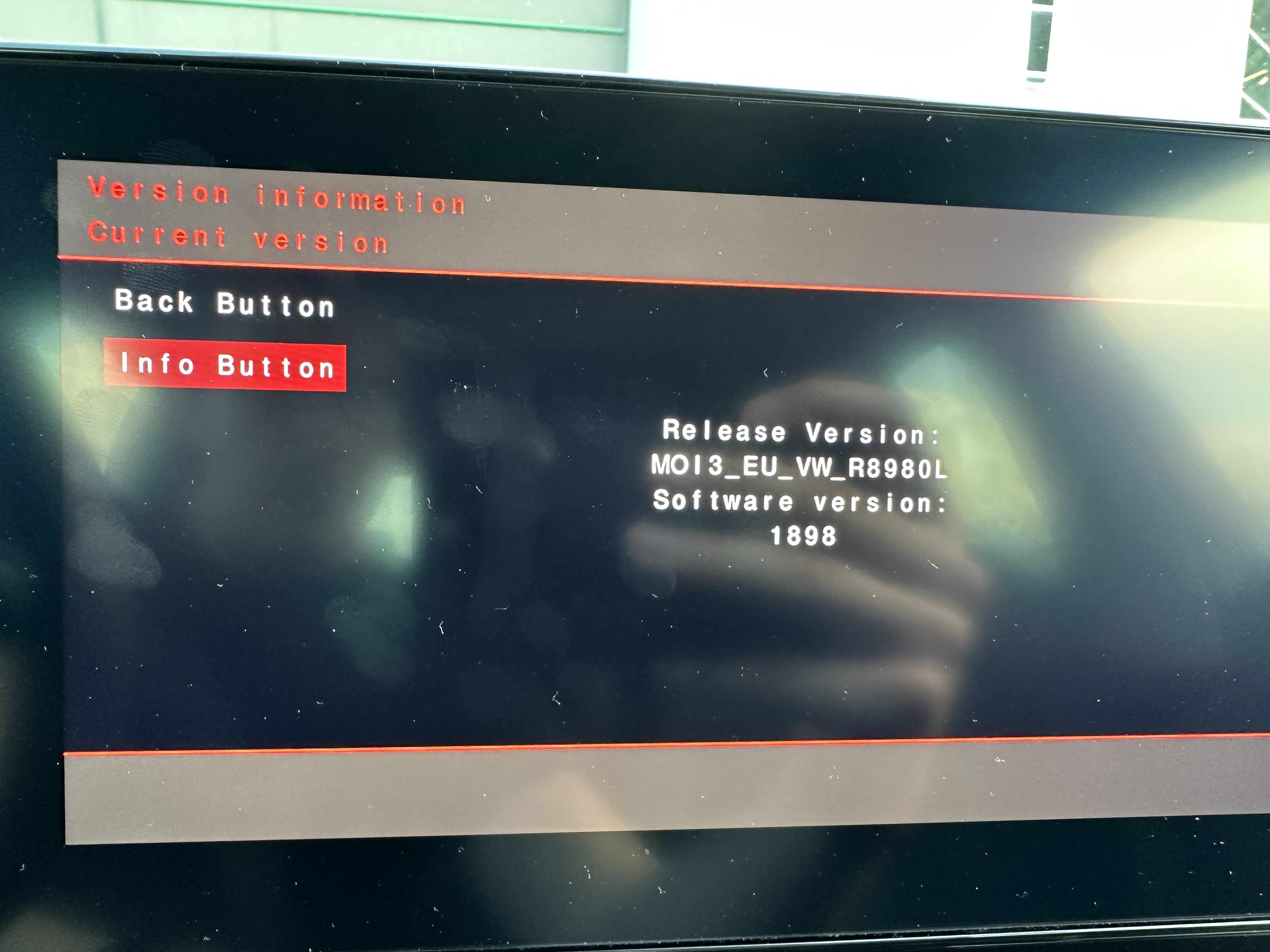

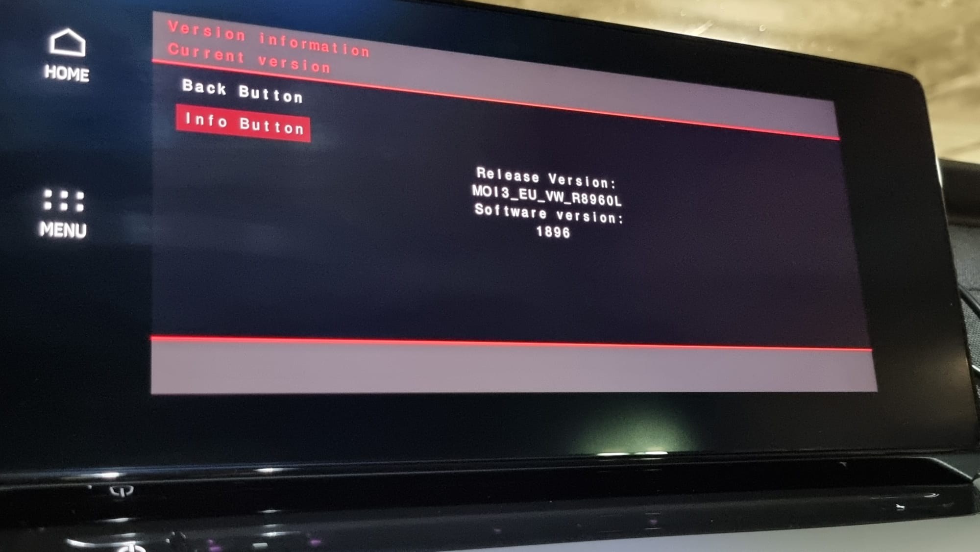

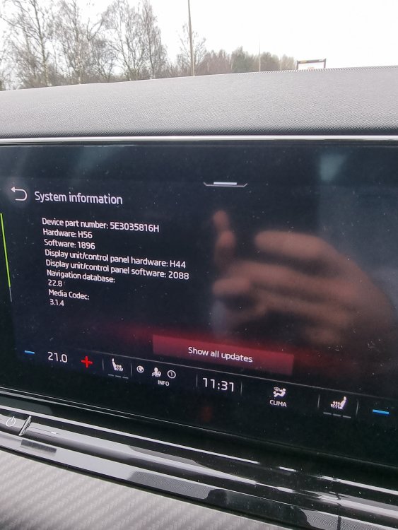

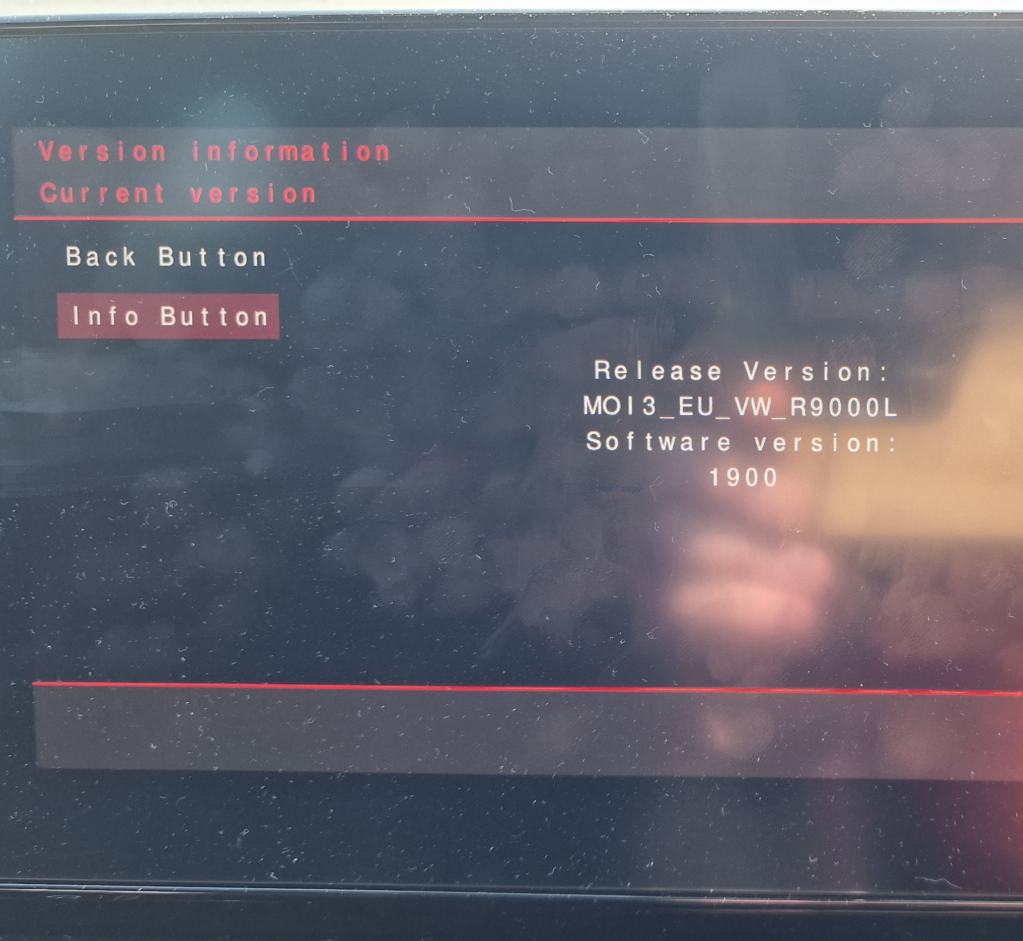

Interesting addition @SkOmk4 seems they don't mind mixing SK with VW.
Which means in at least theory it could upgrade to 1941, though I wouldn't recommend trying this upgrade.
What have they done 😧

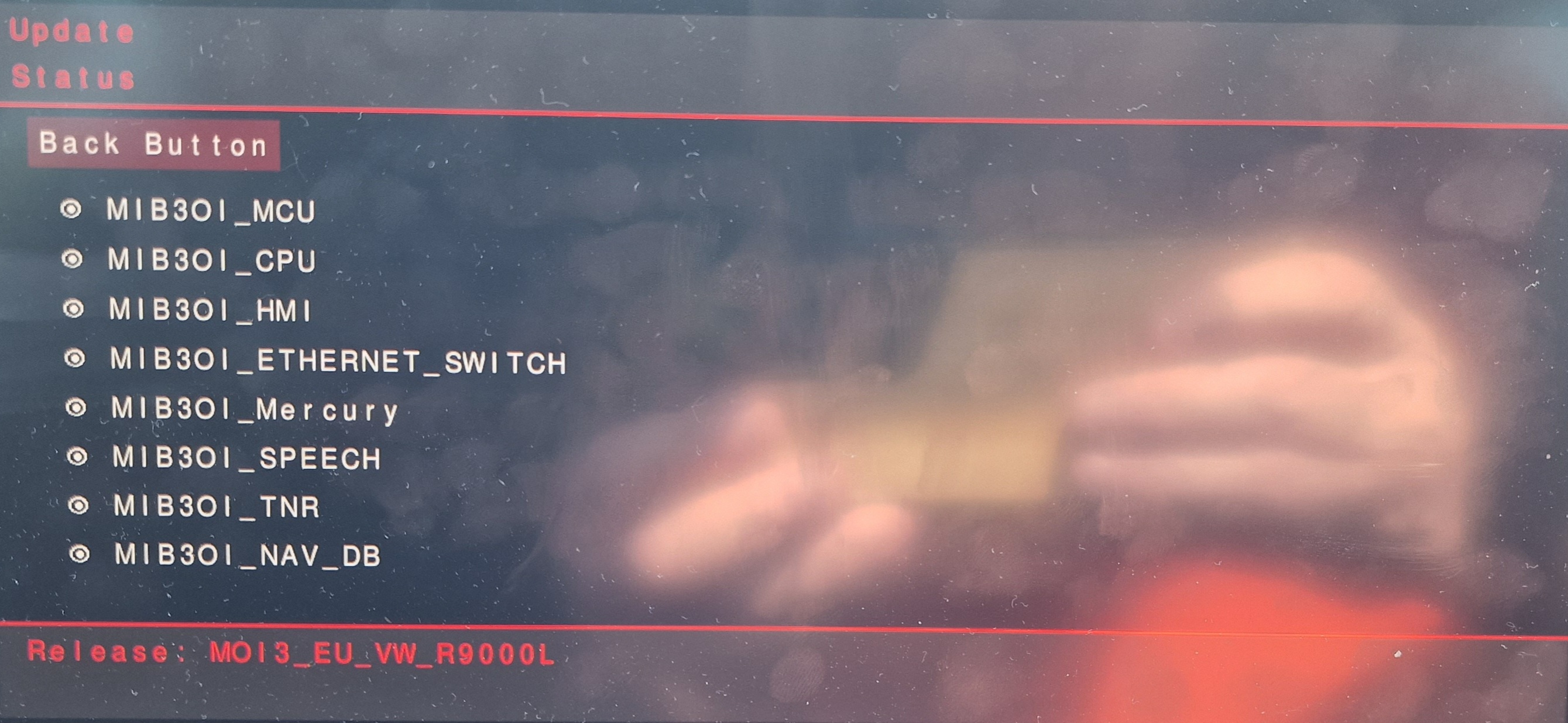

These are what I got from the system 20230608_121618.thumb.jpg.24759d1f597b957b258f97c401660472.jpg20230608_121445.thumb.jpg.37809d6ef5055216ca002d3dd13b3692.jpg20230608_121607.thumb.jpg.f08b6434d990c2b95913c25684c1f0c7.jpg
So who wants to try loading VW version 1941 🤪
Seems weird that this has happened, the change from SK in the software train to VW.

1. I'm running the same VW train as  @SkOmk4 mentioned above!

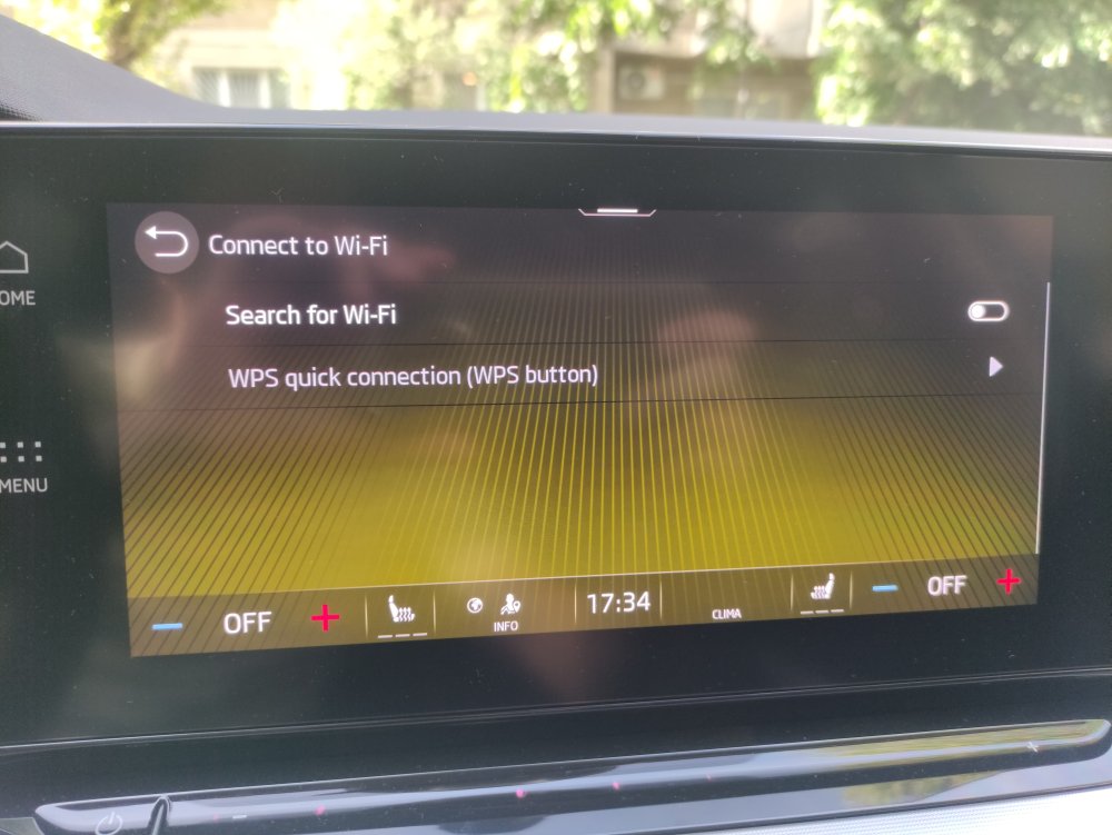

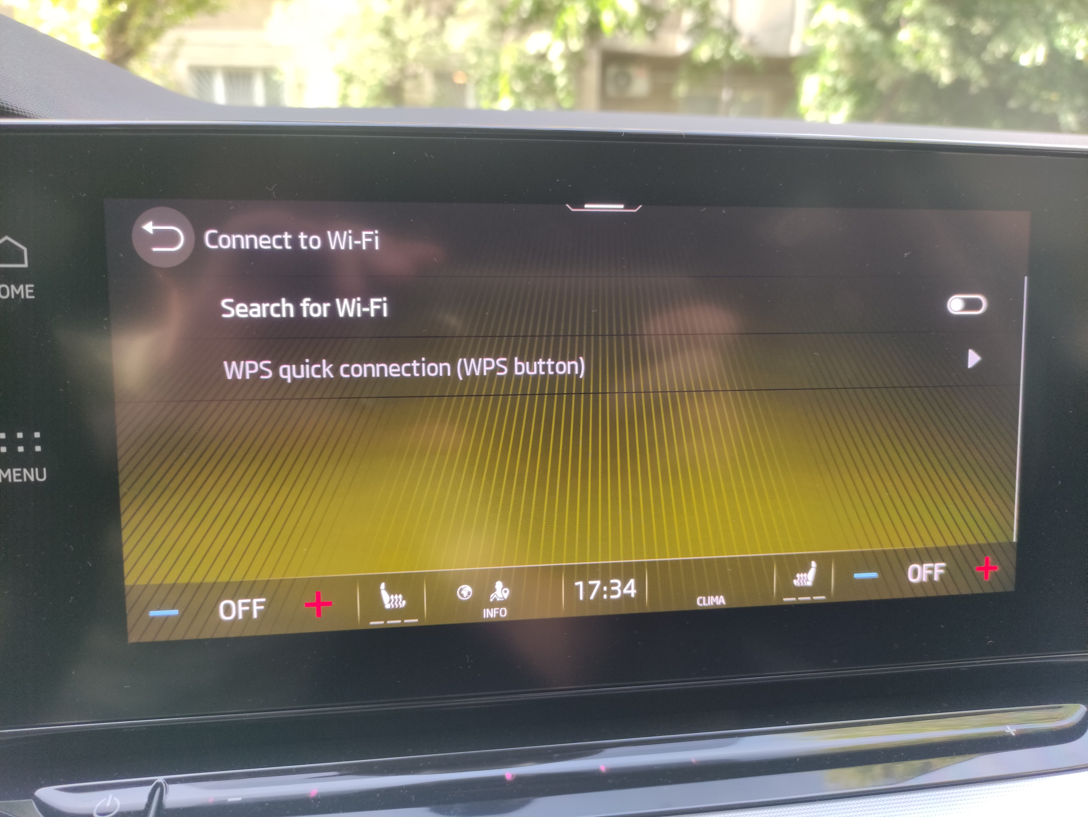

One more request if it's possible to share with us: How have you turned off WiFi on the car side? Using OBD11 dongle OR from the car menu (can you give some instructions for this?)?
Cheers
Latest update: I've just discussed with a guy from my country a couple of hours ago, his infotainment has restarted 4 times in a row, then for the rest of his journey the screen remains completely black 😞
Finger crossed our units will not end up in the same situation!!!.
Edited by djmartzian
Later EDIT on my above post:

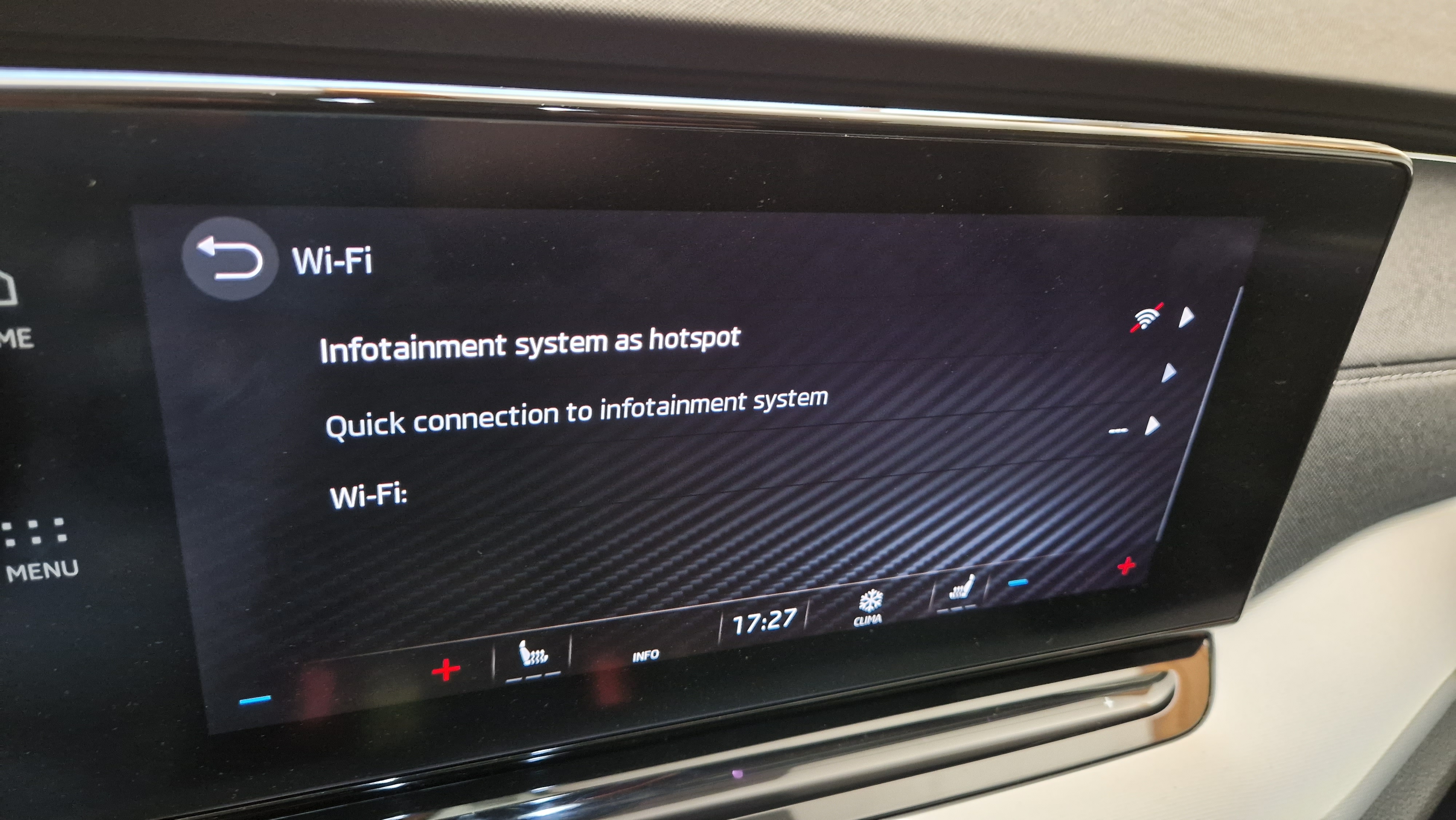

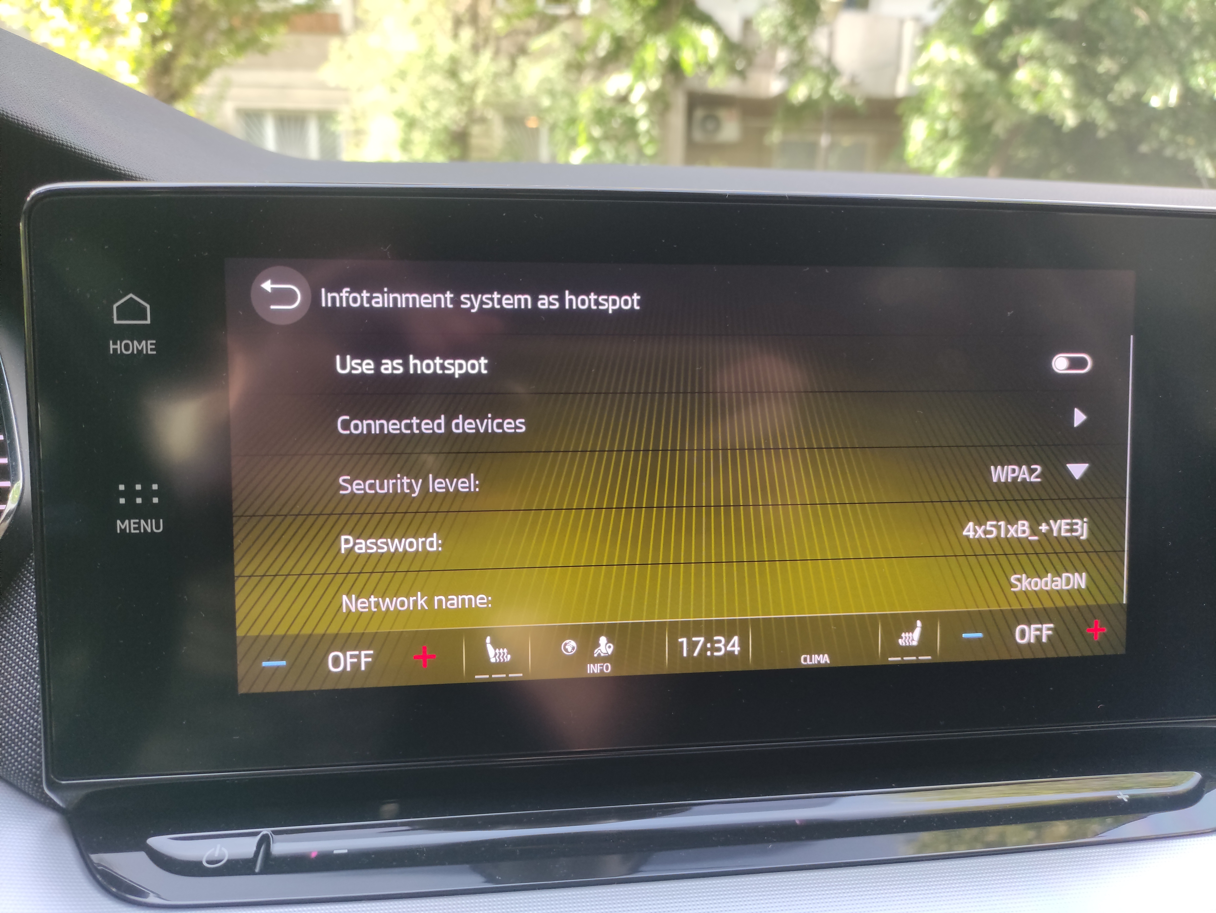

I've just disabled the WiFi on the car Menu. @Combi_NX5, can you please confirm if you toggled off the same settings?Thx

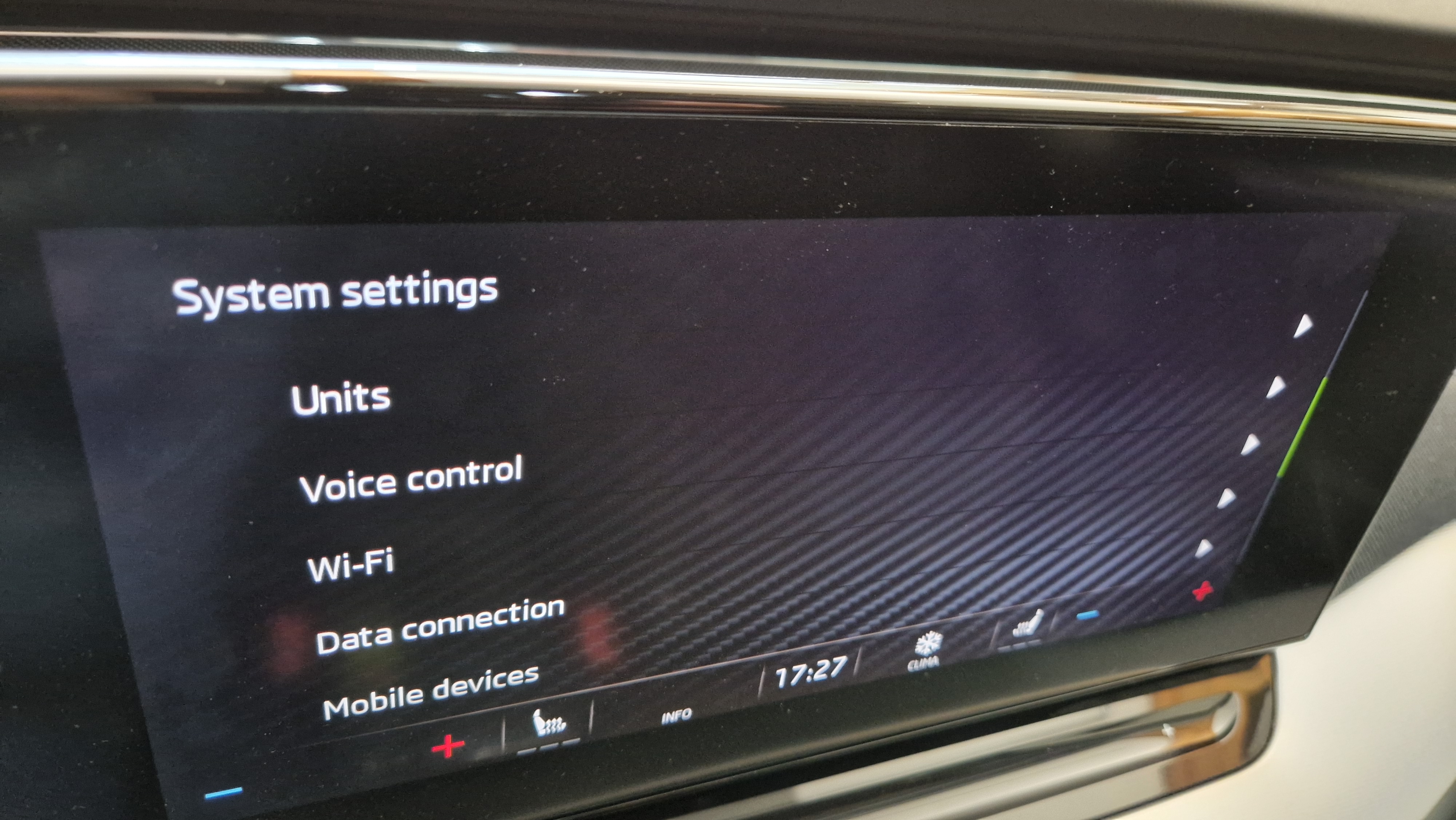

2 hours ago, djmartzian said:
Even there in the system settings
Edited by Combi_NX5

Here’s mine. Also running VW software. I guess it knows it’s in Skoda and only applies Skoda’s skin when it’s running.

I may have solved my reboot problem, not exactly sure how, but having read about WiFi and Bluetooth off here, it is definitely something to do with the WiFi.
My AA stopped coming up on screen last week. And for the life of me I couldn't get it to work. So regular reboots phone and car, I decided to play with the settings.
Turning WiFi (hotspot) off on the car and then complete deletion of Skoda off phone and rebooted Info screen.

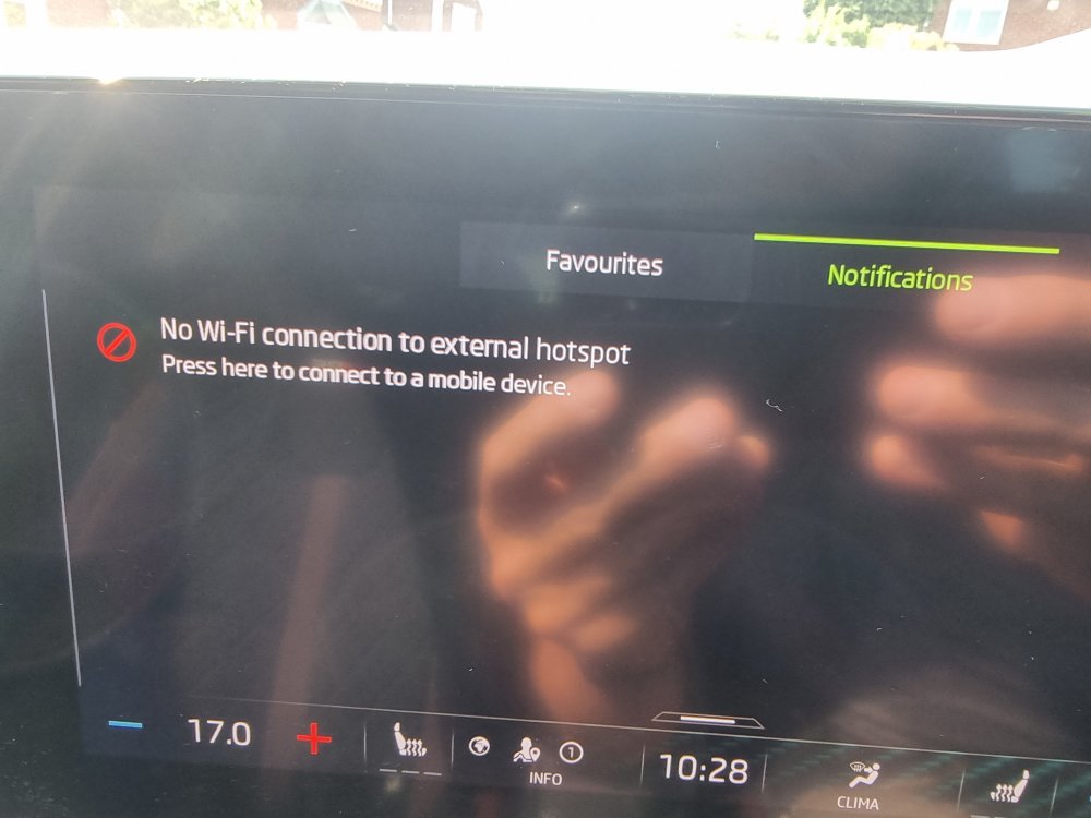

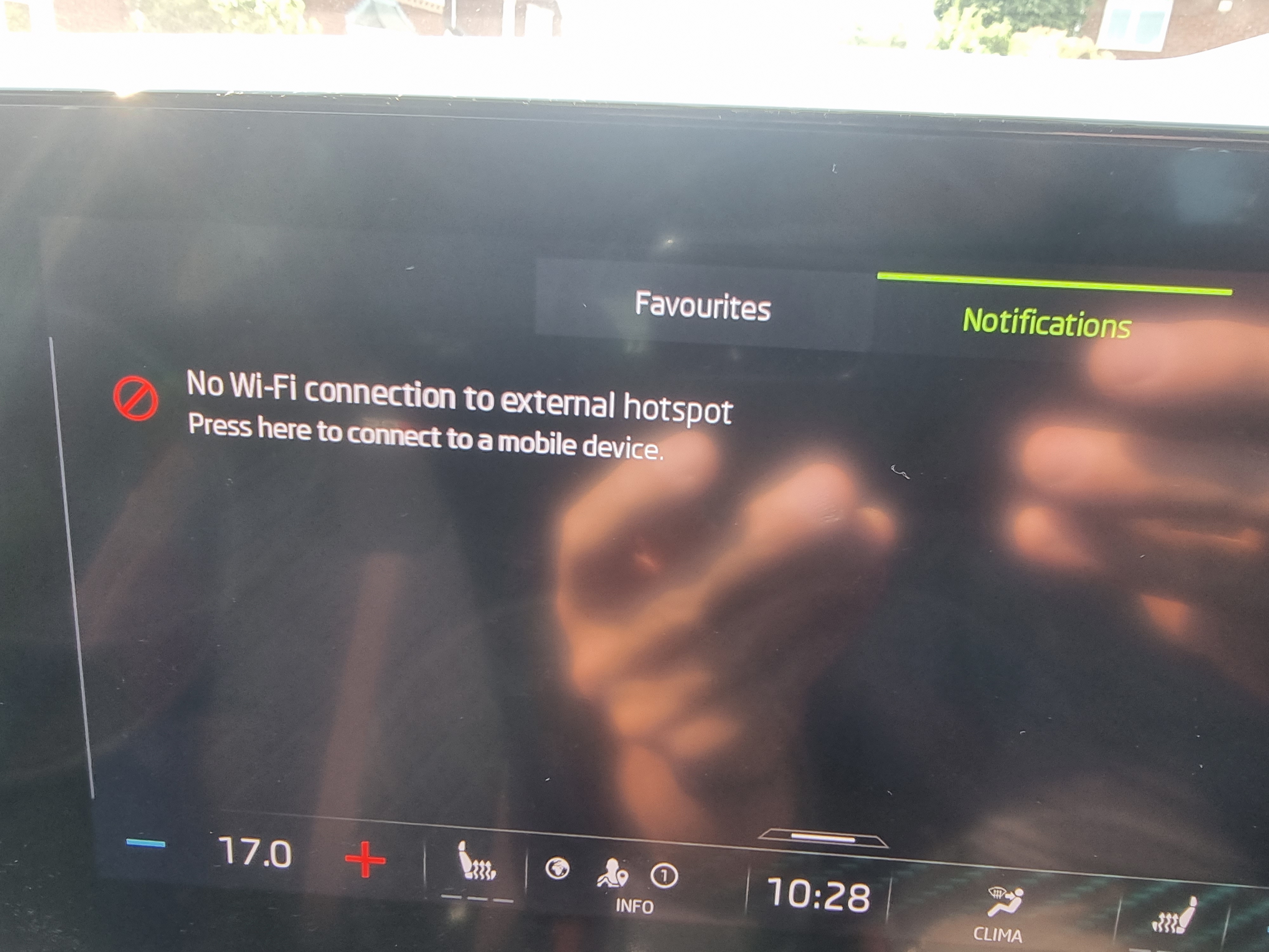

Started all back up and it prompted me for bt/WiFi added both and it asked me to turn car WiFi on, which I duly did. Car worked perfectly and has not reset once in 9 days now.
Problem i now have is I get this message on my screen even after I clear it, it won't go away.
Everything works fine AA Spotify etc.
So not sure if it's another glitch, which I am more than happy to live with. Or a solve/workaround.
