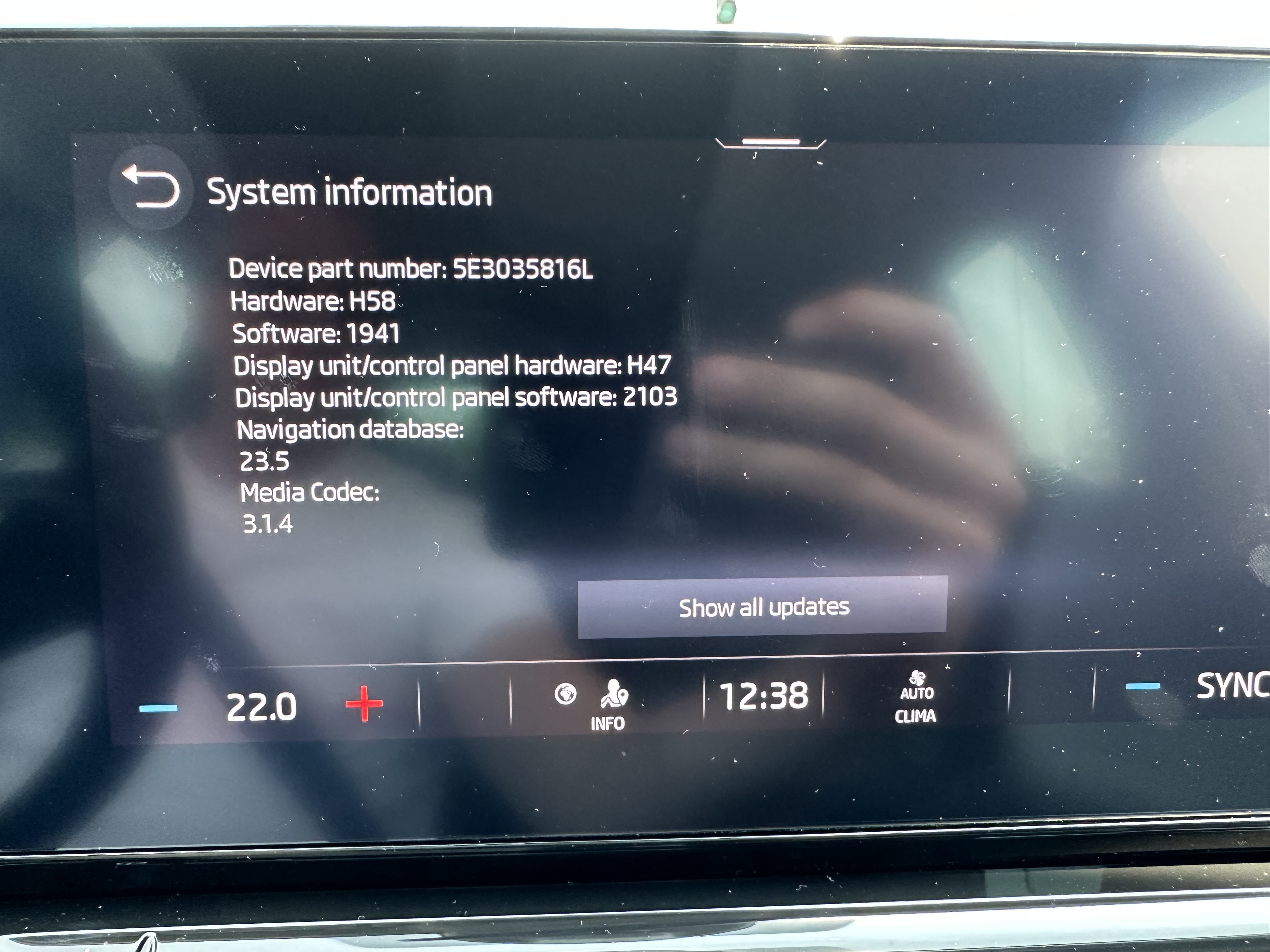

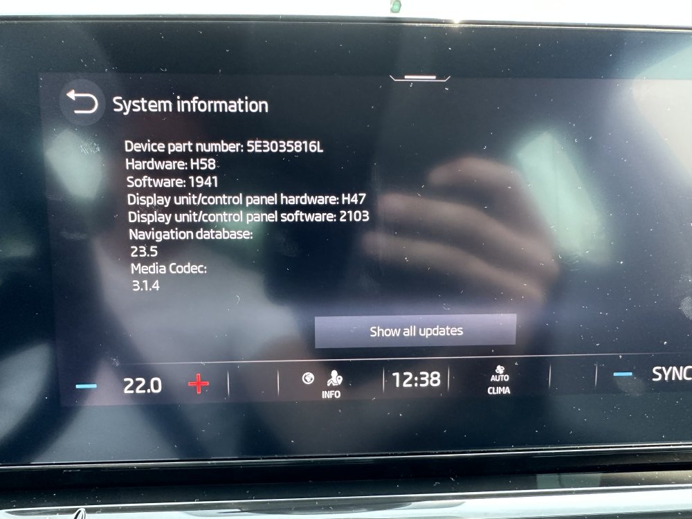

What software version are you on? Did you have a recent infotainment OTA?
Am on 1900 and there was an OTA update the other day for me
Since people were showing their software versions, I checked mine and it is VW as well, surprisingly.

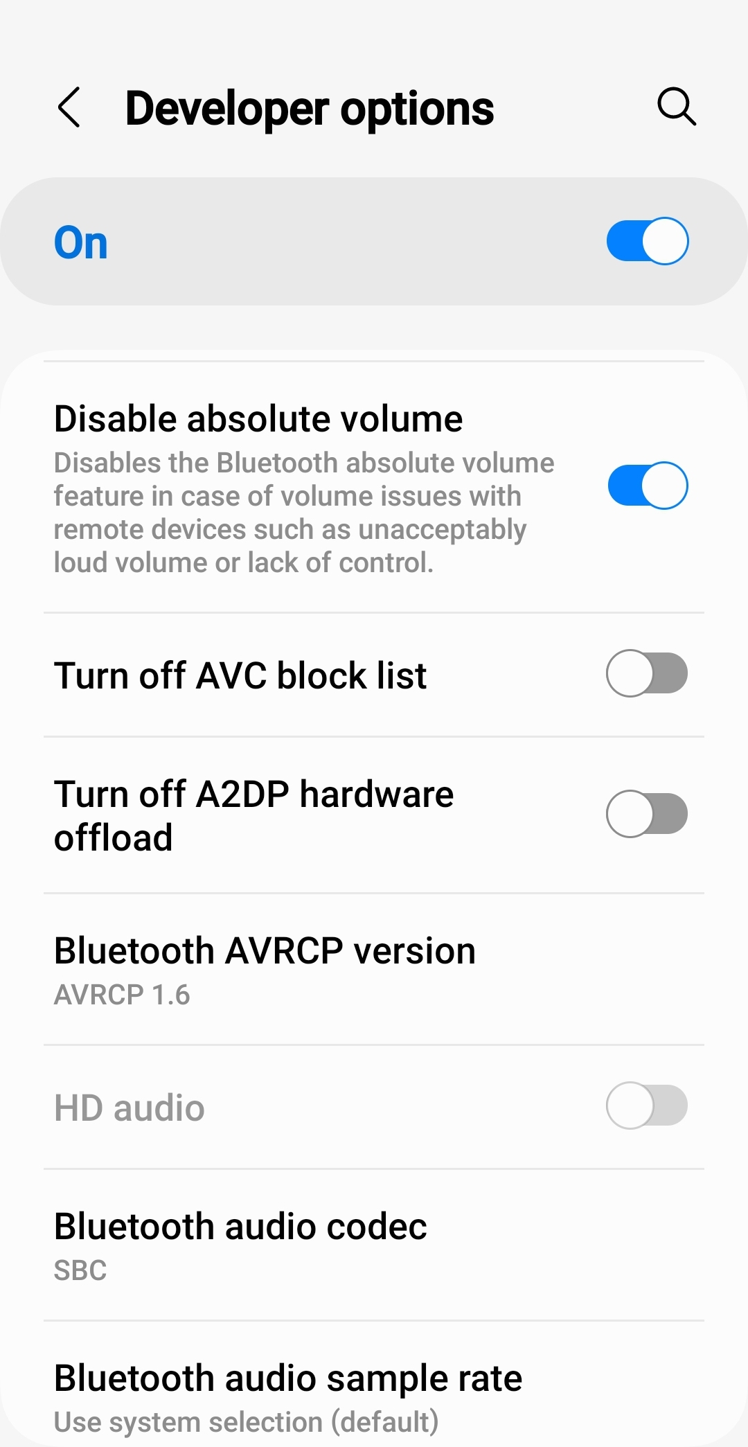

If you have an Android phone you can get it to change the PBAP settings 1.2 & AVRCP to 1.6 in developer mode.
Settings - Software Information - Build Number (tap it approximately 8-10 times) it will release Developer Mode, scroll down through it and you'll find something like Screenshot_20230616_230124_Settings.thumb.jpg.24eb341b83aae11754a04652719abcbf.jpg
BPAP is in one of the other menus.
Ive just done it and I will endeavour to test it tomorrow if possible.

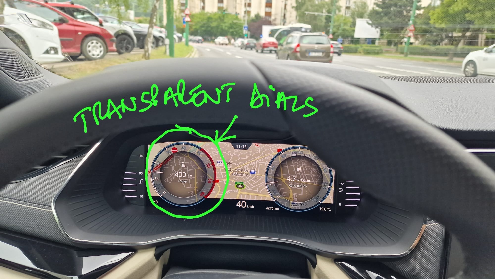

BTW - this bug exposes a great potential feature for the VC depiction - higher dial transparency

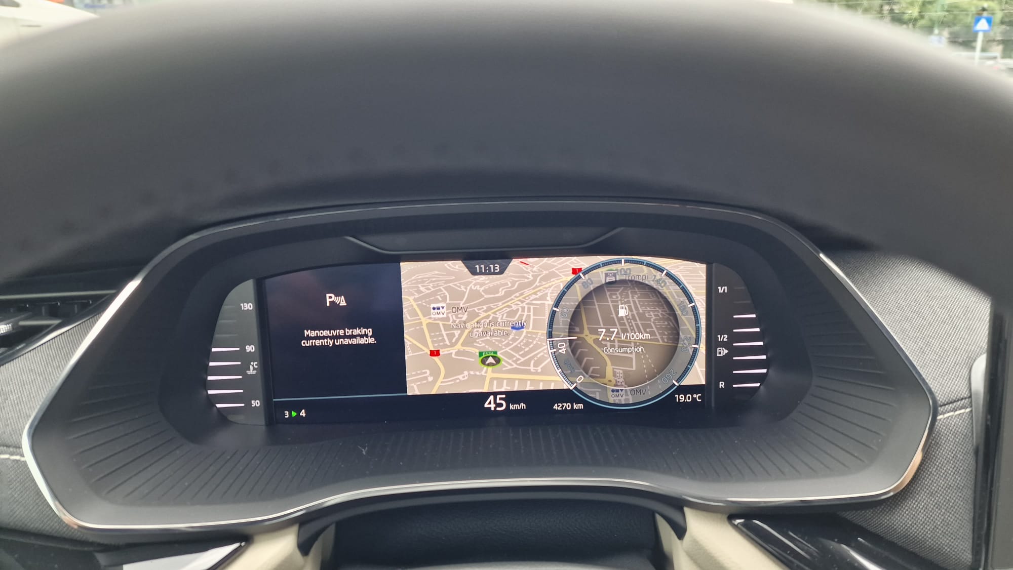

This morning I had Wifi & BT Off on my phone while approaching the car. Started the engine an had an immediate reboot (accompanied by the message: "Maneuvering braking unavailable") 🙄
I moved the car for several meters while infotainment was rebooting (I was still in the underground parking), and it rebooted again several seconds after the first one.
Therefore my first test is over...

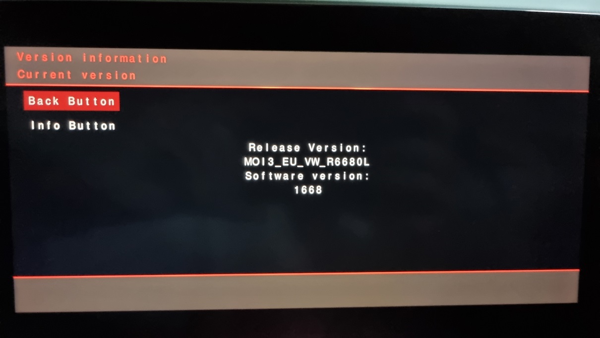

Then hold square home button on infotainment then click top option. Then click start software update on the red and black screen and select usb port 1 or 2 whichever usb is in then click start at bottom and leave it to run through the upgrade progress.
