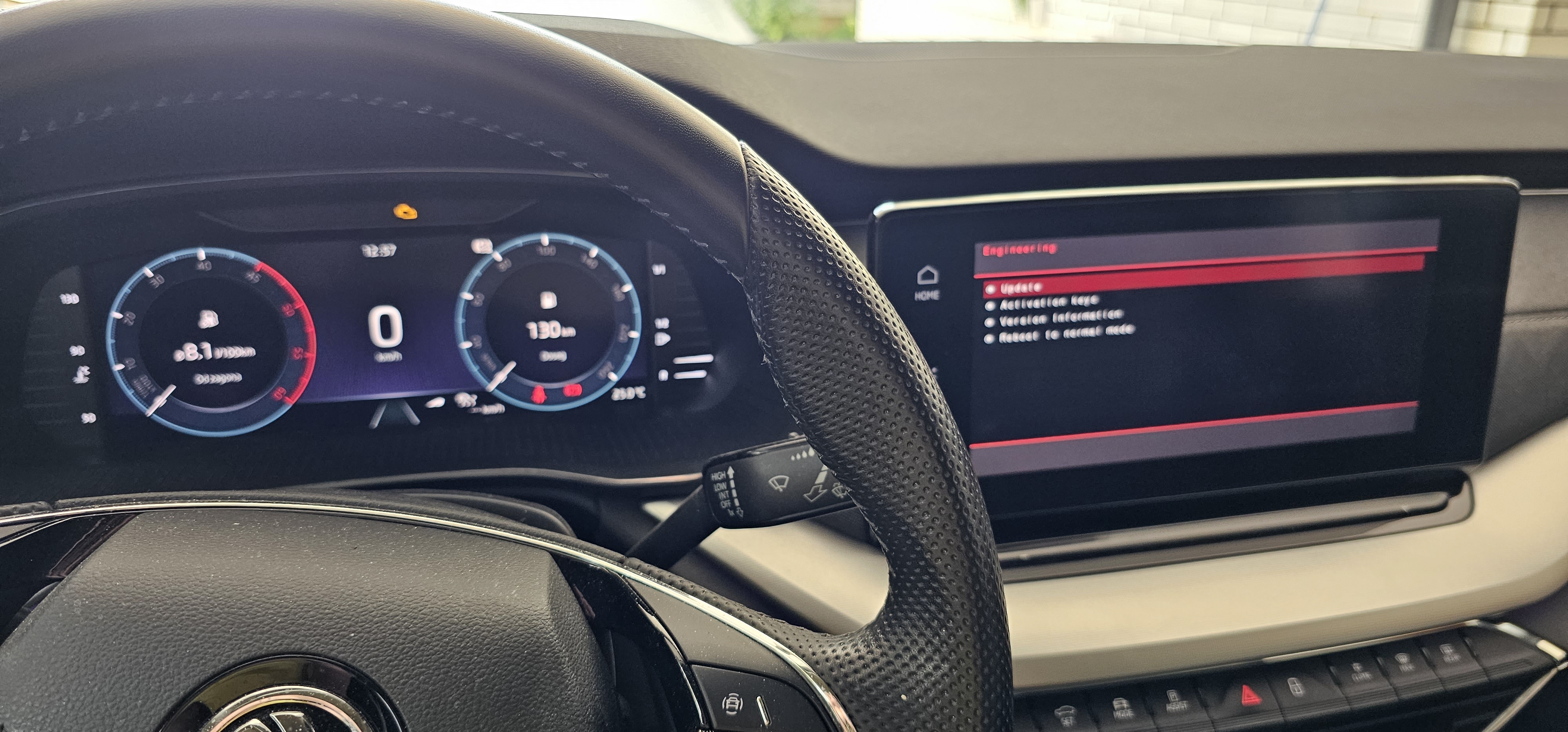

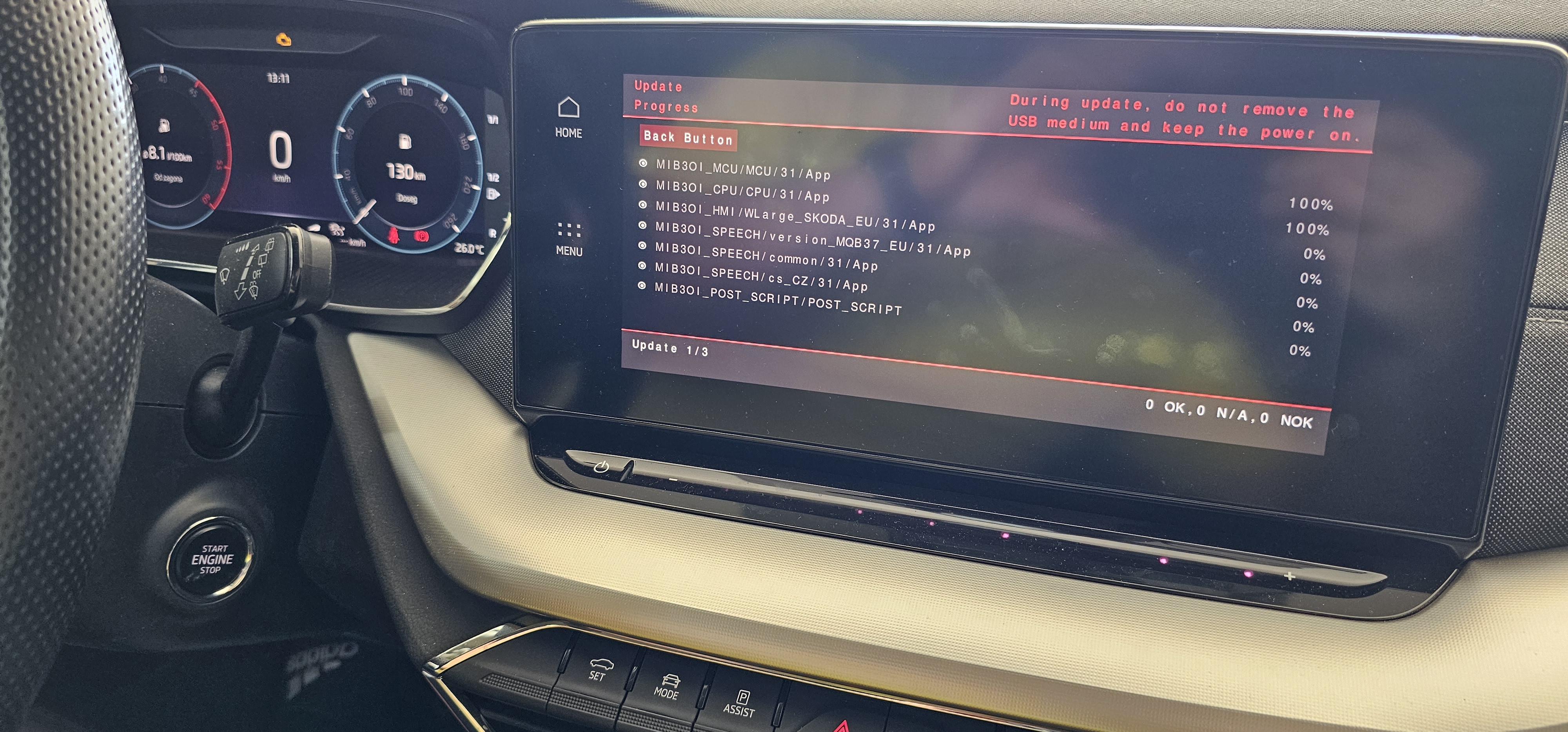

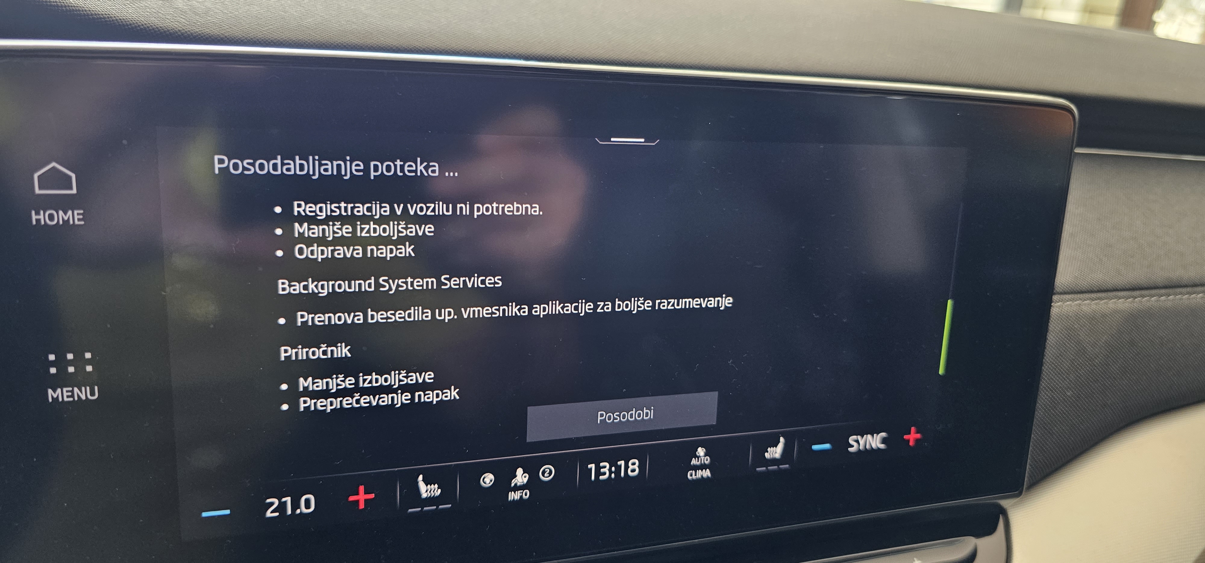

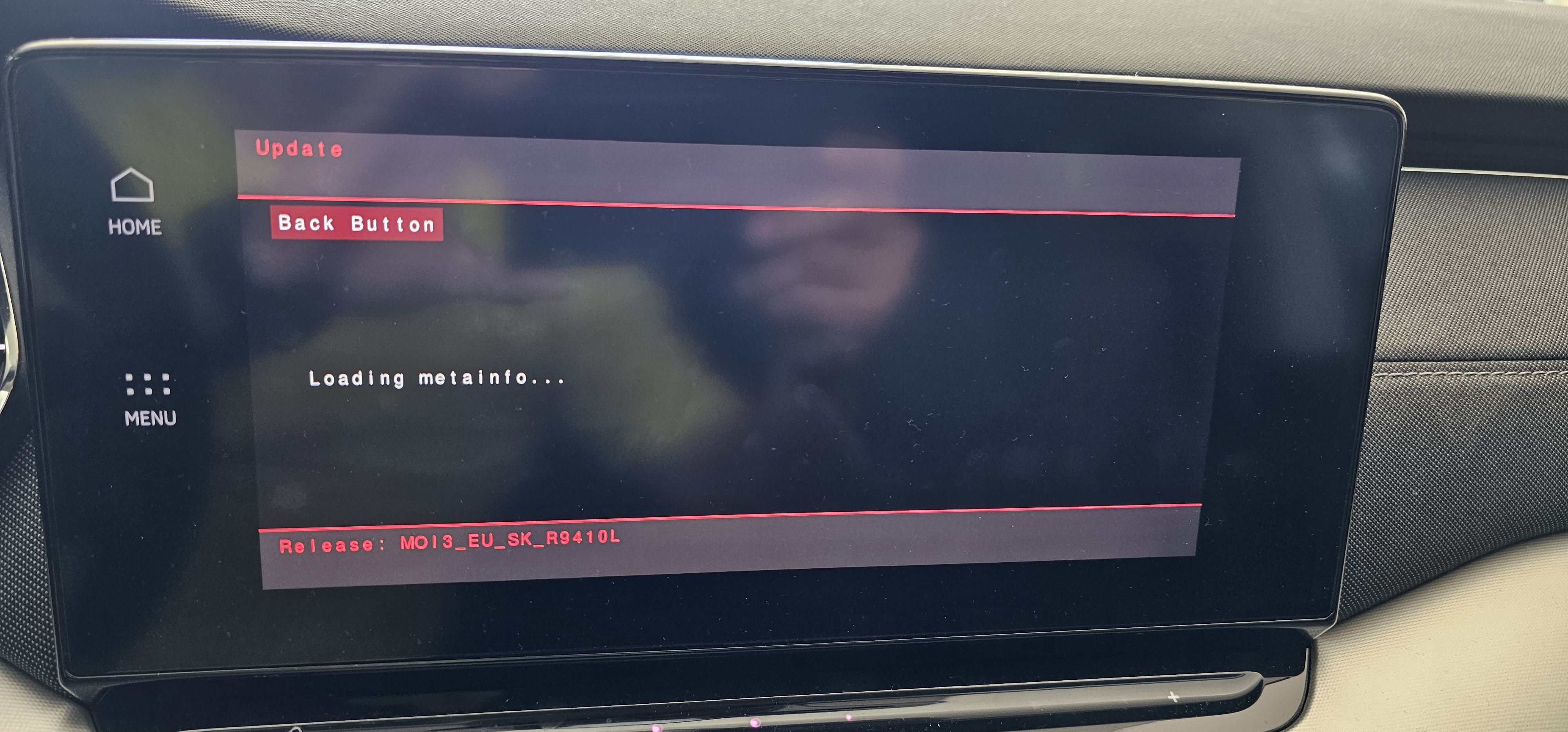

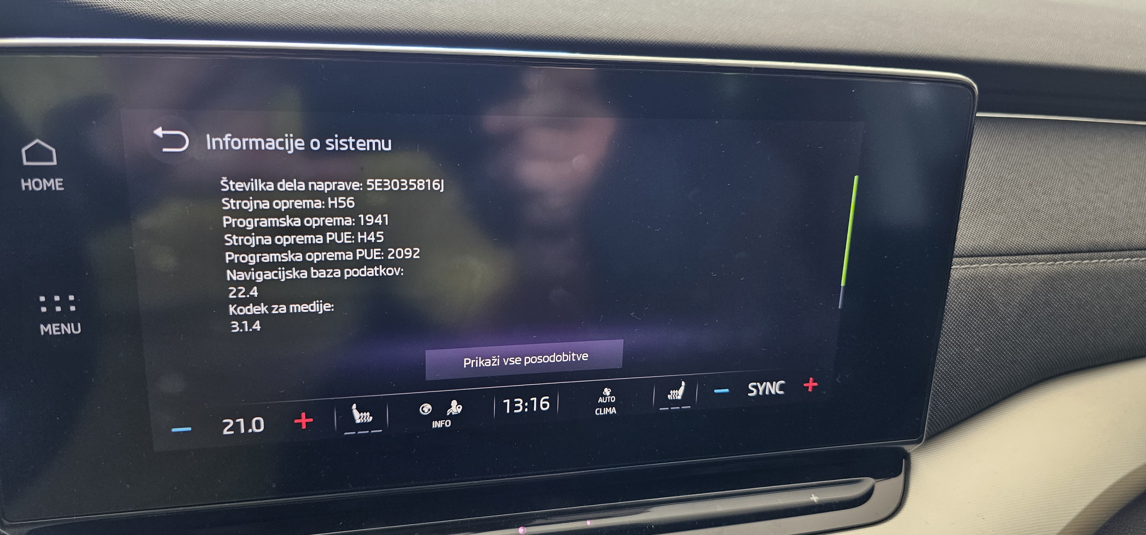

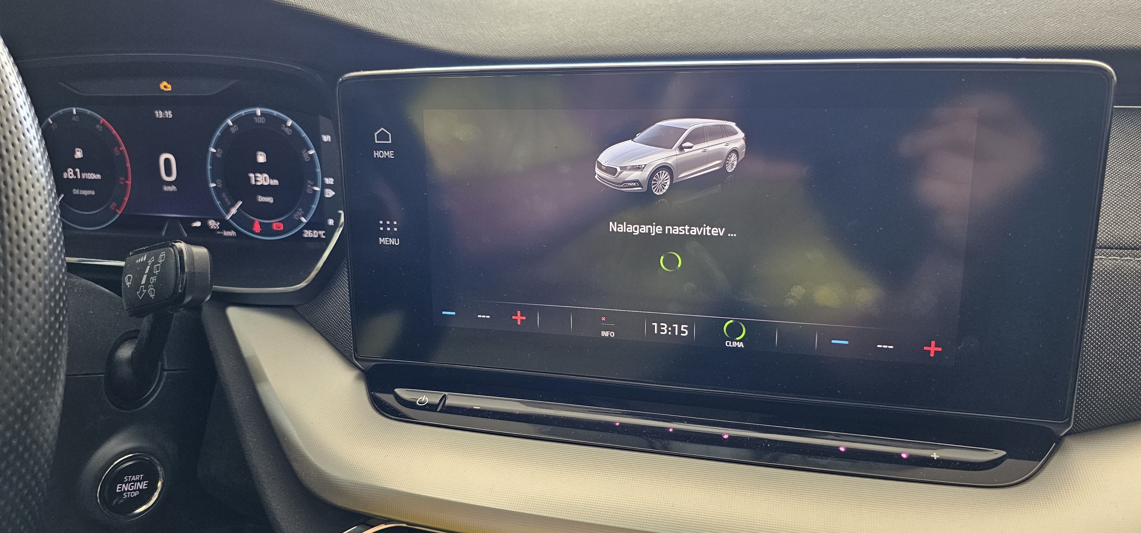

@sdolenec and @Artur111 check your inboxes. All those with the file could also host the download themselves on Google drive or something. The more the merrier
Could you share the link with me as well, please?

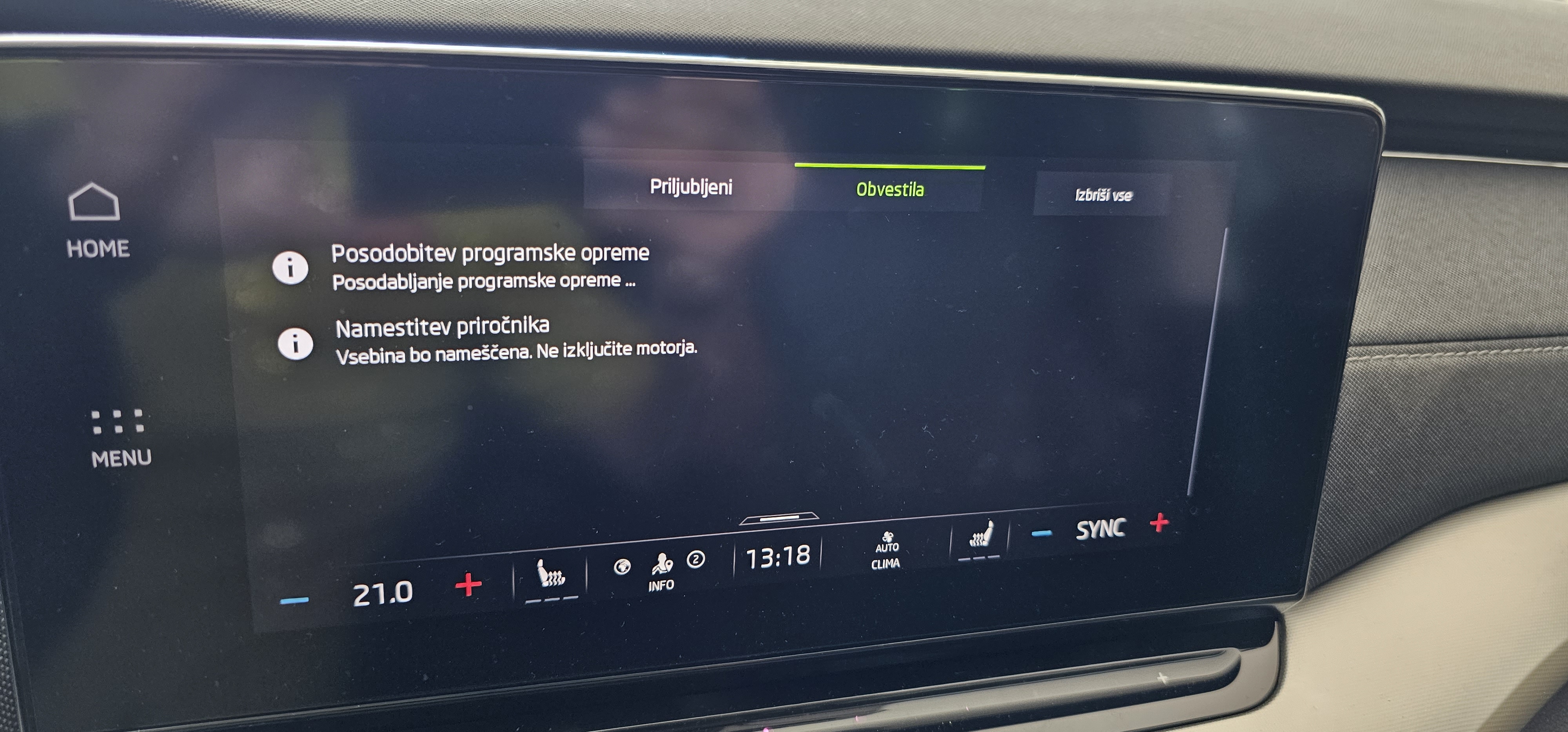

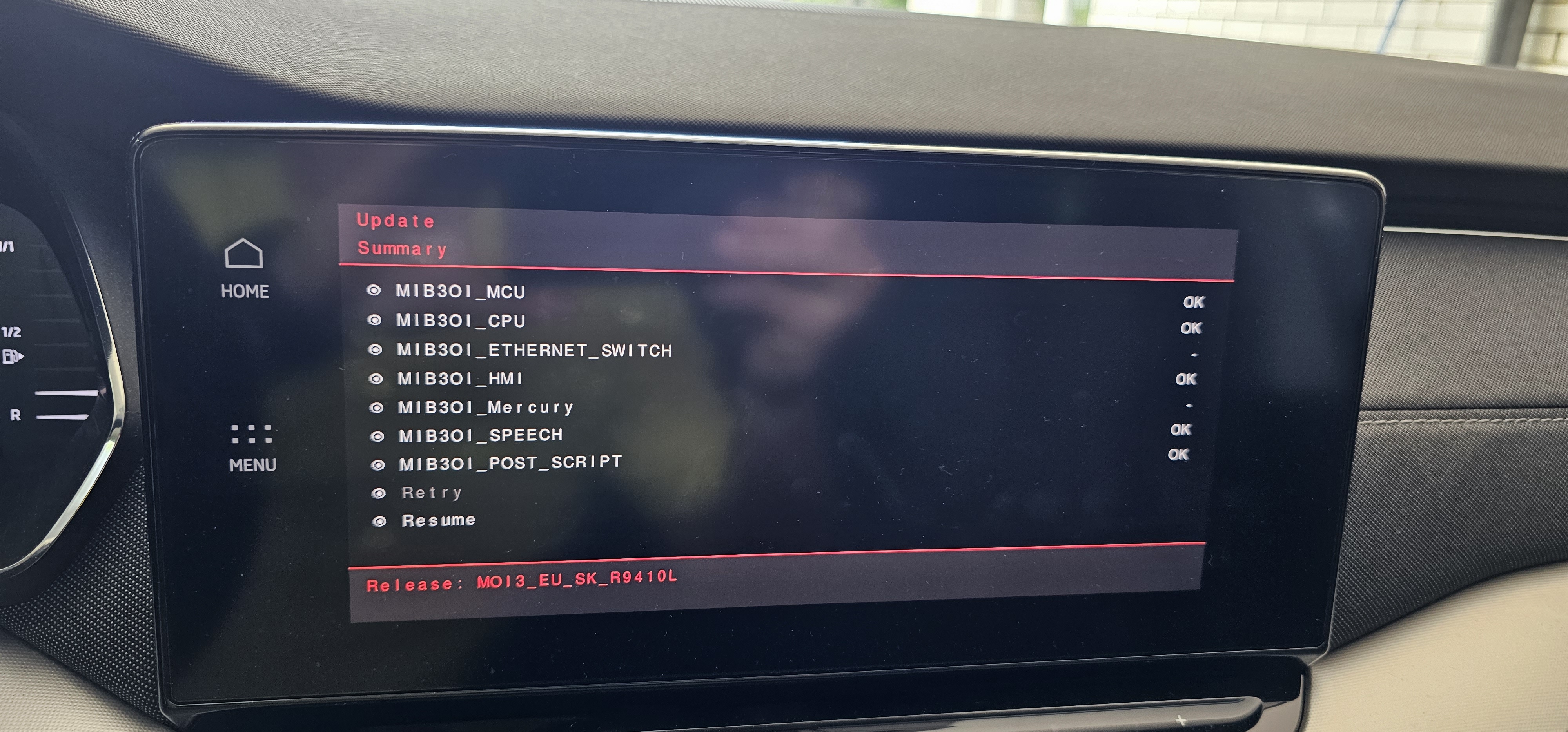

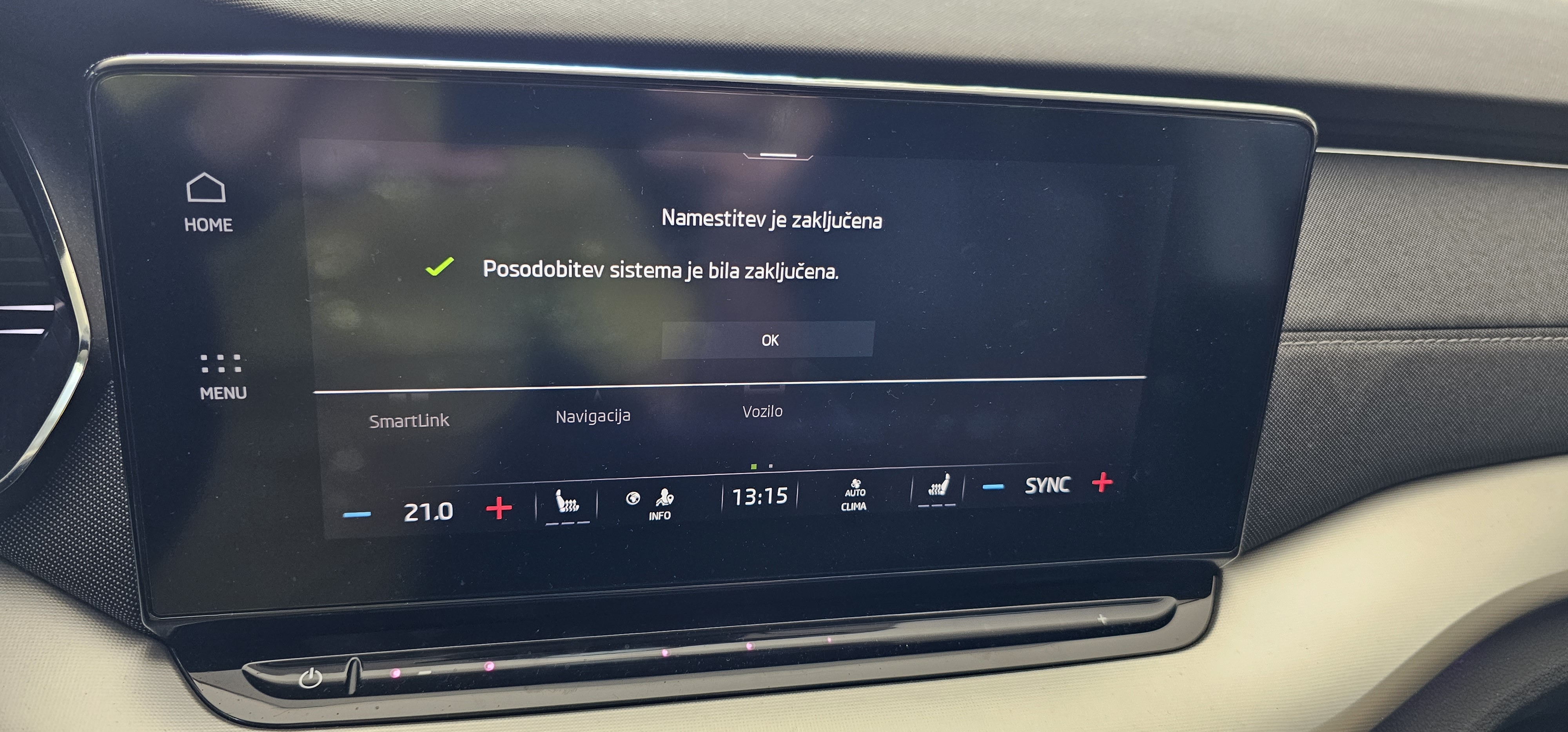

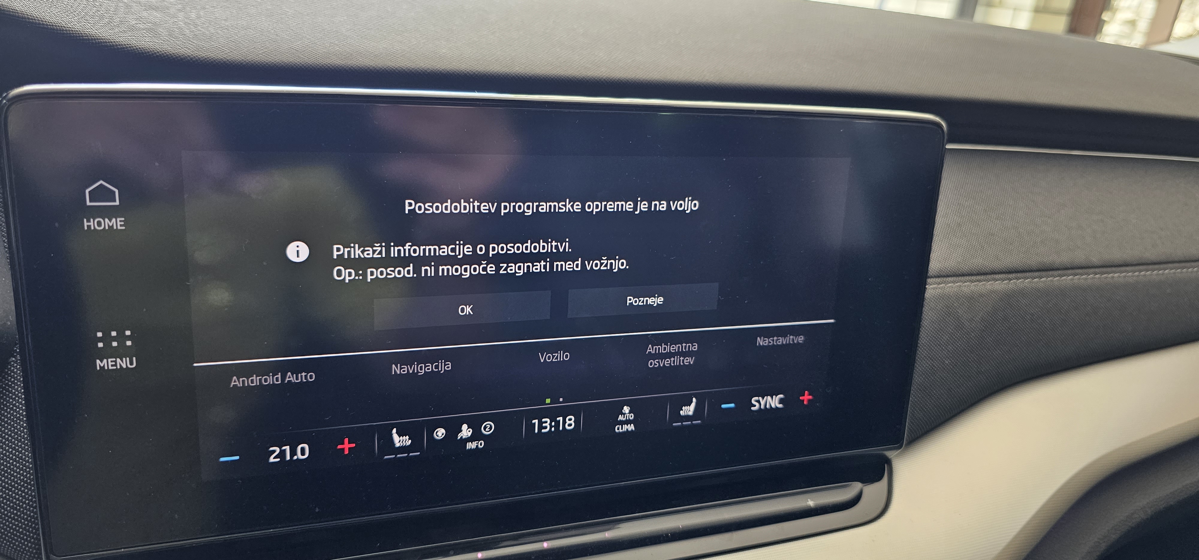

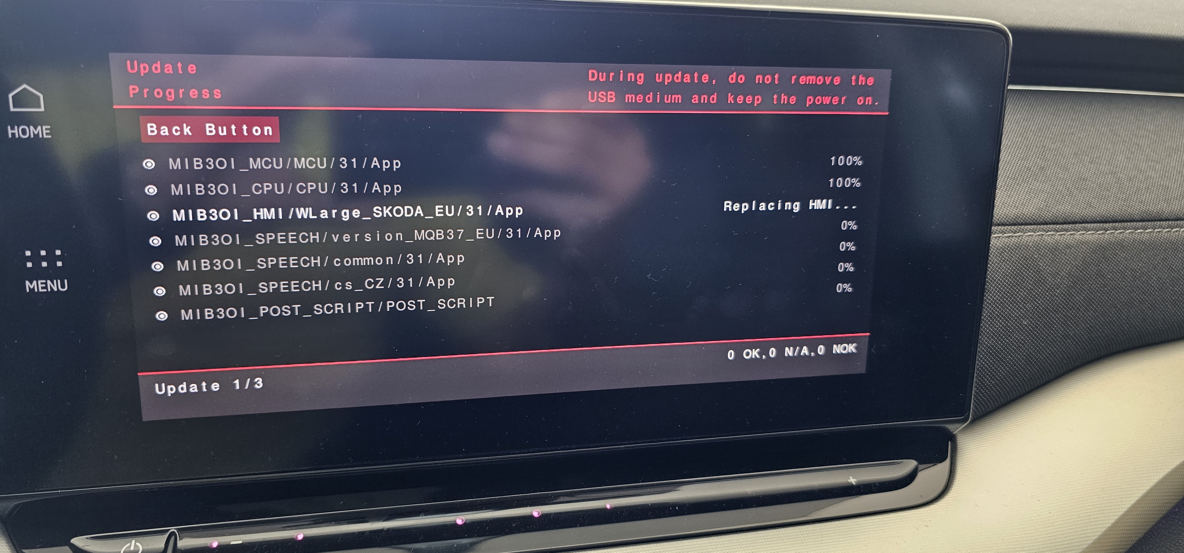

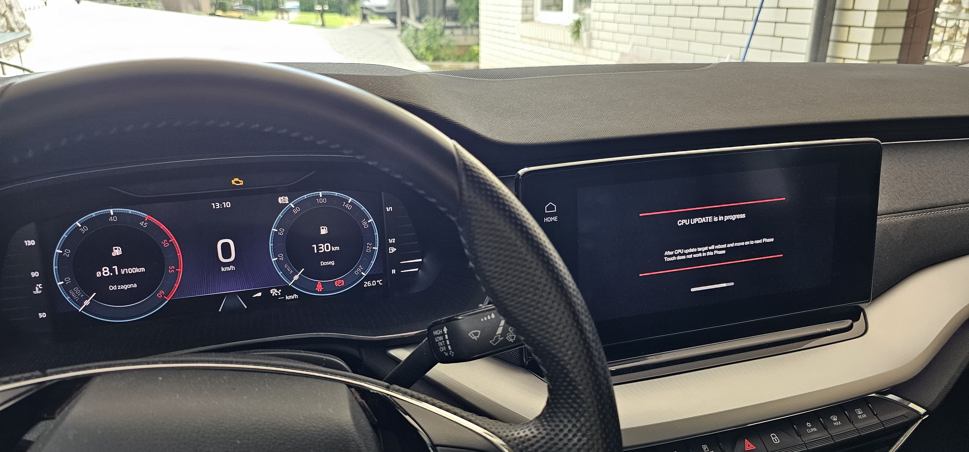

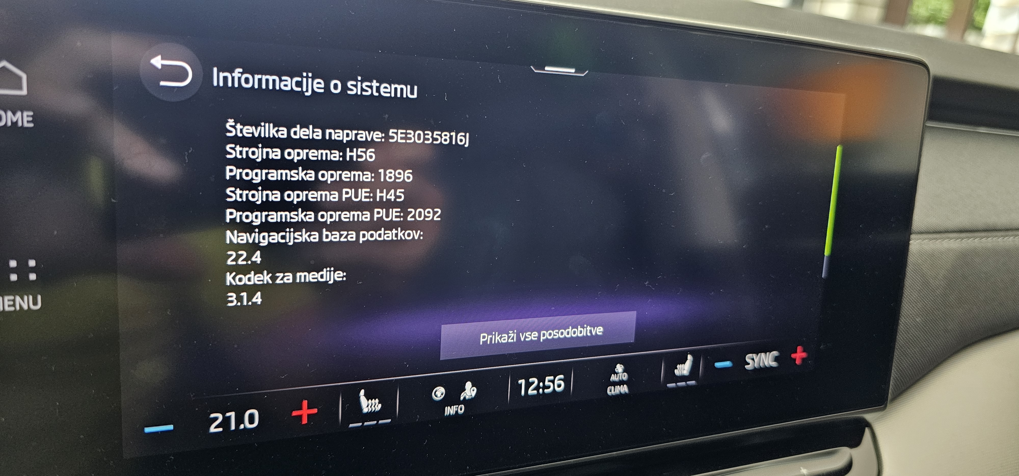

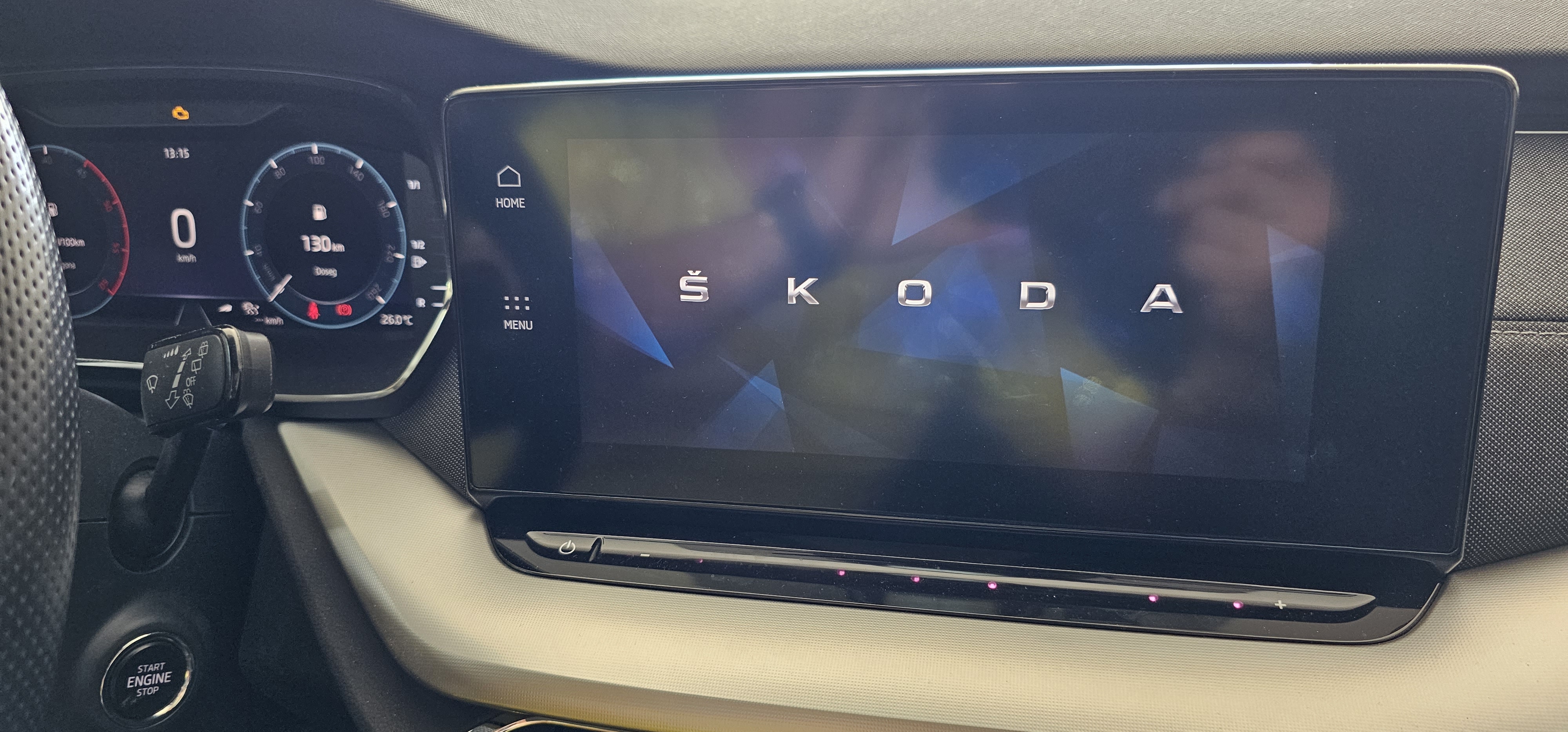

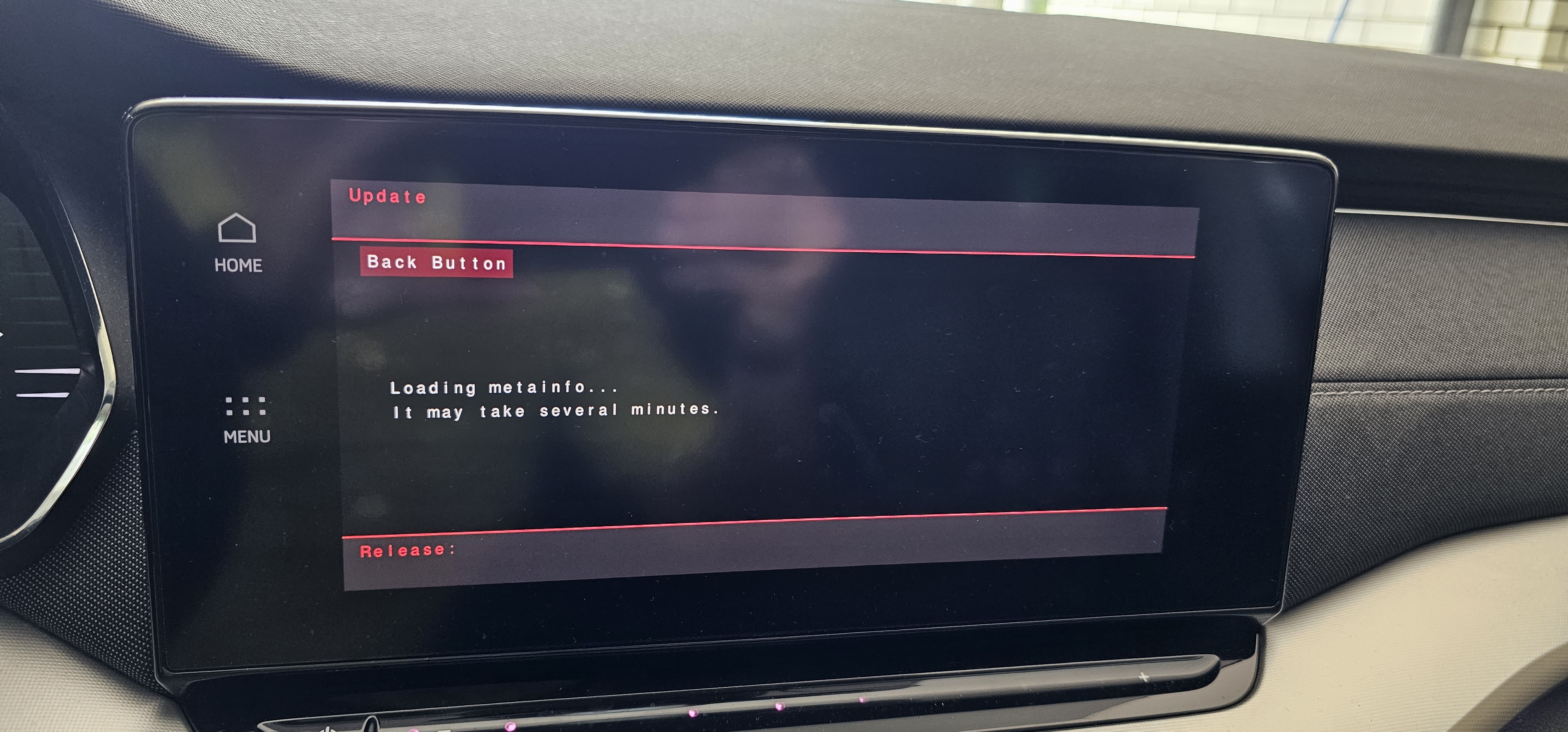

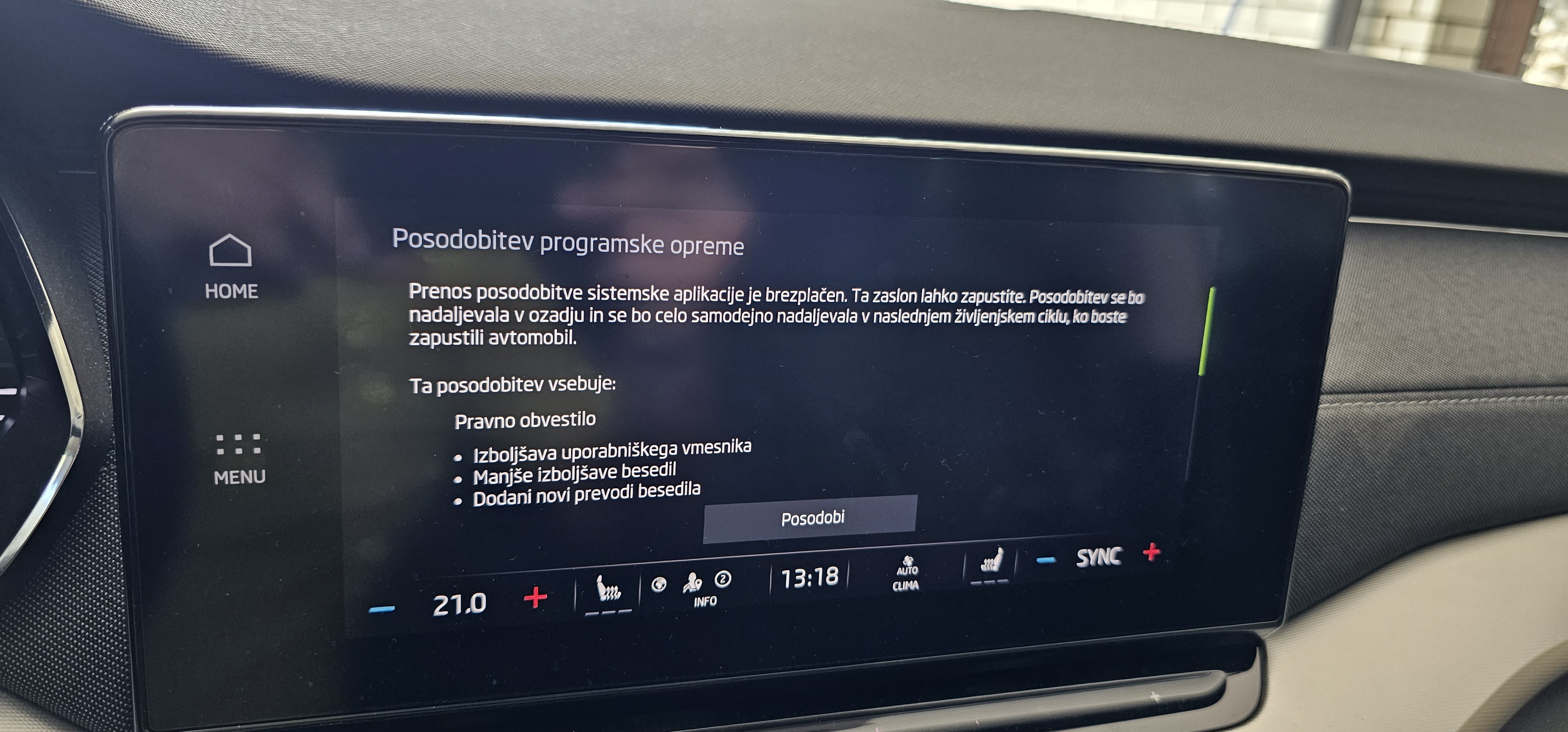

Hi.. thank you for link..
Update was smoth..  all went OK..
Just for others.. maybe before update turn Climate to OFF. For me it started in the middle of update, which can drain Accu. much faster.. but my car survived 👍
Also after update new SW update was instantly found and installed.
Some pictures..
Edited by sdolenec
And another pictures..
Overal now infortaiment is much much faster than on 1896, no restart for now 🤞 and all custom MOD settings stayed untoched (video on move, VR screen, etc)..
