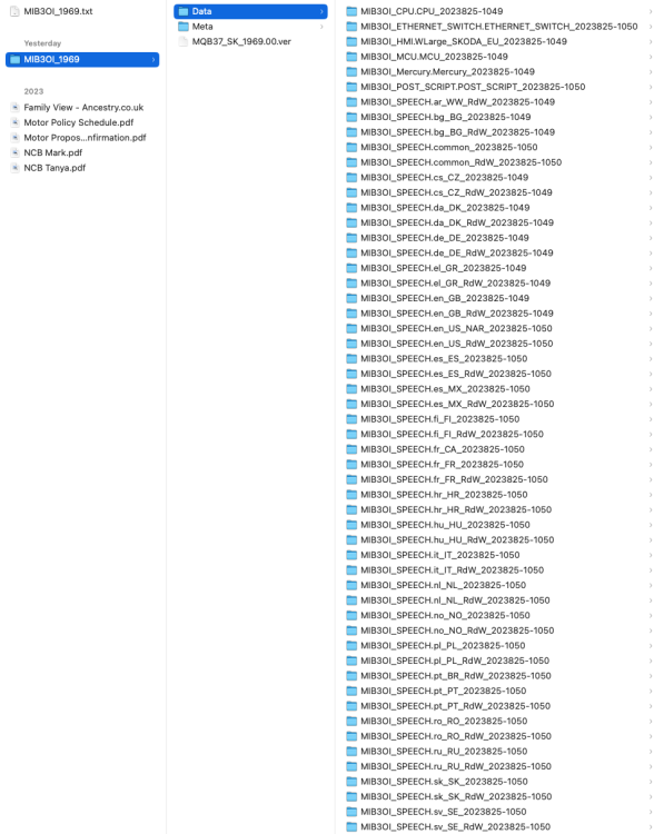

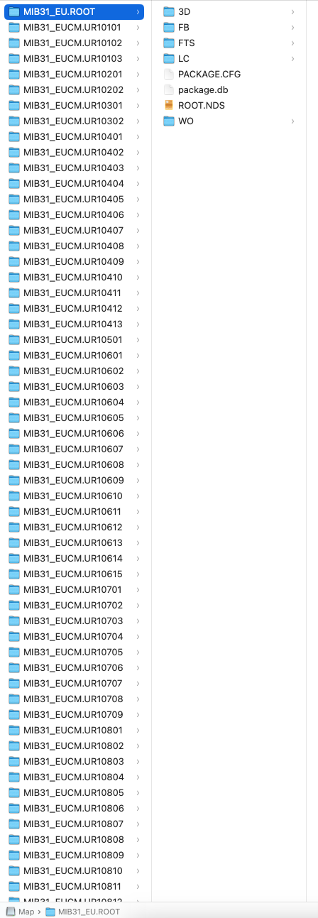

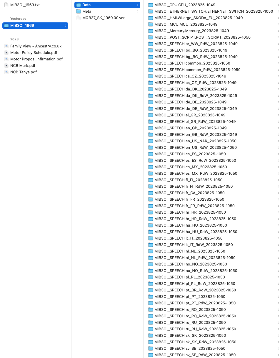

I must say I'm confused. Having eventually downloaded from Mega, the unpacked file structure is unrecognisable from 1941. So I'm holding off for now. I tend to agree with those opinions "if it ain't broken", but at the same time intrigued by @sdolenec saying how brilliant it is...
The first 2 screenshots show 1969 in only 2 folders called data and meta with subfolders labelled MIB30I bearing no resemblance to the third which is 1941 with multiple folders labelled MIB31. 1941 has been shared widely and installed without issue. Odd. Those more tech savvy than me might explain??

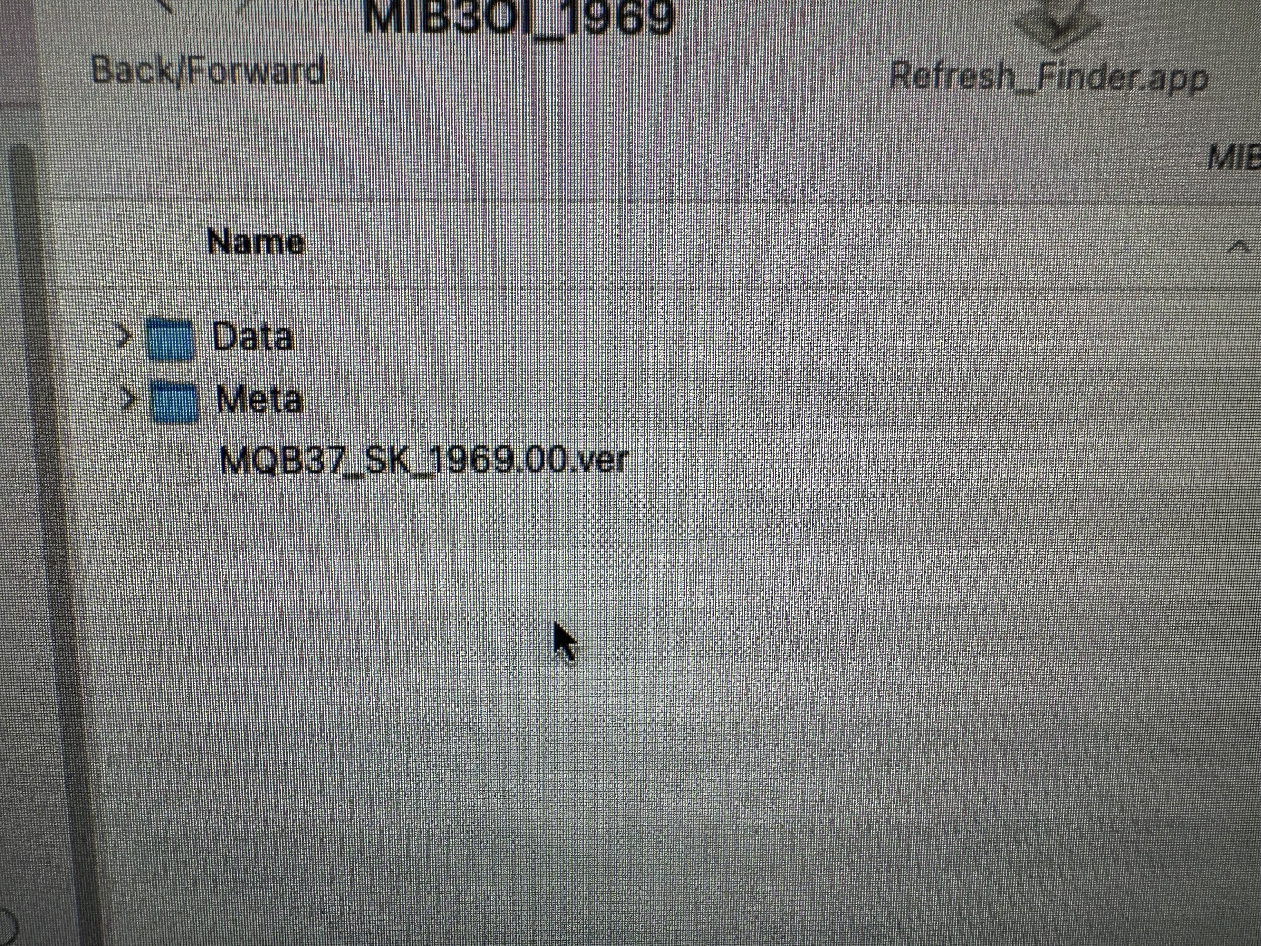

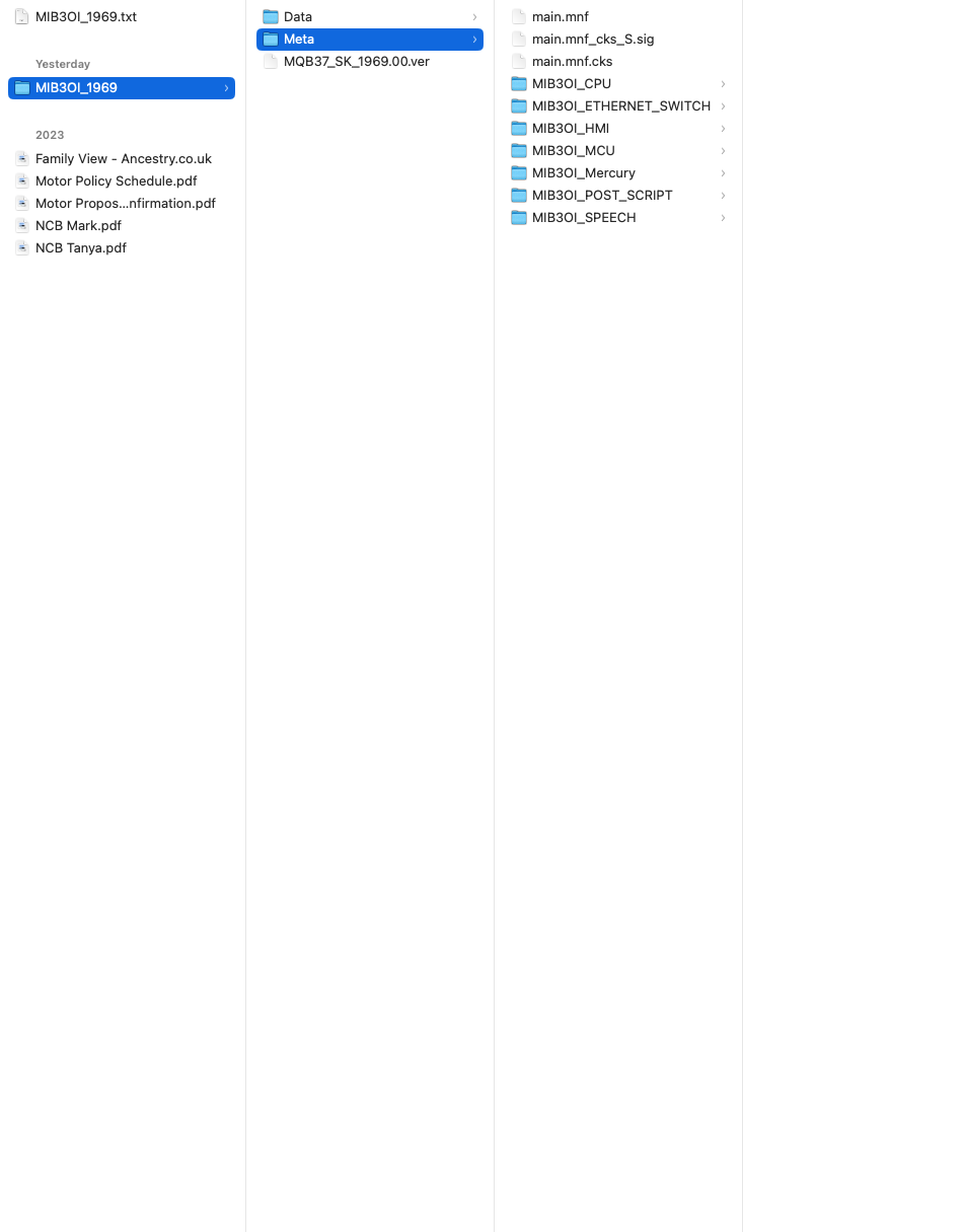

Possibly something has gone wrong at the unpacking stage?  When I unpacked I got the two folders and the install file.
Try 7Zip - it’s free and my goto un-archiver program.
Edited by spcdust

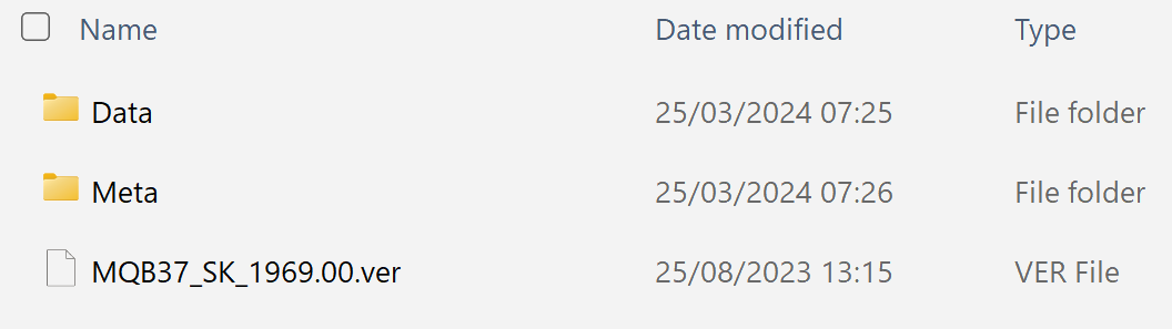

As above - 1 file, 2 folders using 7ZIP
I get exactly this, only the contents of those folders are completely different to 1941's so it's that that is troubling me. Ethernet switches and mercury. What's that all about?
You better do not use macOS for this as it creates all kinds of hidden files.. better use a windows pc..
also people who use MacOS for map updates struggle with the way apple creates all kinds of hidden files and then the map update fails because of that..
I use allways winrar to exttract. If you open the file with winzip; do you see all contents? And how large is the file. Should be 9GB+
Edited by Faab
Might be, that they changed the format. Anyway i did the upgrade and it's legit.
Ethernet switch and Marcury - don't know, but they are not updated during the process.

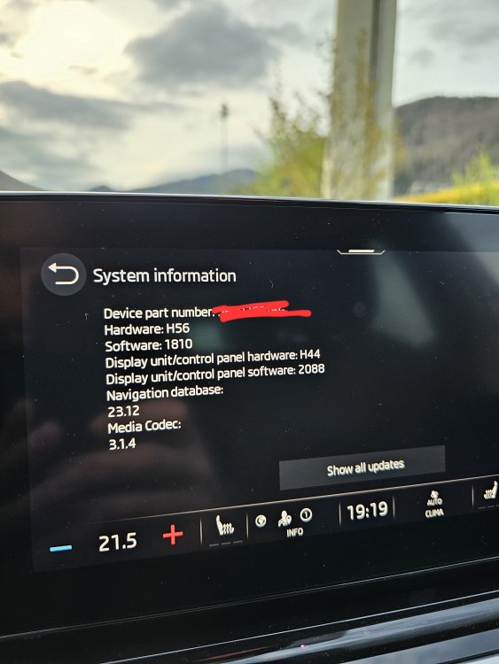

Hello everyone,
I have an issue and I think it is related to this topic. Yesterday when I went home when the car on sun after some minutes of driving I got problems with informainment unit. It start randomly clikcing "clicking sound" something and restarting all the time. After restating my car everything was fine. Today after everything is working I got same issue again and car was not on sun at the time it was in garage on cold. I try to restart it with 10second power button any it the same. Even if car is closed unit is still turning on/off all the time after few restarts. Any ideas?
I seen there is some users are from Slovenia if someone knows please contact me.

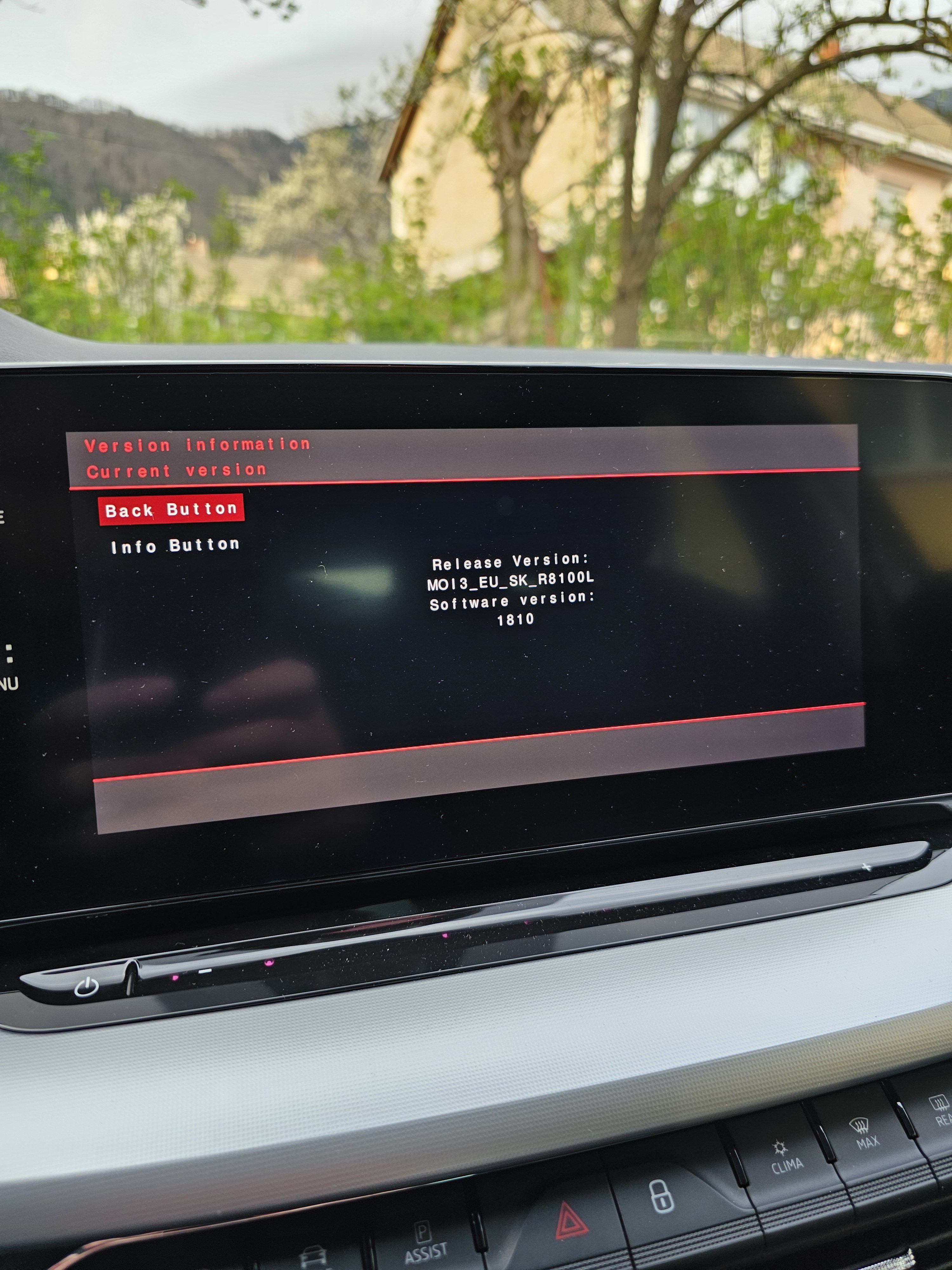

Quick update. I try to restart it again, even turn off wifi and bluetooth because I seen something about if I go few pages back. It restart again and then worked normally and I even enter engineering mode and found out which version I have. I went driving around it worked, I stoped and turn on wifi and bluetooth for Android auto and it was fine for few minutes and I had same issue. Again turning off and was working without any problems until I turned on everything.
Looking forward to find an solution.

Hi,
What is your version of infotainment? I had same problems on version before 1941. I had update in skoda service in Ljubljana (PIA)
29 minutes ago, vran22 said:
Hi,
Hey,
Which version do you have?
2 minutes ago, PrimozAmbrozic said:
Hey,
I have version 1941. Before that i was having 1869 if i am correct.
My problems was:
- navigation sometimes showing wrong location
- restarting issues
- car was locked and infotainment was on
- radio station favorites keep mixing logos
My problems was:
- restarting issues
So I am on really old version. There was no major problems till now. Once I had problems with connection (globe) but that problem was solved. Sometimes navigation is showing me wrong location aswell (some old) where I was before... and same problem like you when infotainment was on (restarting) when car is locked. It turned off wifi and bluetooth now and after two short trips it was working normal.
