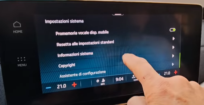

Is this one? "Resetta alle impostazioni standard"
I know it's in Italian but the same position should be in the English menu.
Thank you
If it translates into Restore factory defaults or similar then yes.

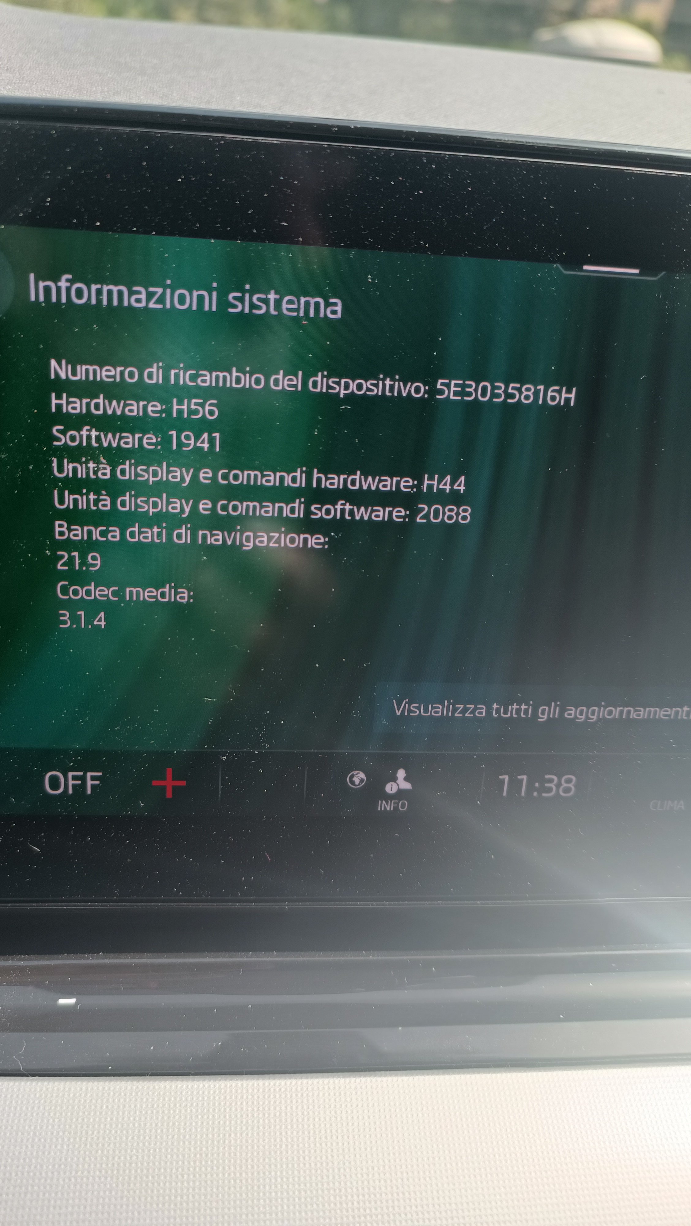

Another interesting point of analysis could be the Display hardware/software unit number: mine is H44/2088 and I found people on an Italian telegram channel who solved their problem once substituted with higher number units, but don't know if could be considered right.
